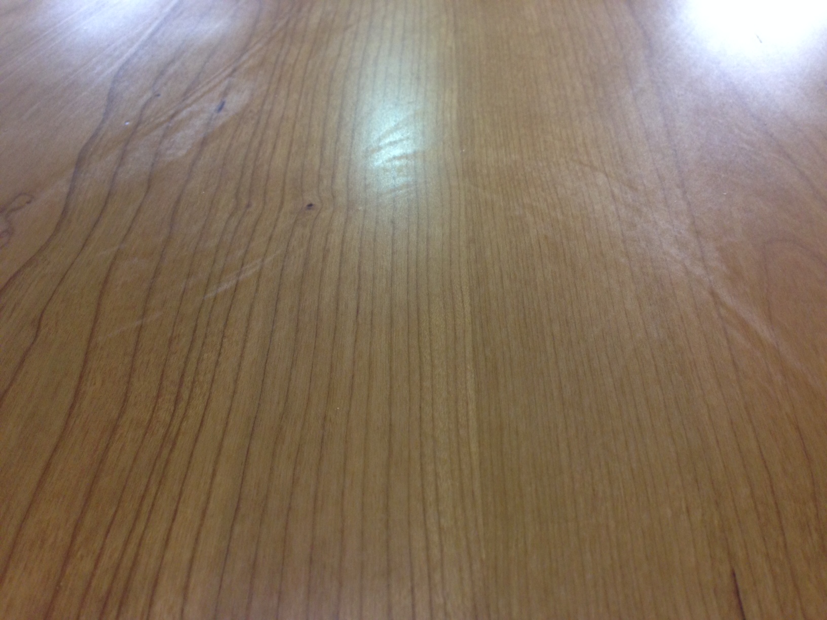

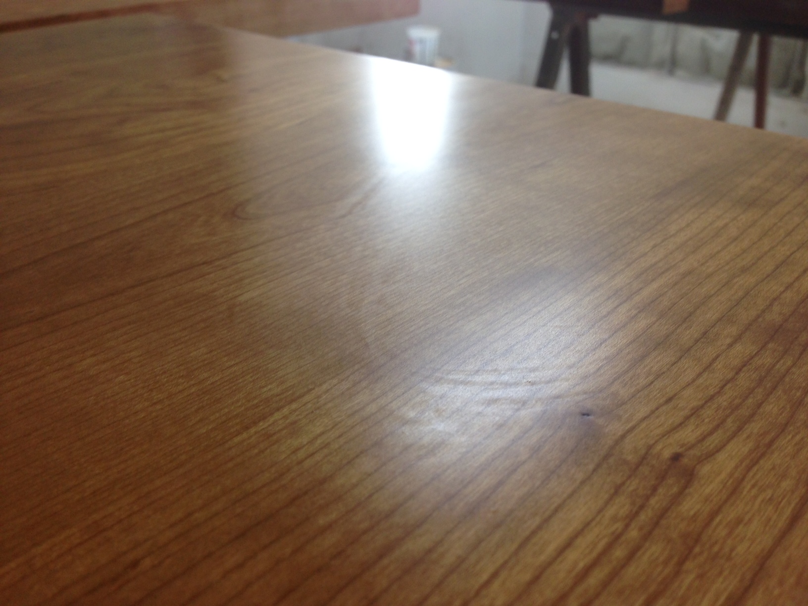

I am having problems with my topcoat of waterlox satin. I am spraying with my kremlin AAA. I sanded the previous coat, blew off dust, then wiped with mineral spirits, as per waterlox's directions. After wiping down, there was a residue of mineral spirits left on the surface. I sprayed anyway, and got some sort of crawling effect, you can see all the places that were wiped with the rag. To further complicate things, this has happened when cleaning with naptha, mineral spirits, and tack rags. I am baffled. I don't use waterlox. All the above methods were deemed safe by waterlox tech support. They were stumped as well. Any help would be appreciated.

According to Waterlox webesite, this may be the problem that you are having:
Follow the link
Sanding and Burnishing are typically not needed on oil finishes....just need to build up with multiple coats for a complete finish.

I'm not sure why you would be spraying it on. I suspect you are laying on too much material. It takes a long time for it to dry sufficiently for recoat,even longer to fully cure. Sanding should not be a problem. You might try leaving it to dry for several days or more and then level it. Some apply a wet coat and then wipe off the excess which is probably what you should do if you are set on spraying. I have good luck padding on a very light coat much as you would apply shellac and then leaving it overnight before recoating. In short I don't think the product is the problem.
