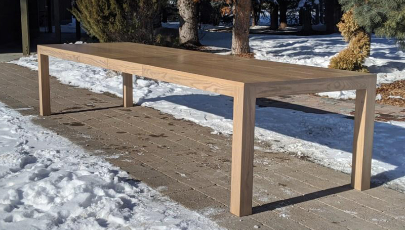

duster
Here's the finished table, shown with the leaves in. It's 8' long without the leaves, 12' with. I used steel Watertown extension slides, 6' long closed and 10' long open. Strongest and smoothest slides I've ever used.
View higher quality, full size image (800 X 455)
