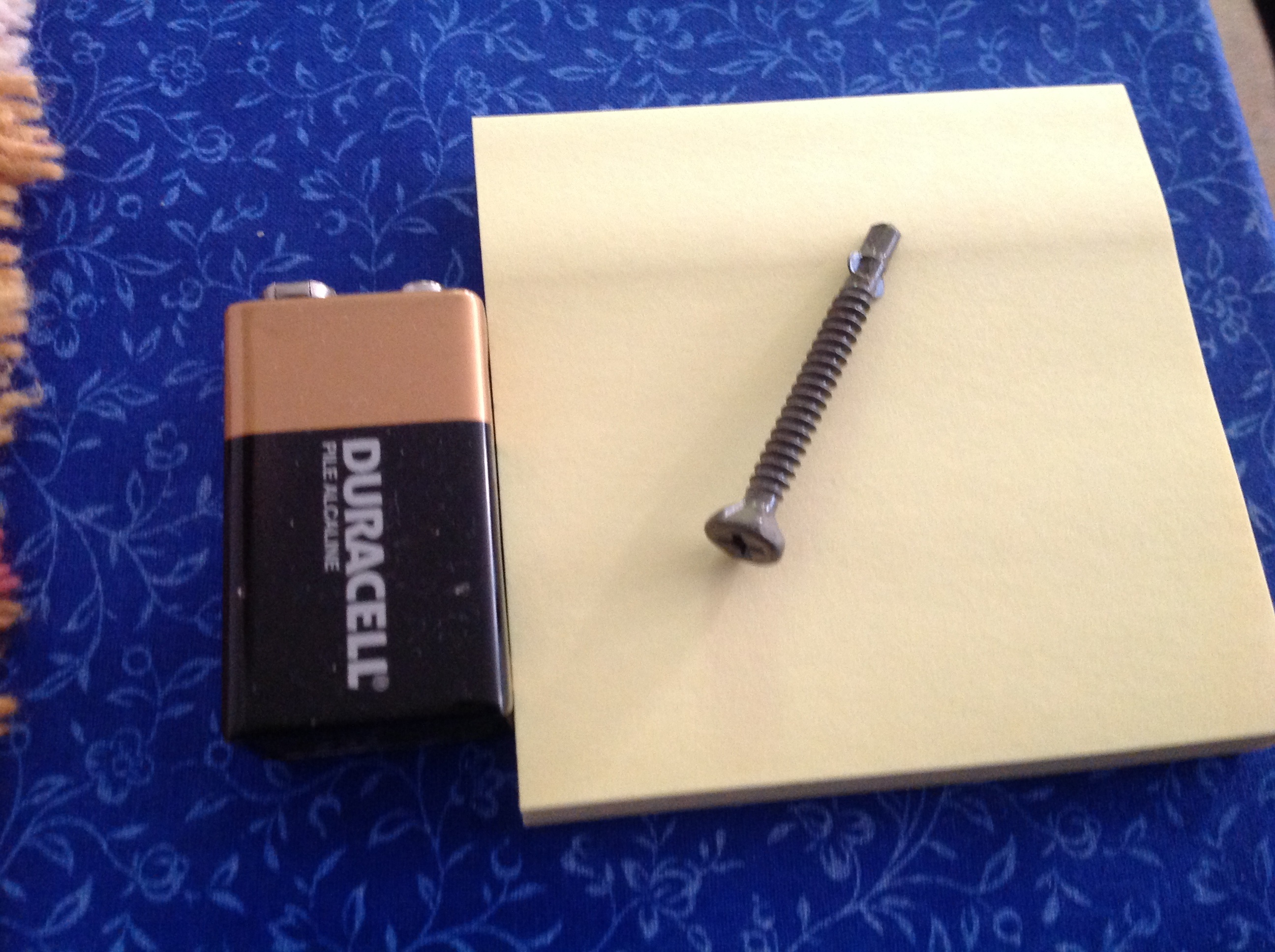

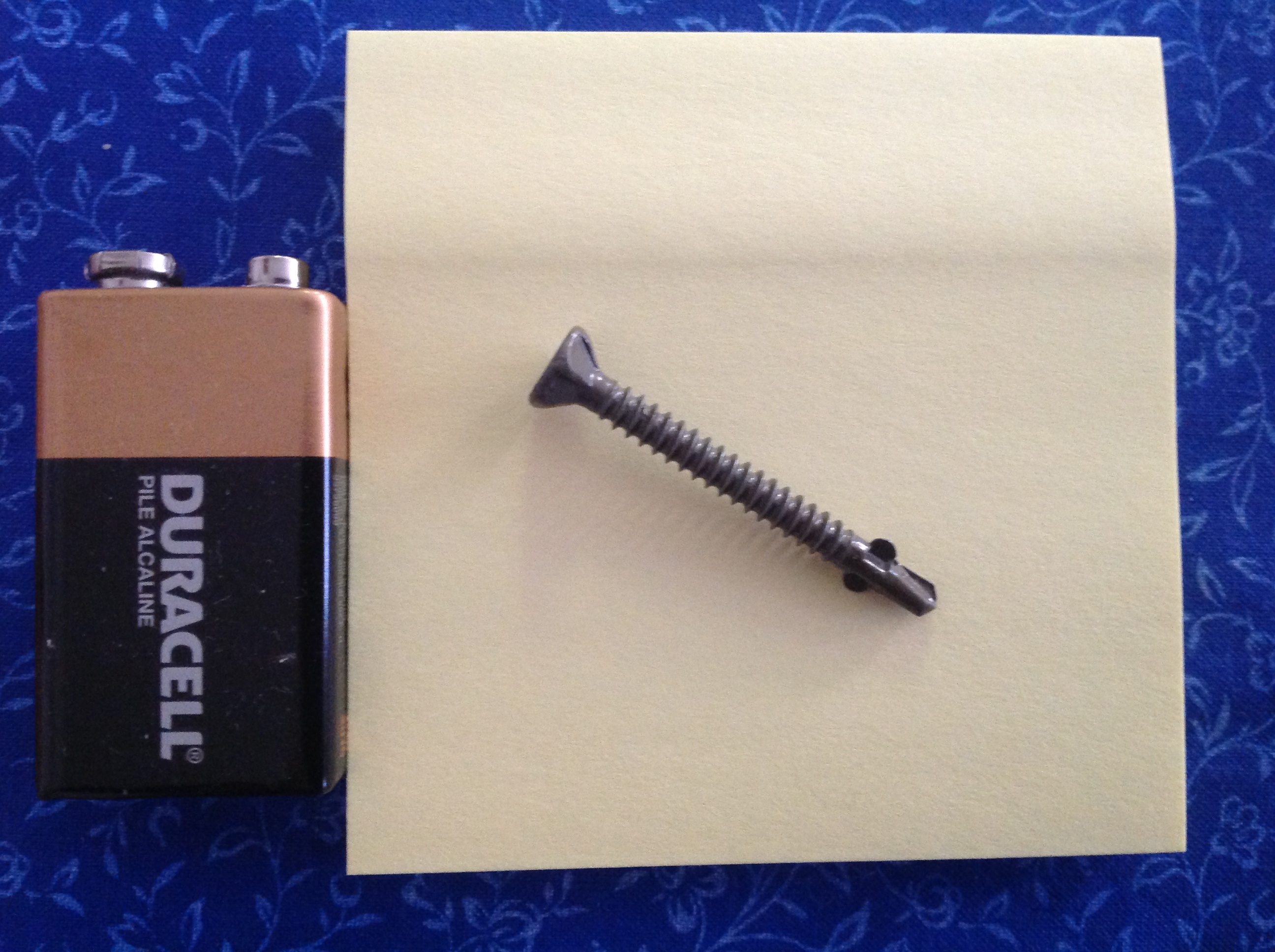

Hi,
A while back a guy on a jobsite gave me a handfull of these screws. I was fastening plywood to 1/4" steel and they worked exceptionally well. I piloted first through the plywood and steel with an undersized drill bit, and then drove the screw in. It worked better than anything I have encountered so far. Does anyone know the name of this screw?
Thanks,
Peter
9/16/13       #3: What type of screw is this? ...
Eric Olsen  Member
Website: http://www.blueworldindustries.com
teks screws
Teks screws
9/18/13       #4: What type of screw is this? ...
Peter Moffa
Thanks Eric!
9/18/13       #5: What type of screw is this? ...
ranliker
I think our local industrial supply house (Fairbury Fastener) has these. I have used them in years past for 'construction' type uses. I don't think you should have to pre-drill at all. The 'ears' on the screw are to chew the shank hole in the plywood. And the screw itself is self-drilling in the steel. My experience was with fairly heavy gauge steel, but not 1/4", so that may necessitate pre-drilling.
9/18/13       #6: What type of screw is this? ...
B.H. Davis Member
Do the ears snap off when they hit the metal?
9/19/13       #7: What type of screw is this? ...
ranliker
Yes.- And sometimes the drill point won't last to make it through the metal.
