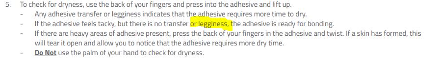

Can anyone explain what legginess is when it comes to contact cement. I am not sure but I think it might be a missed translation, possibly in reference to "traction". Like that news story has "legs" or it is gaining "traction". Thank for any insight.
Product: Helamtin 775
View higher quality, full size image (893 X 120)
Helmatin 775 Datasheet
10/7/21       #3: Adhesive Legginess ...
Mark B
If you touch the adhesive and pulling away you get stringy/webs between you and the substrate thats leggy. I dont honestly know when you'd really see that in most day to day contacts as the window for that is super short. Your either going to feel it as wet to the touch or try or somewhere slightly in-between.
It would seem you'd have to either be running an adhesive that is inherently stringy or really try to push the window (seconds).
Typically with conact, unless your working on one part, a bit more time is not an issue. Just spray some other parts and let it go past so you have more parts setting up while your smashing the ones that might be "leggy"
