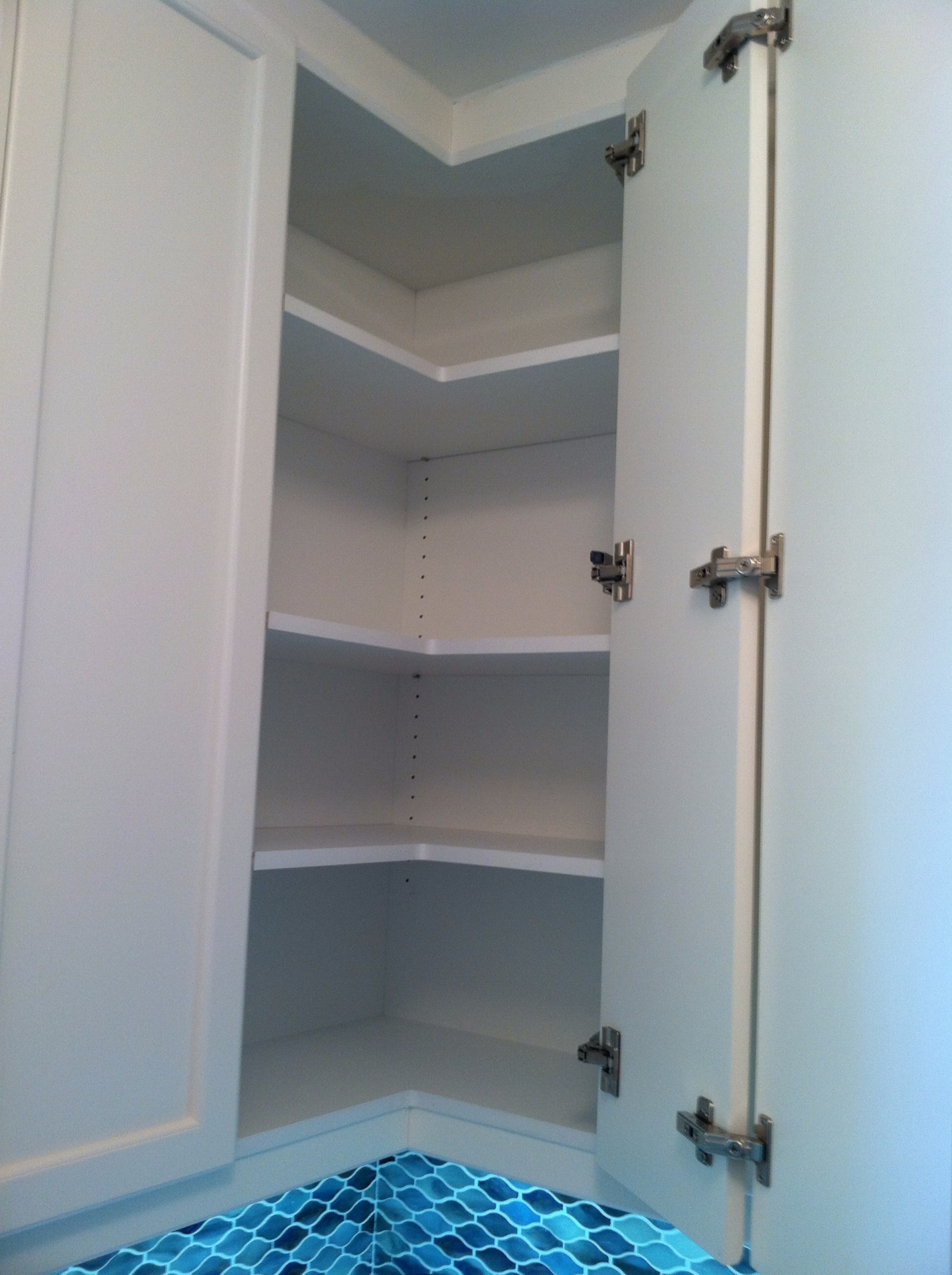

Here is a pic of a corner cabinet with the pie cut hinge
View higher quality, full size image (1434 X 1920)

ok well I guess I will do that .
you right Paul I did not think of the handle if the doors are hinged on both gables end ...I did see that in a picture somewhere .
