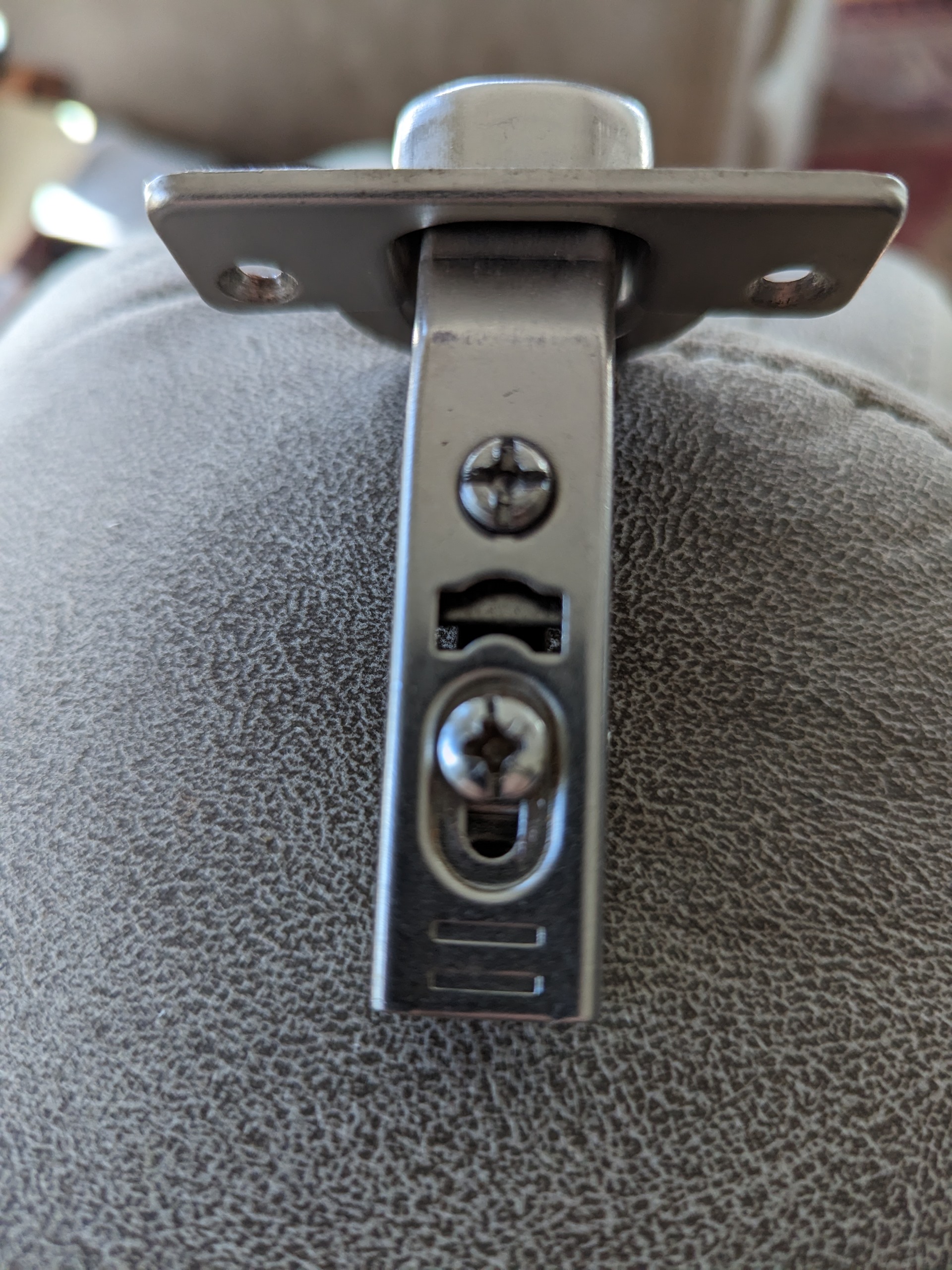

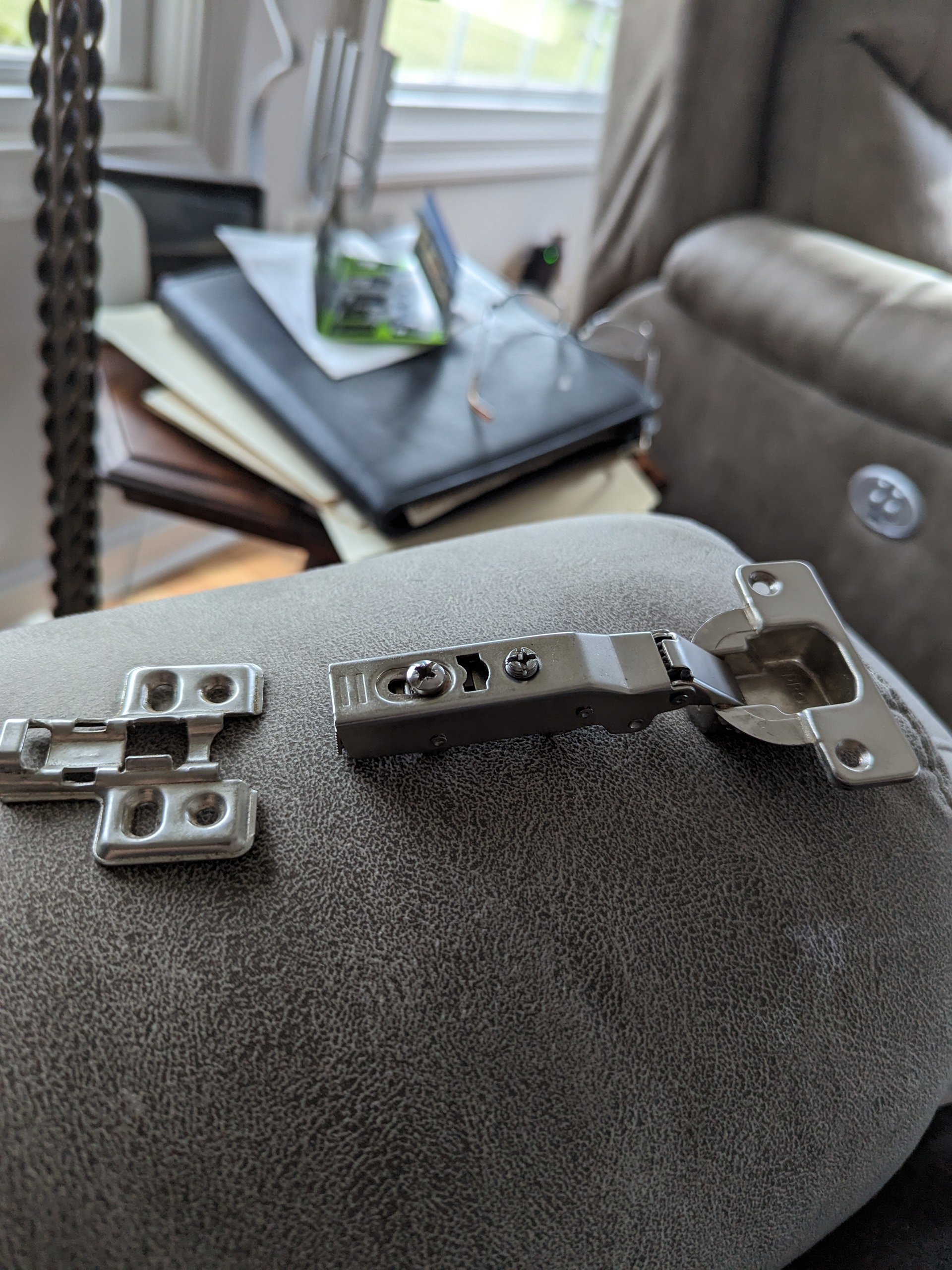

Trying to fix a cabinet we bought new with Drola Muvon hinges. The hinges were not installed properly or fell apart in shipping from overseas to the US. Need a guide on how to install and/or adjust the Drola Muvon hinges.

DTD Member
Unsure what the two screws are for? Just to lock it in place after being snapped in? Why then is one screw in a slotted piece?

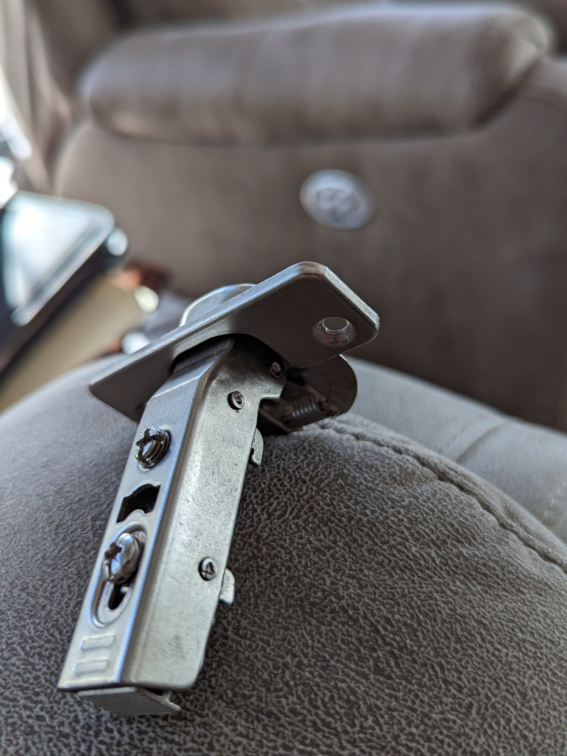

DTD Member
I do not think the cabinet was made to be in a corner. We have it against a wall but not in a corner. The screw towards the inside of the cabinet looks like a regular screw that goes through something slotted. The screw towards the outside of the cabinet looks more like an Allen head screw in that the head of the screw can go below the surface of what it's screwed into.

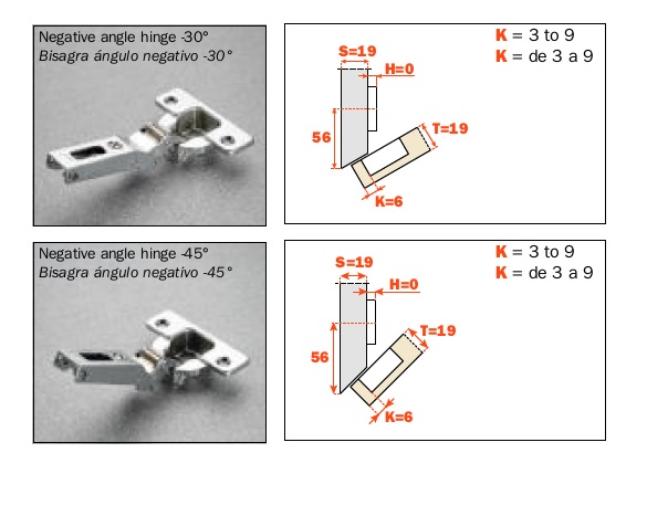

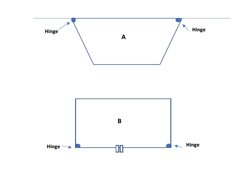

Hey DTD,
Sorry to play fifty questions but your photos appear that this is an angle hinge of some sort (Maybe -45 or -30 degree). Is your cabinet shaped, more or less, like sketch A or B?

2/4/23       #8: Drola hinge ...
Like A or B
