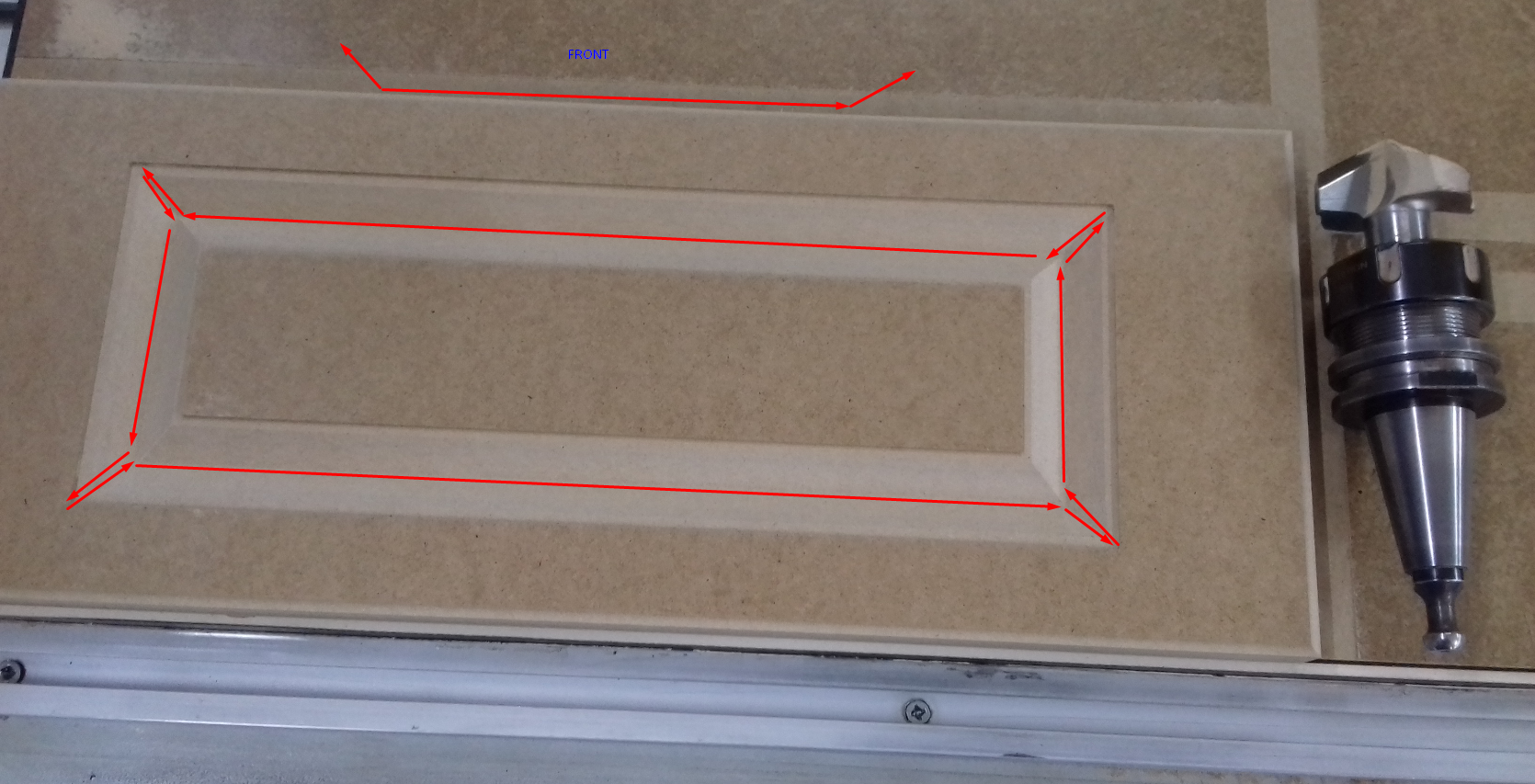

Trimming angles in Alphacam.
I can not solve the problem with constrained parametric angles in Alphacam.

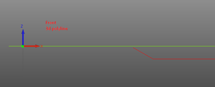

For the drawing, I'm using 3d polylines. To draw the path of the tool by which it will rise and fall in the corners. Without use work planes.
I can not understand how to draw in the axes in work planes.
Are there other ways to indicate the path of the instrumen- tation so that it rises and falls in the corners. In Artcam there is a function "Trimming an angle" when engraving. In Alphacam, I have to manually draw the path of the tool on the corners. It turns out that something like a closed rectangle with sharp outgoing rays raised up to the desired angle in 3D polylines. It's very tiring to draw. In cconstrained parametric, these corners are stretched incorrectly.
How to draw such angles in axes in work planes or there is another way to solve?
To parameterize a workpiece drawing.
Thank you

Try i this way.
Video

possibly do it with a profiled cutter and do the corners as a rest machining operation?

Aleksandr  Member
Thank you so much.
I did not receive messages from the forum and I could not respond.
Video from Marek helped me a lot and I immediately solved my problem.
Thanks again to all of YOU for your participation and help !!
