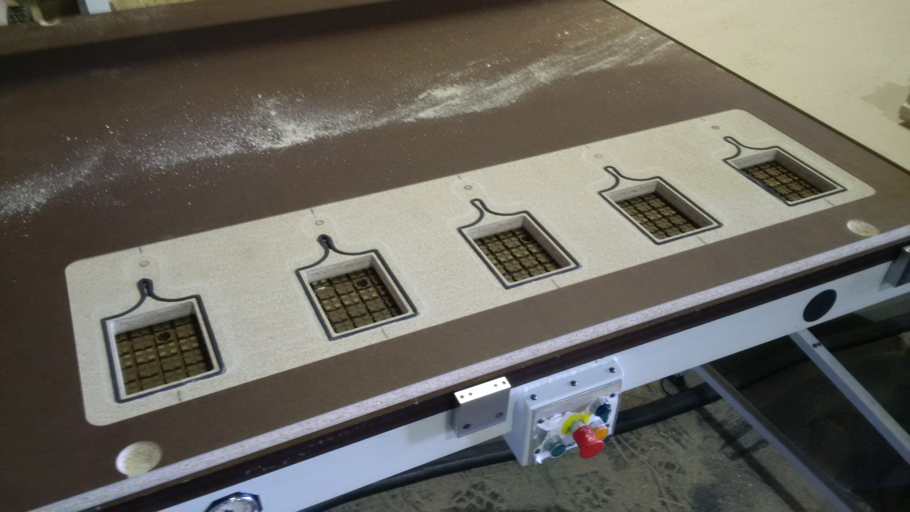

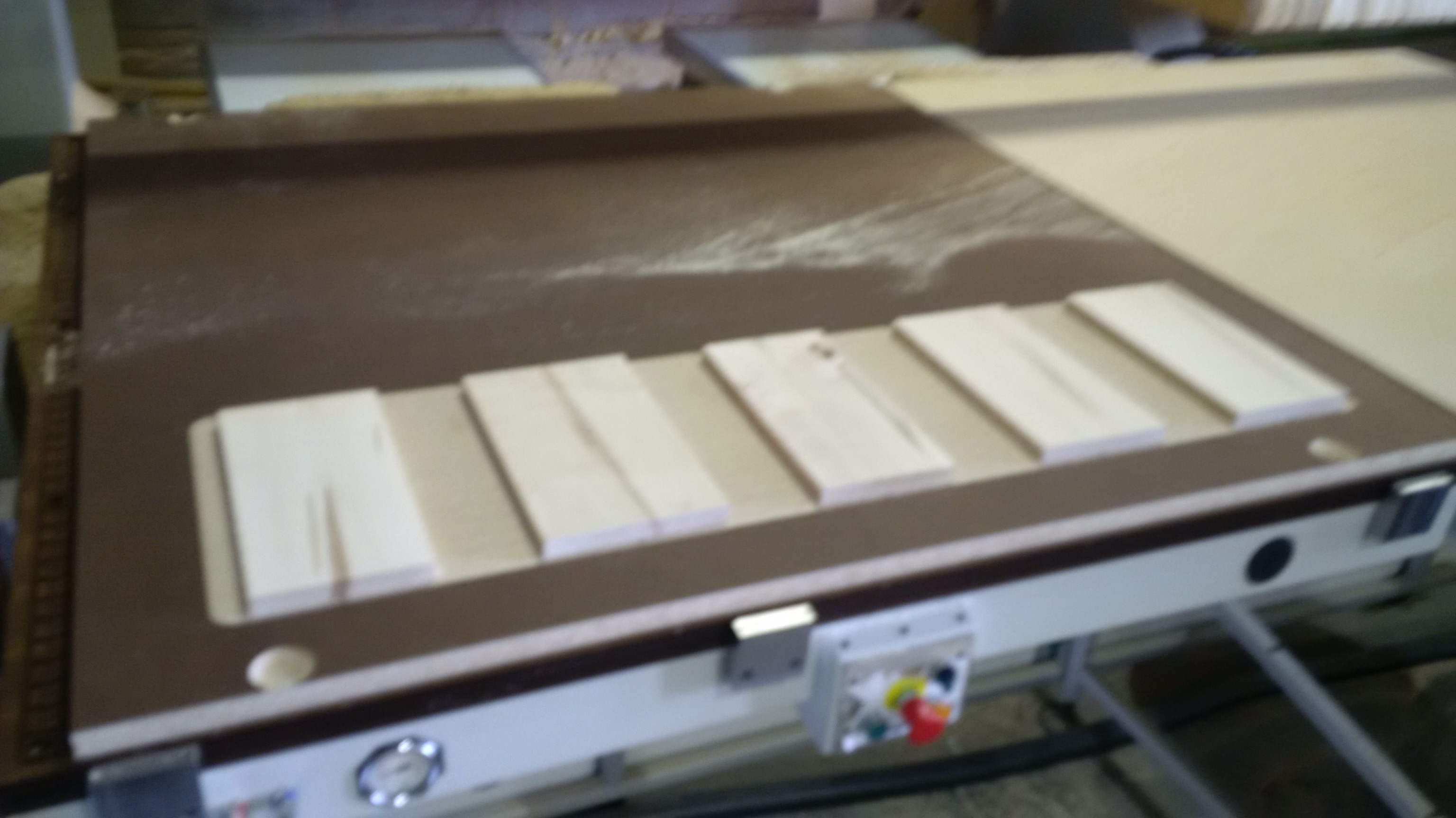

12/4/17       #4: Using gasketed fixtures on a nested ...
Just did some small cutting boards
View higher quality, full size image (3072 X 1728)
12/4/17       #5: Using gasketed fixtures on a nested ...
Looks like Christmas gifts!
