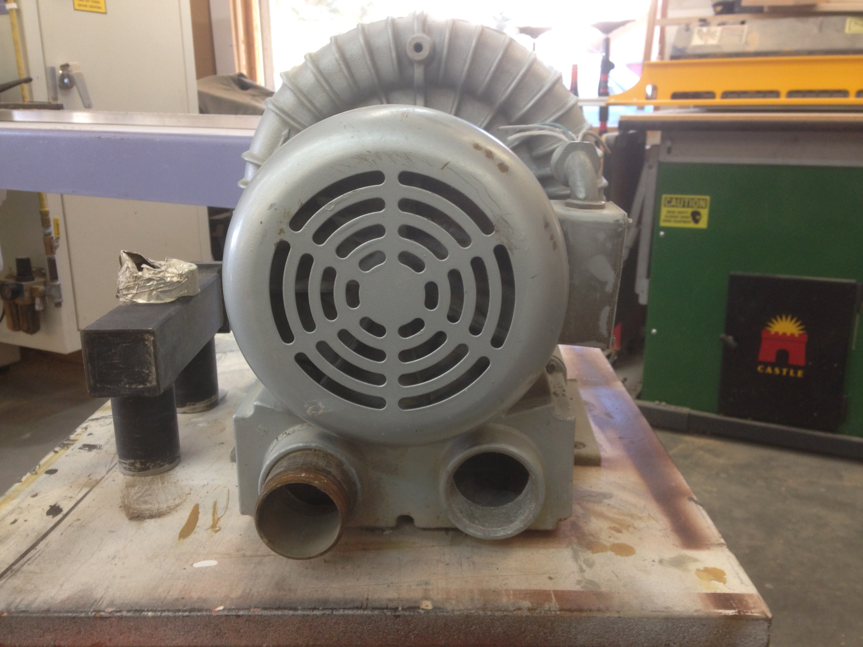

I just scored a 5hp regenerative vacuum motor for free. I'd like to build a dust collection system for my cnc with it. I'm thinking I could use this to suck dust through a cyclone, drop it into a sealed container, and blow the output from the cyclone into a filter bag. I've built a few smaller systems like this for my shop using regular 1 hp - 3 hp dust collection blowers that have 4" - 6" diameter intake and outlets.
With this new motor, the intake & outlet is only 2" in diameter. I'm wondering if this is going to produce enough cfm to make an efficient system. Any thoughts on this?

Sucking dust into that is a very quick way to get it to self destruct. They are meant to create vacuum, not suck dust.

I would not be sucking dust through it, the cyclone would be taking care of that. My question is, will the 2" diameter inlet & outlet allow this motor to pull the cfm necessary for efficient dust collection?

Although a cyclone will get most of the dust (if it is the right size cyclone) the fine powder will get through hence the need for the filter.
That is not what it is designed for.

I don't think it would move near enough volume of air. Looks like it only has about a 2 1/2" intake.

If you got it for free you'd be better off selling it to fund a proper fan for dust collection. It would be a sin to try to rig up that blower for the purpose you mention and have it destroyed in a few hours.

Thanks for the responses. I think I'll take the advice given and abandon this idea. The free motor was enticing, but if it won't pull enough cfm and also be likely to fail, this project's not worth the effort.
