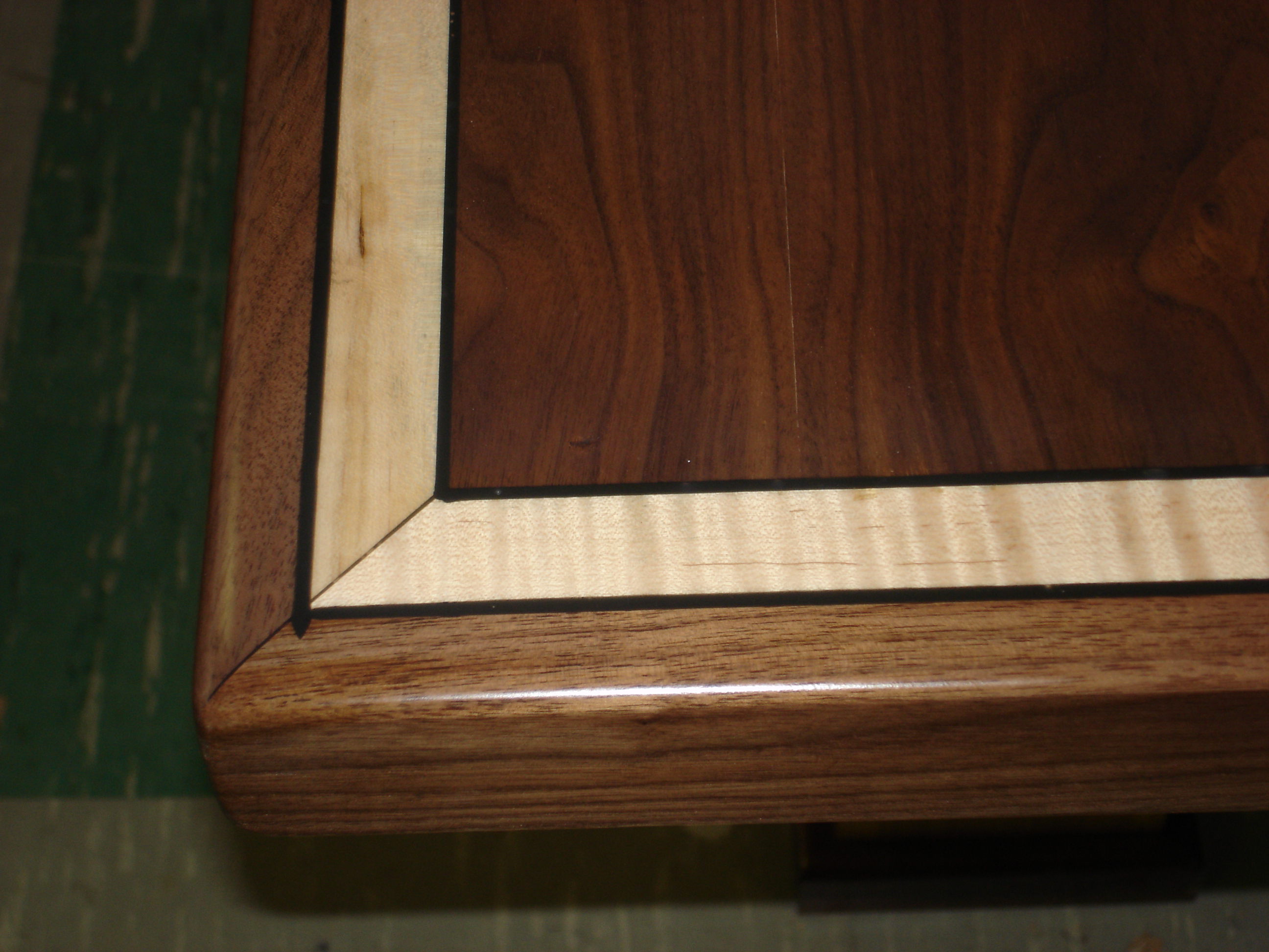

William Weber
I built a walnut table fourteen years ago for our hunting camp located in the mountains of Central Pa. Elevation is 2000 feet the place often sits unused for months at a time. often we get there in the winter and inside temp is in the teens, we make a trip in February and have encounterd temps as low as five degrees inside. We have one hell of a wood burner and can have the place up to 70 degrees in a few hours. The table started its life as I huge conference table from a bank built in 1932 I cut it down and reworked it to fit in camp it is now three feet wide x11 feet long. the top is 1.75 thick laminated plywood with walnut veneer, and banded with .75 x2 curly maple married to .75 x2 walnut, all glued up with Tight Bond II. The table was sprayed with ML Campell Magnmax . The table still looks great. If I were doing it now It would Most likely be conversion varnish or 2k poly, but the Magnmax held up well
