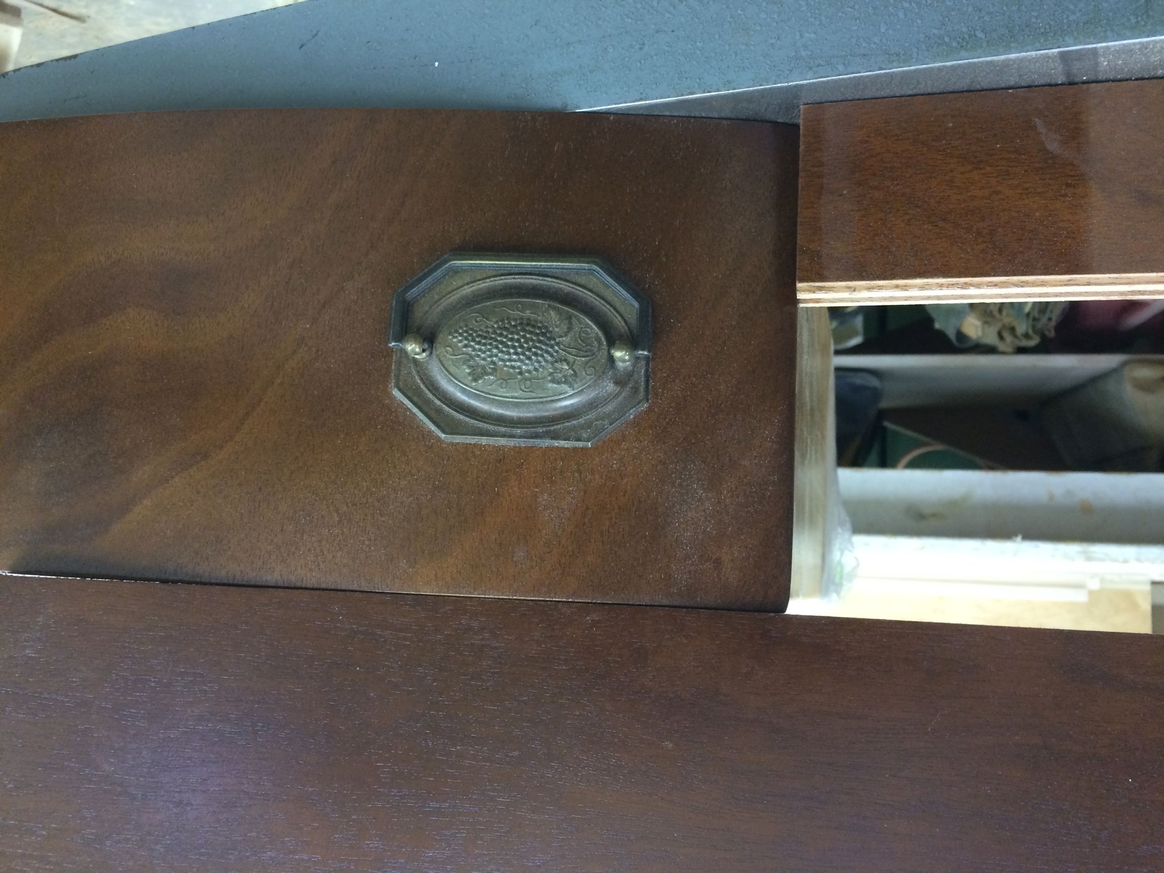

Attached images of drawer front stain I am trying to match, sample looked good, depending on how you hold the finished piece and light it looks way off. A little green and yellow toner?

rich c
Of course, recommending or using a suggested color fix based on a photograph is professional suicide. But the one picture looks like you need more red and a touch of black. If you add green you will kill the red and I think you are short of that already.

Nick
What has worked best for me when trying to matched a aged piece where the match has got to be spot-on is to look through the ambered finish to what the original stain color is (oftentimes the back of the drawer front or the inside of the piece will let you know where to go) then just make a amber toner to apply on top of the stain and viola you match is close to perfect. Of course you do this first on a sample piece.

ScottAM
First picture is drawer on right, finished new piece on left.

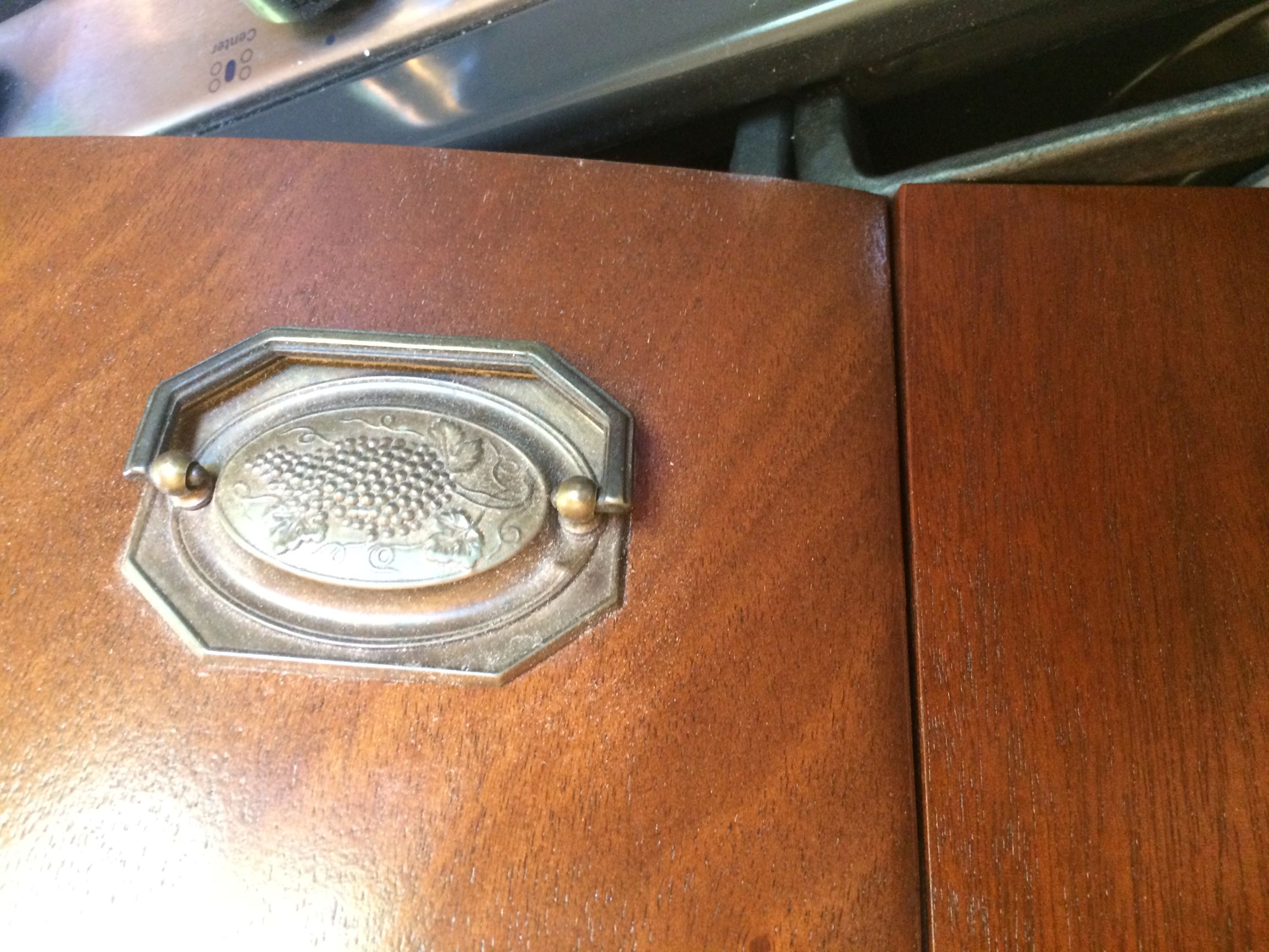

Second picture, sample piece on left, little bit of brown toner on the right end of the sample, finished new piece on top of drawer.

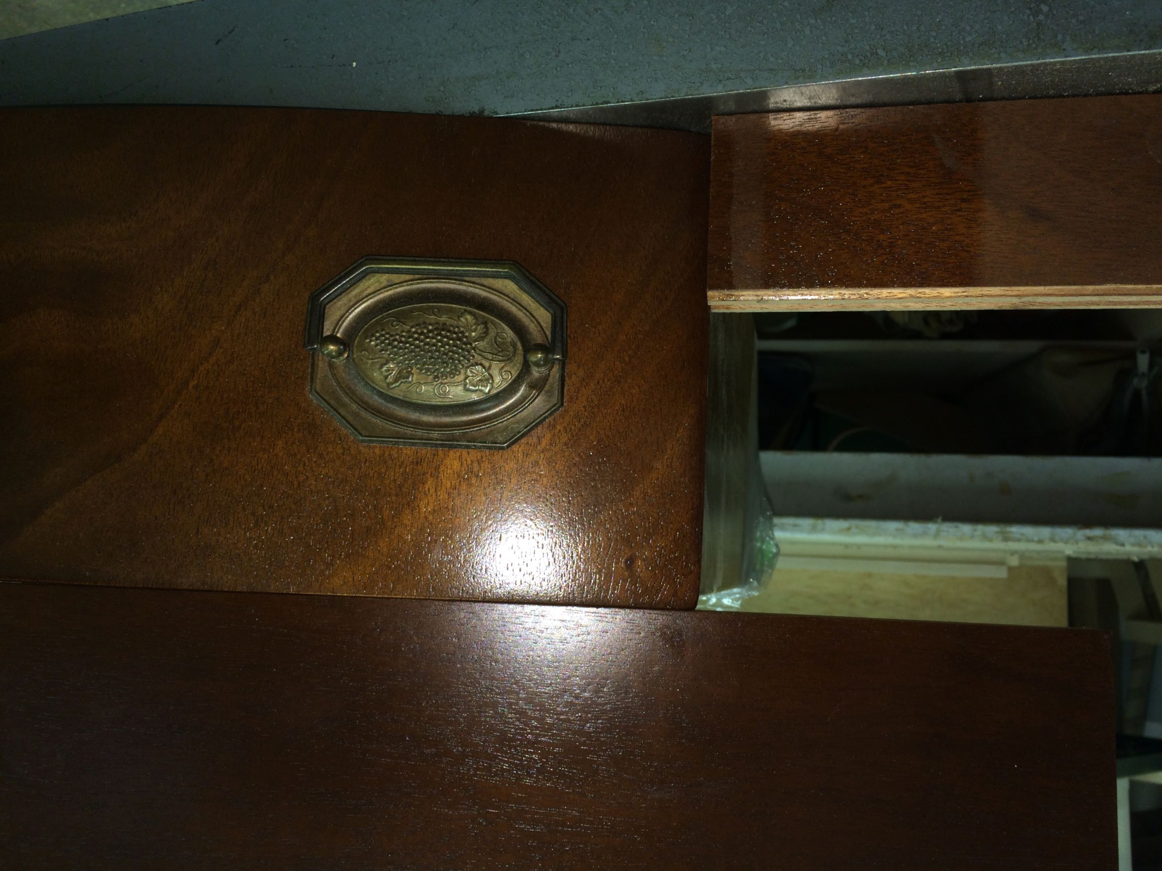

Third picture, sample on left, finished piece on top of drawer.
Quite a variation in the different views.
