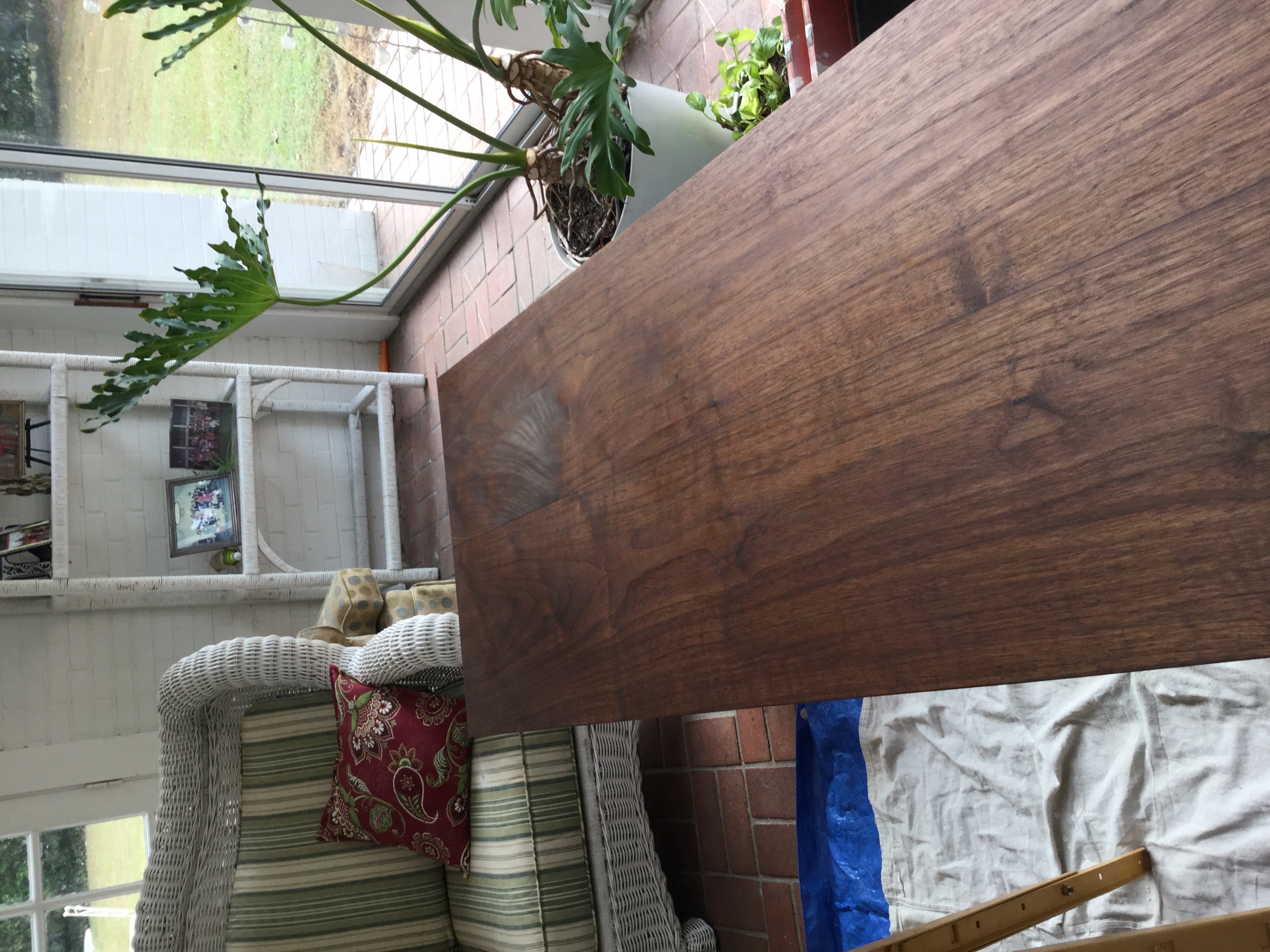

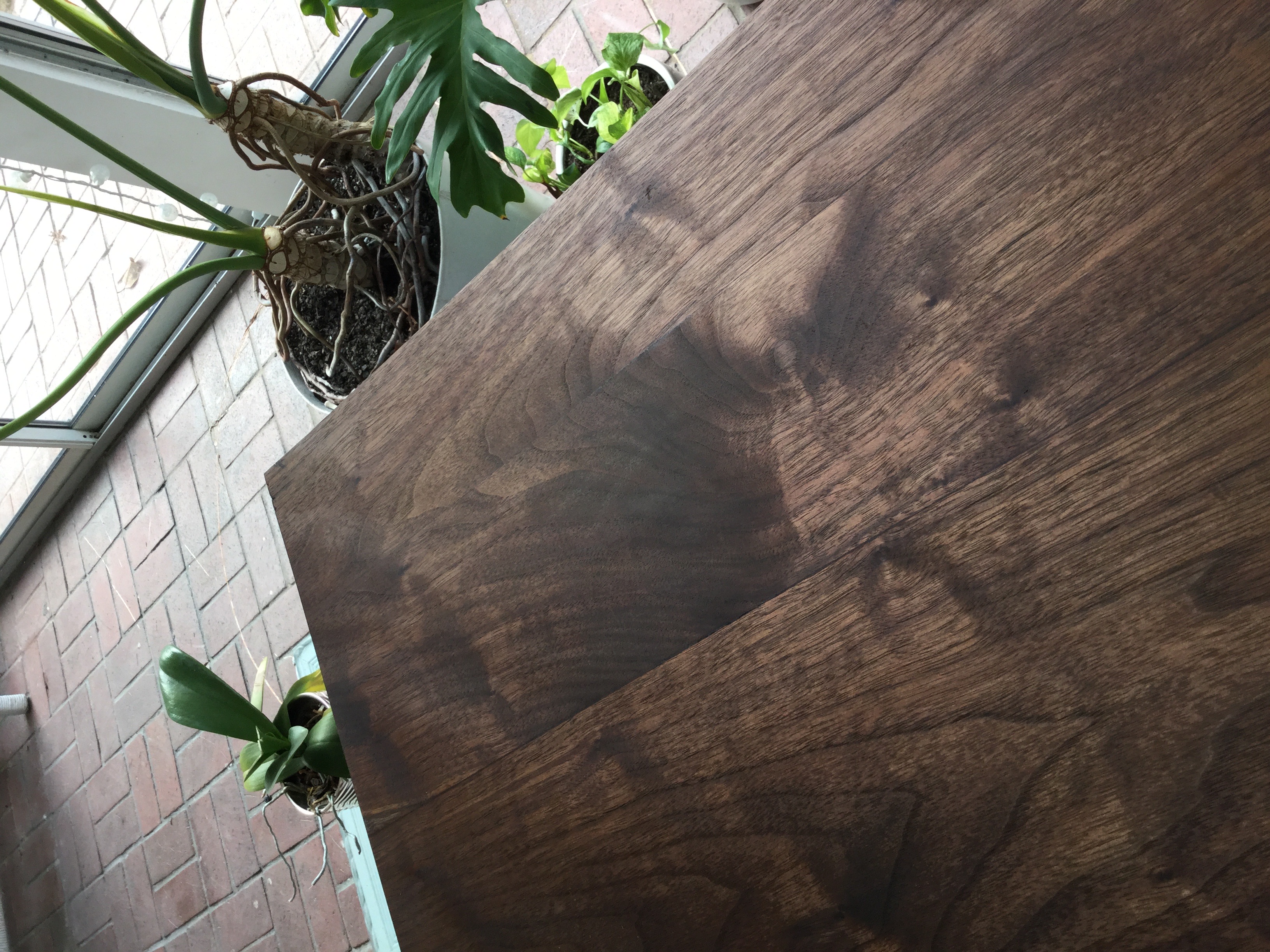

Need some advice.
Send it down this countertop 80, 120, 150, 180, to 240.
Applying danish oil with great results except for this one spot where are you can see it’s very dark and actually has a grayish tint when viewed from the side.
Plan to finish with Poly.
Am I stuck with this spot, is it normal, is there something I should do?
Any thoughts would be greatly appreciated

That's an area with a lot of end grain fibers so it's sucking in more finish; very typical of how blotching occurs. There's no good way to eliminate that using Danish oil although sanding even finer would help.
Eliminating that blotching would require getting back to bare wood. If you can spray you could spray dye to get the color you want. It won't blotch as long as you don't spray anymore than the wood can absorb. I'm not saying it won't still look different where that end grain is, but the color will be more consistent with the rest.
If you can only finish by hand then you likely will have to seal or condition the wood first and then use a glaze or gel stain to get the color you want, then seal it again, and then apply a varnish clearcoat.

Just a caution, Watco Danish oil is a poor choice for a countertop. Little wear resistance and lower water resistance than most other choices. Yes, definitely changing grain. Curious about the edge joints too. Do you not have a jointer? Will you customer accept those? Mine wouldn't.
