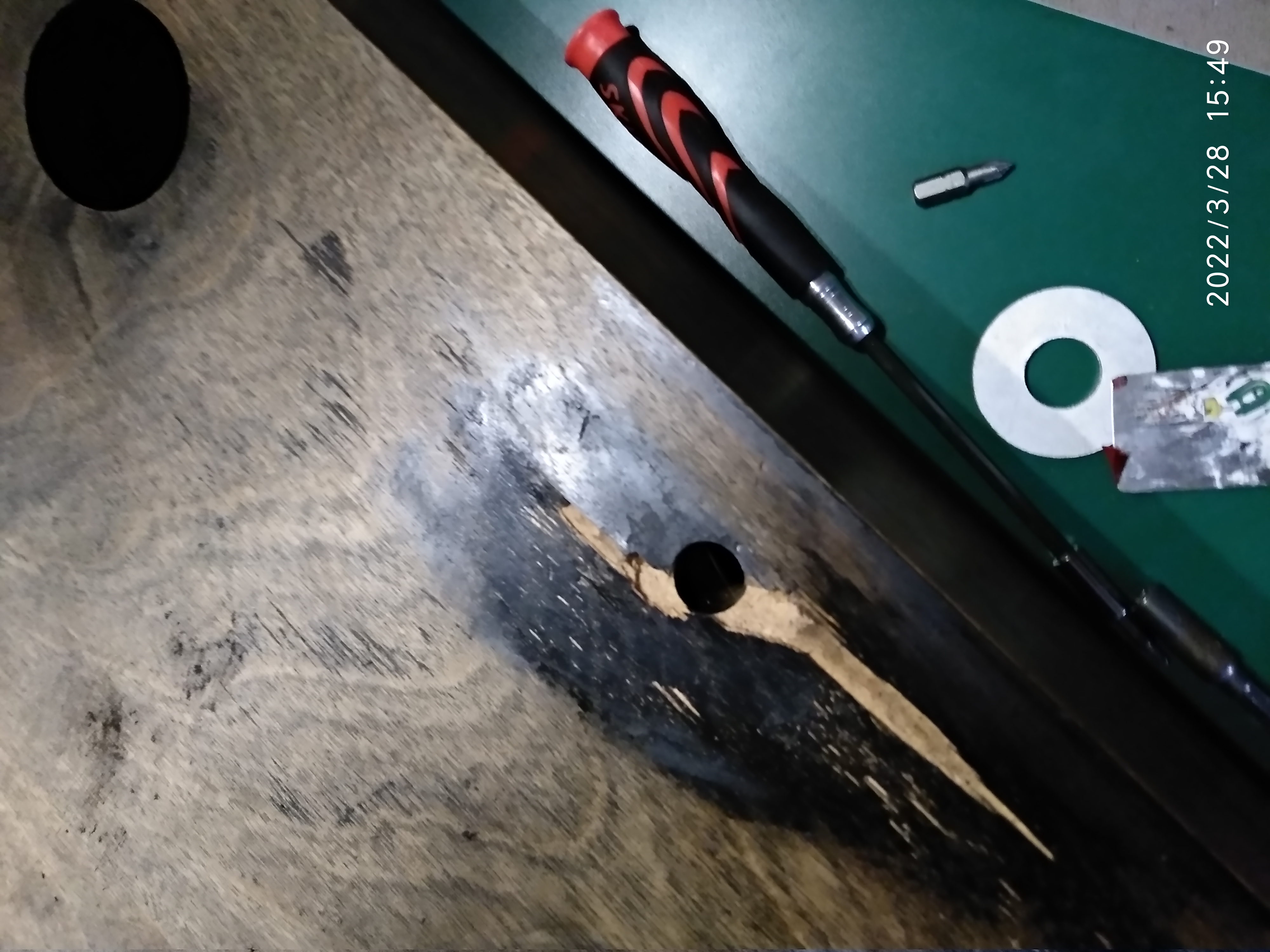

I've got 40 year old turntable plinth made from MDF and finished with wooden veneer painted with a black paint. I have small area on the top where the veneer and MDF is damaged.
My initial approach was to remove old veneer and put a new one but I managed to strip old pain with acetone without dissolving veneer adhesive, So I want
1. To glue a small piece of loose veneer that lost adhesive because acetone got under it.
2. Fix the crack with wooden filler.
3. Slightly sand the plinth with 100 and 200 paper.
4. Stain in brown.
To glue pieces of loose veneer I usually thin down carpenter glue with water and inject it with a syringe but I wander if I get the same result with super glue?
Is it possible to use just stain to paint it brown or because of black paint residue will affect the quality?
