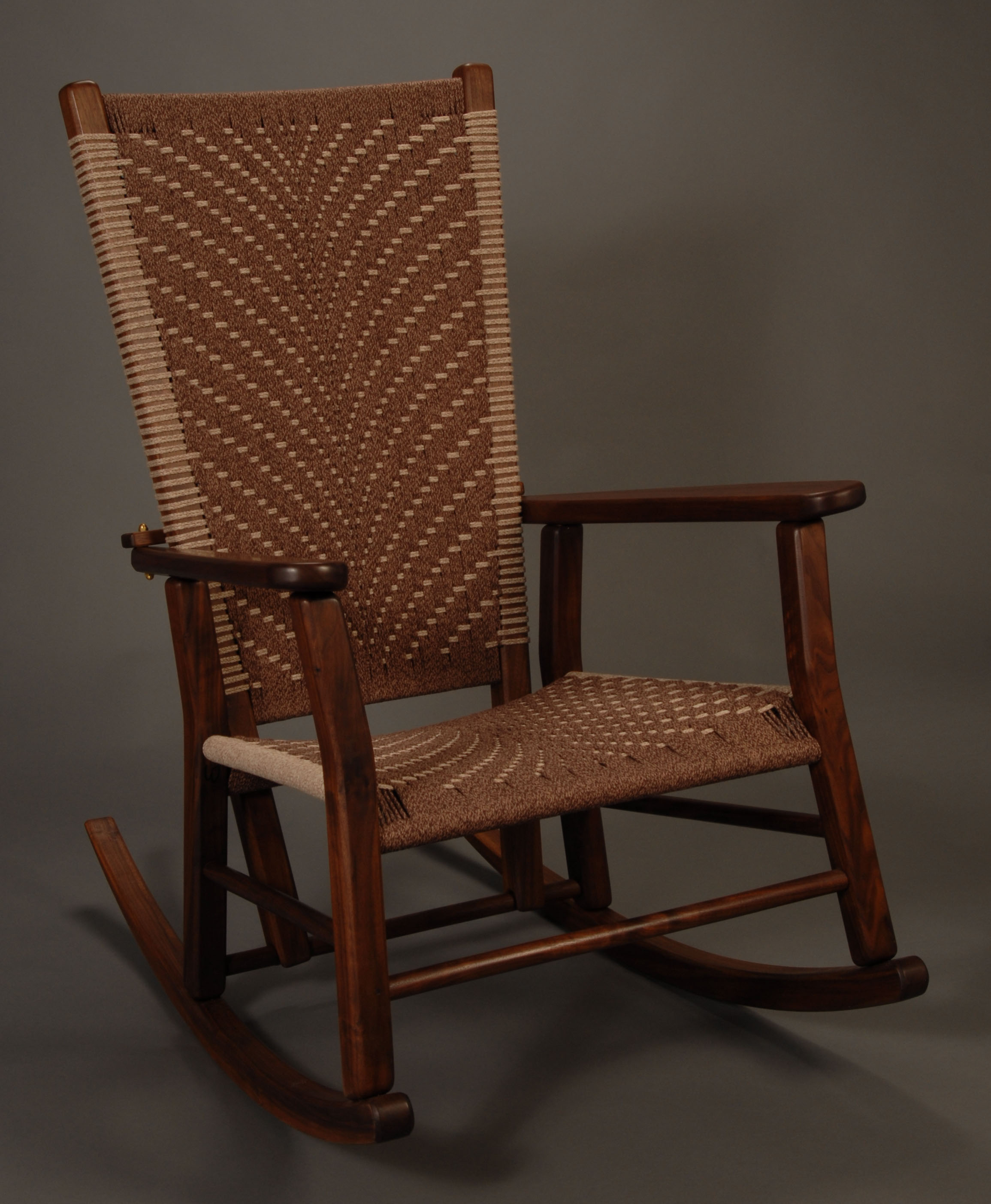

Walt Turpening
Website: https://www.facebook.com/WTBSC
I make woven seat style seating. The seat rails are 1" to 1 1/4" hard maple dowels depending on the span. I use 1 3/4" to 2" leg and back stock. 1" deep 1" round mortise and tenon joinery.
I have made chairs for 'large' people. Up to 375# and 6'8". I have a rocker I made for myself (290#, 6') 17 years ago that is my daily 'user'.
I have only had one part fail on a large Settle and that was not the joinery. The 1" hard maple dowel side rail had a green stick crack. The way the seat is woven prevented full failure. The Settle was repaired and now 15 years later still in use.
Take a look at my pieces on the web page. Photos go to Albums and then Rockers.
View higher quality, full size image (2310 X 2805)

D Brown
Walt , that is a beautiful chair and I love the pattern you wove , well done .
