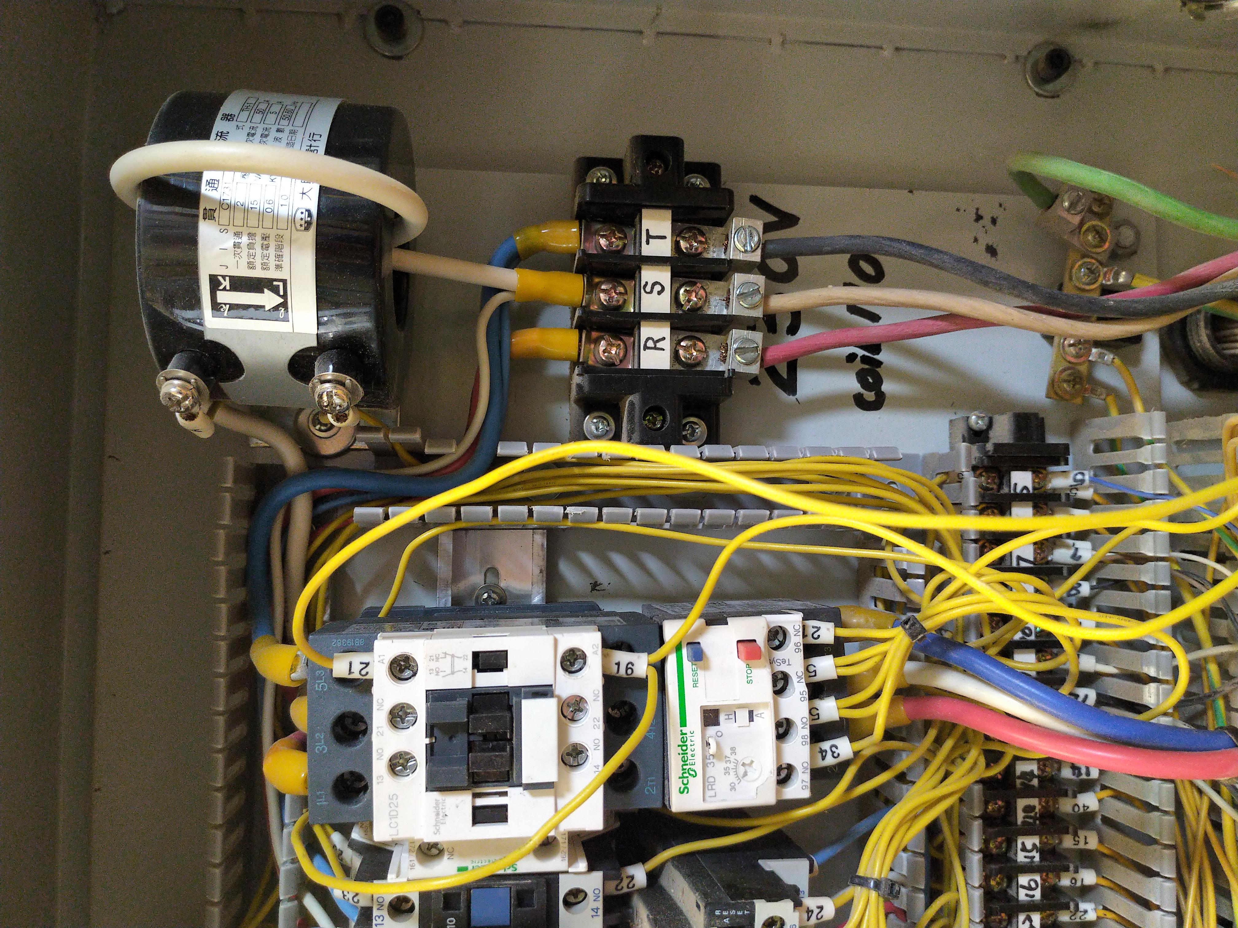

I need insight if this is connected right. I have my generated leg on the T terminal. Everything turns correctly but the start contactor for the motor chatters and jumps to 50A. We start the machine by usually pushing in the contactor and then it runs fine.

Your magnetic starter most likely is 220 volts. Make sure it is not using the generated leg and is wired to the two 110 volt house legs. Might not be the issue, it's the first thing that comes to mind.

Solved!! Bruce you got me looking and the stupid electricians put the generated leg on the T pole which is connected to the transformer and is over 230 v at idle plus a line leg at 110 volts. So in this case the generated leg had to go on the R, and the S and T on the line legs. Started like a charm. Paid the electrician close to 1500$ to look at it and they even changed the contactor at a 400$ hit when it was not needed. Stupid me the whole way.
