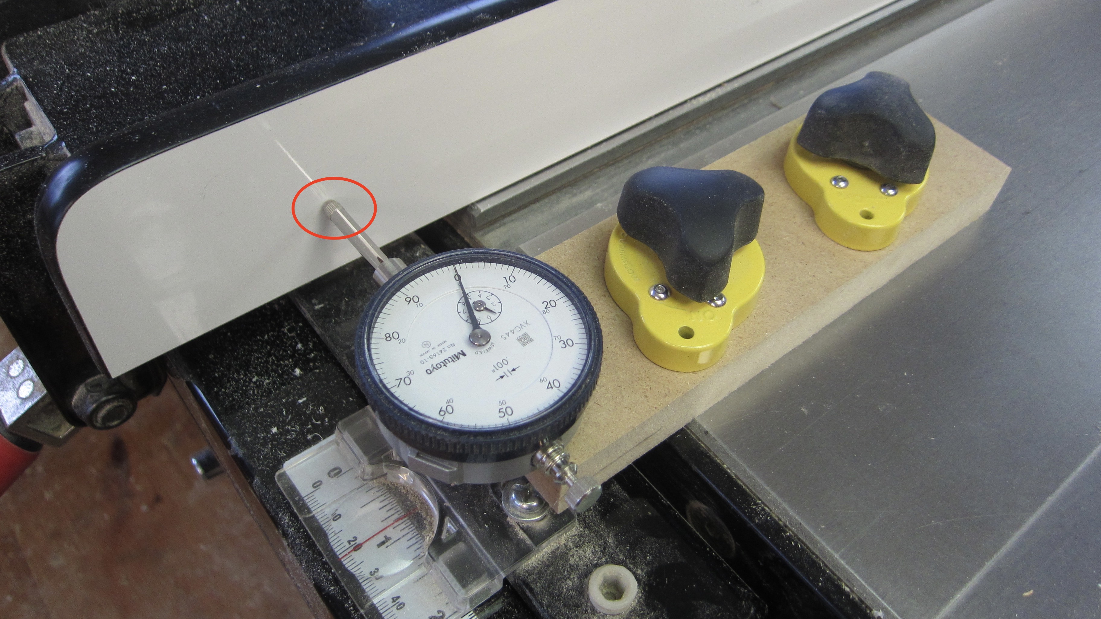

Moving a table saw fence by very small amounts can be hit and miss.
With a dial indicator at the right location on the fence, I found it is easy to tap the fence and move it by 0.001 inch at a time.
Locate the probe of dial indicator over the fence rail so that dial indicator does not change when the fence is tightened - see red circle in photo below.
A couple of times I have found this fine adjustment helpful:
