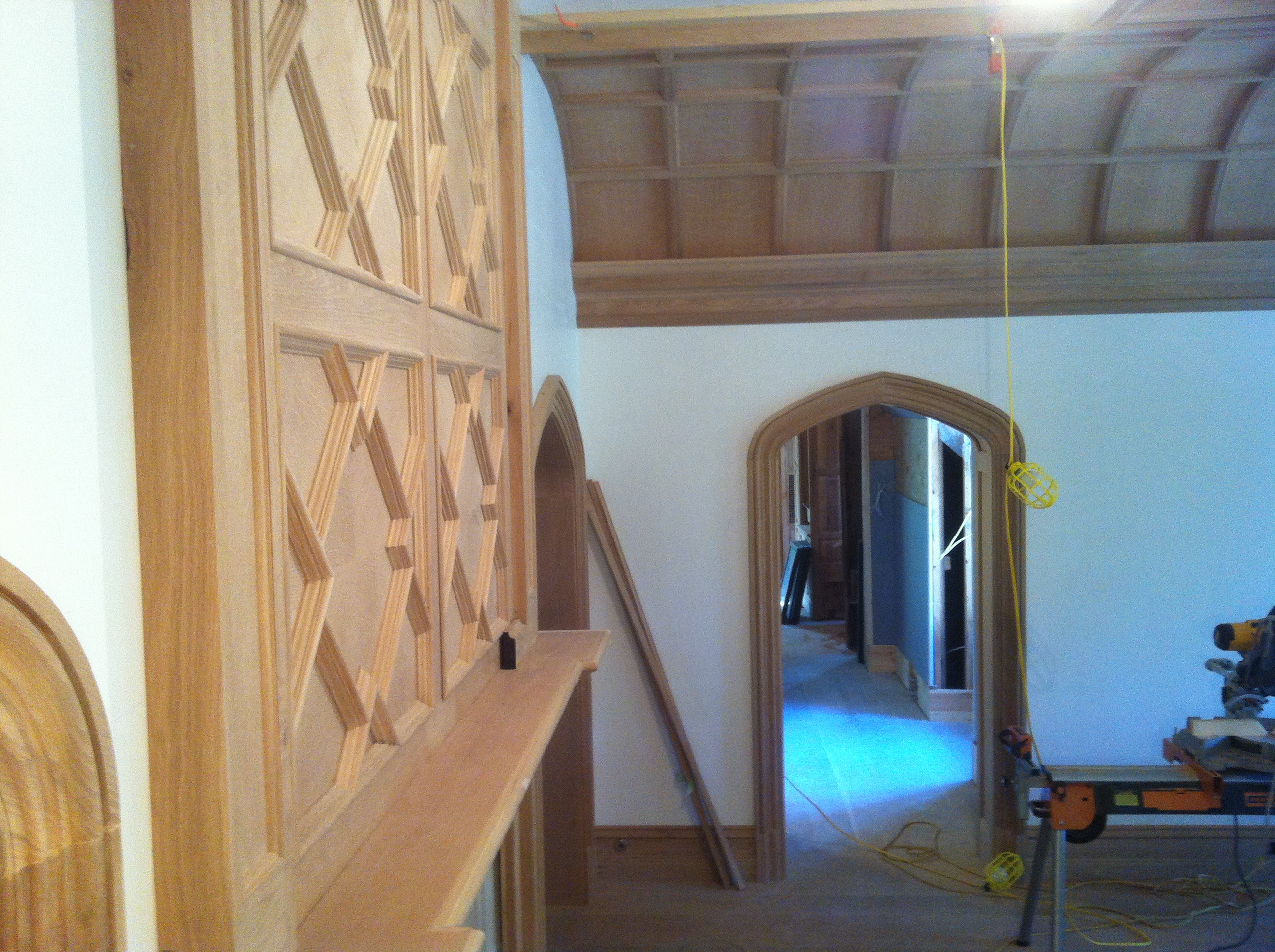

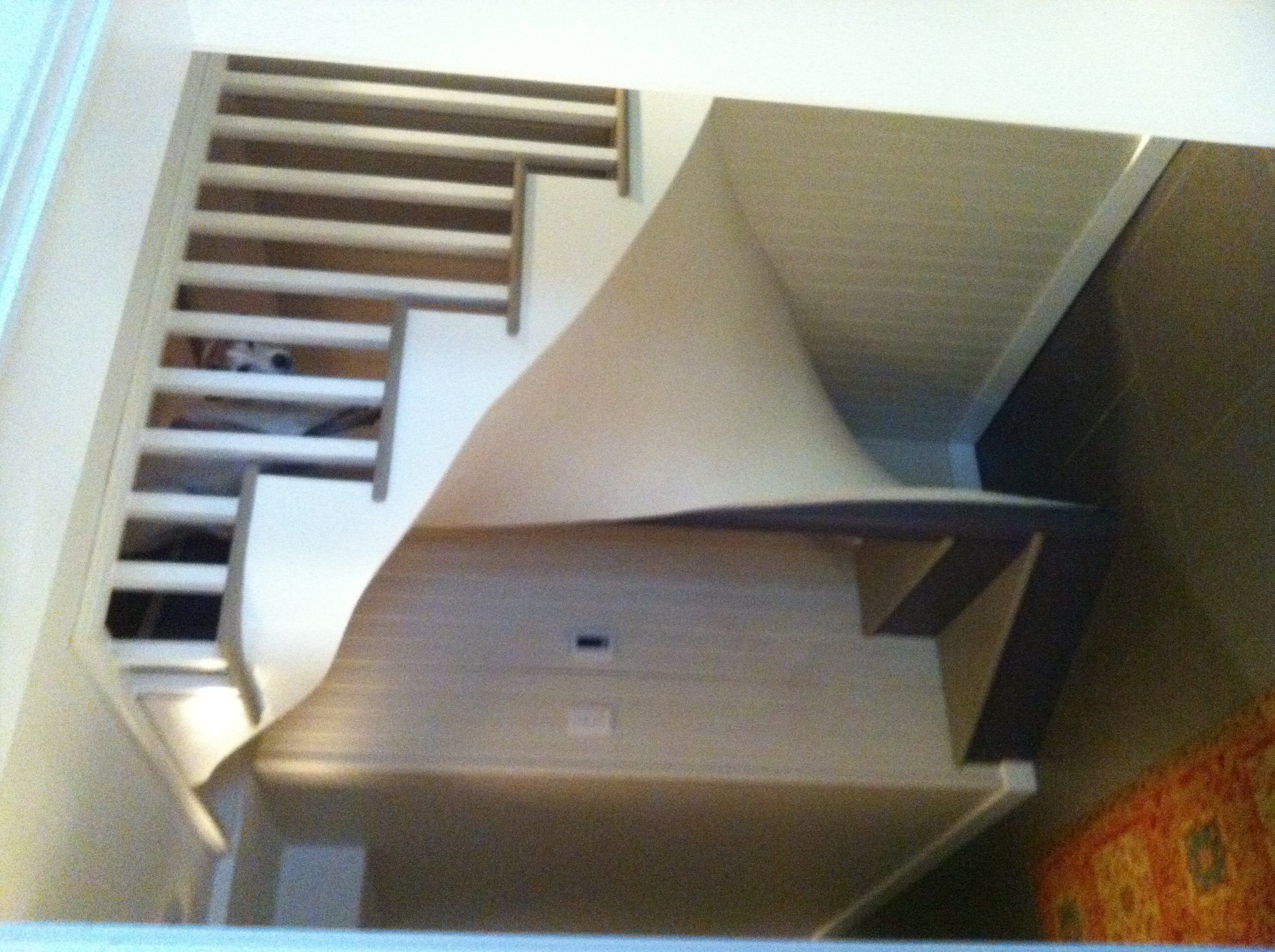

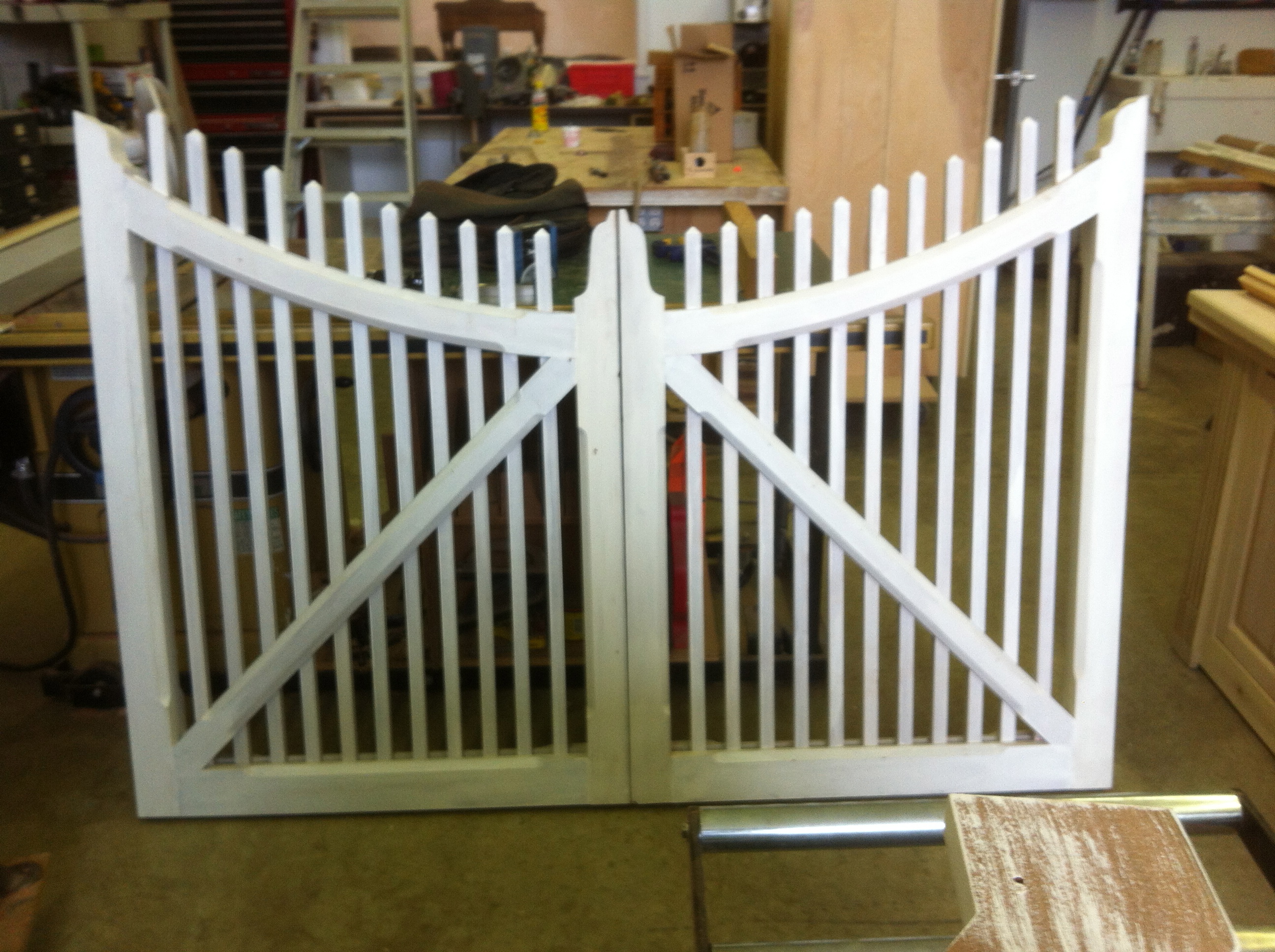

I have been a woodworker for 25 years and would love to modify my career switching to estimating. I've had my own shop design/building custom furniture, millwork, cabinets for residential clients. I have essentially no experience in commercial work. I have been reading used text books and studying on the web for a few months learning all I can, and have experience over the years of working up Excel sheets for my needs. Although all my jobs are more or less one of a kind and typically challenging technically (a few pics attached show this). Can you give suggestions in how I might proceed with this goal?
