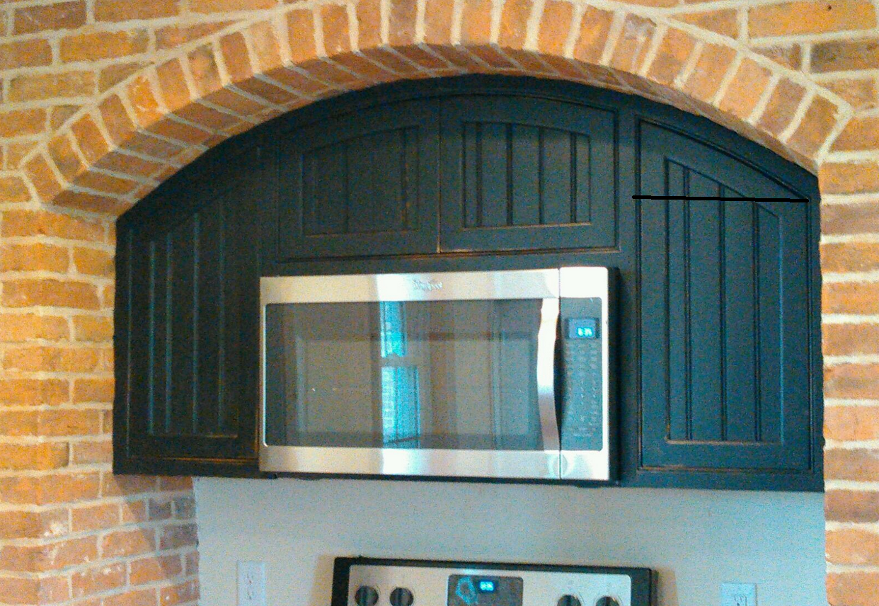

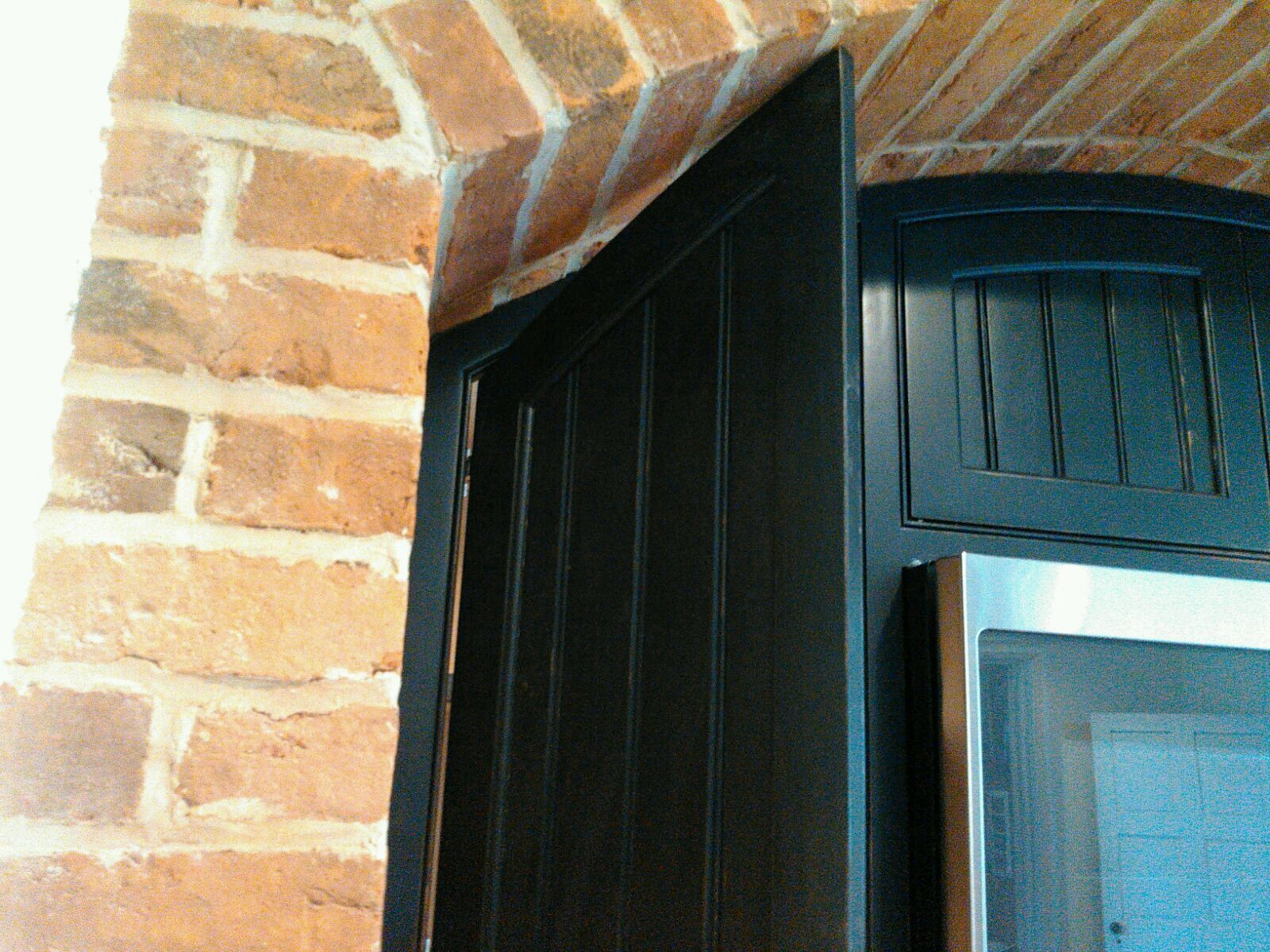

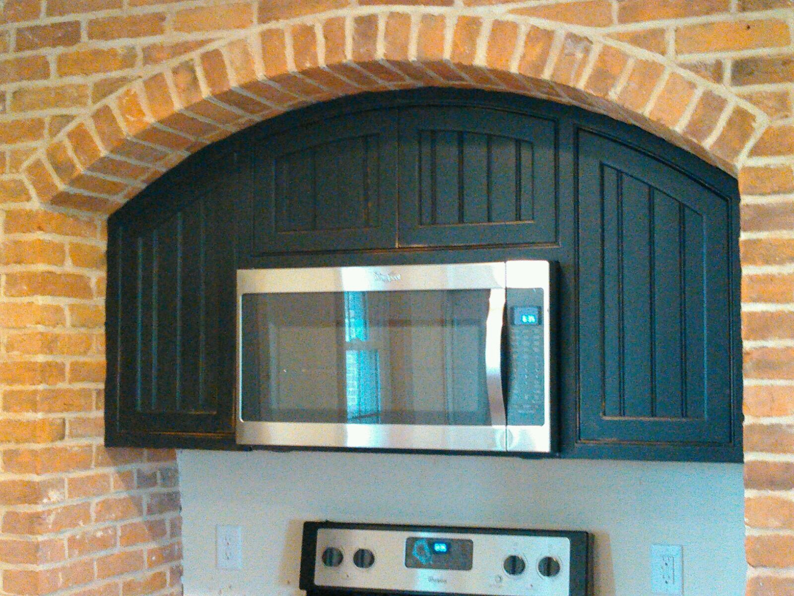

I had quite a surprise when installed these cabinets the other day! Any creative or hardware solutions that might help? I could just hinge them on the other side but it would make the knob placement a little odd ball. Over 3" would have to come off that door to make it work with a blum 86deg. angle restrictor. I'm still cussin....

put the hinges on the taller side of the door. Thats a whoops! Made a top in solid surface last week that i could not get into a room. Had to cut it and re-seam it in place. Happens to the best of us.

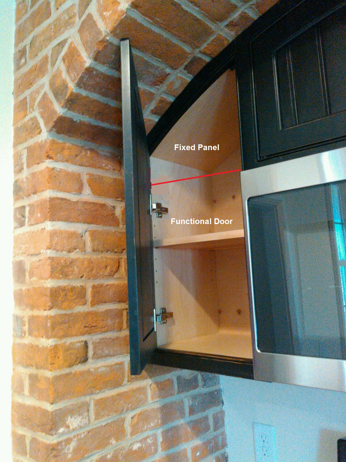

I'm probably (definitely) venturing outside my area of expertise but the topic caught my interest.
Would it be reasonable to do something like this? It doesn't seem like you would loose much usable access to the cabinet.

Or, you could hinge the top "fixed panel" also but on the opposite side and place a fixed shelf to divide the two sections.

A pullout would have access only on one side. Is the radius shallow enough the doors above the micro open sufficiently? Would have been well thought out if the sides and center were hinged on the other side, then mount knobs on the center of the rails.
Wondering if the geometry works for a pull down door as compared to a lift up door.
Dennis, your idea is interesting except your proportions are off. If the cabinet were longer, your idea would have more value.
IMHO, I would prefer hinging opposite.

Rich,
This is what I was thinking. (Here I go again, outside my box).

Rich...now that I see it here, I know what you mean about the proportion.

If you hinge it on the opposite side, you still only have access from one direction, strait in.
Also, when you take into consideration the brick wall and the door that opens to 110° +/-, you will be reaching into a deep, narrow space to access anything in the cabinets (it looks like it is 24”+/- deep).
And finally, what are you going to do with the 35mm & 8mm hinge holes that are already bored in what would be the wrong side? Anything other than a re-make of the door runs the risk of looking bad.
If necessary, a complex pull-out with the doors attached, could be designed that still allows the doors to be hinged to gain better access, although they would still have to be limited to prevent any accidental contact with the brick. The OP has used inset euro hinges, so they could be changed to full overlay hinges to gain 17-19mm of space for some sort of modification to overcome this challenge. I already have a design pictured in my mind that would work, but would be difficult and time consuming to put into words and in the long run, probably not be cost effective.
At the end of the day, I would go for the simple solution of a standard pull-out.

Can you have the door pivot up. You would loose some space in top of cabinet but it should work, you would just need a stay to hold open.

I'm going to meet with the customer tmrw and show her what its like if i hinge it on the other side. I did a mock up and its not a problem accesing the side cabinets at all from the range area. The only issue is the knob placement.....

repairing the holes to hinge on the other side should just be a matter of plugging, filling, running the doors through a widebelt, and repainting. I think the split door idea is the nicest solution, even if the top part doesn't open. A small gap between them may not be very noticeable, or objectionable.
