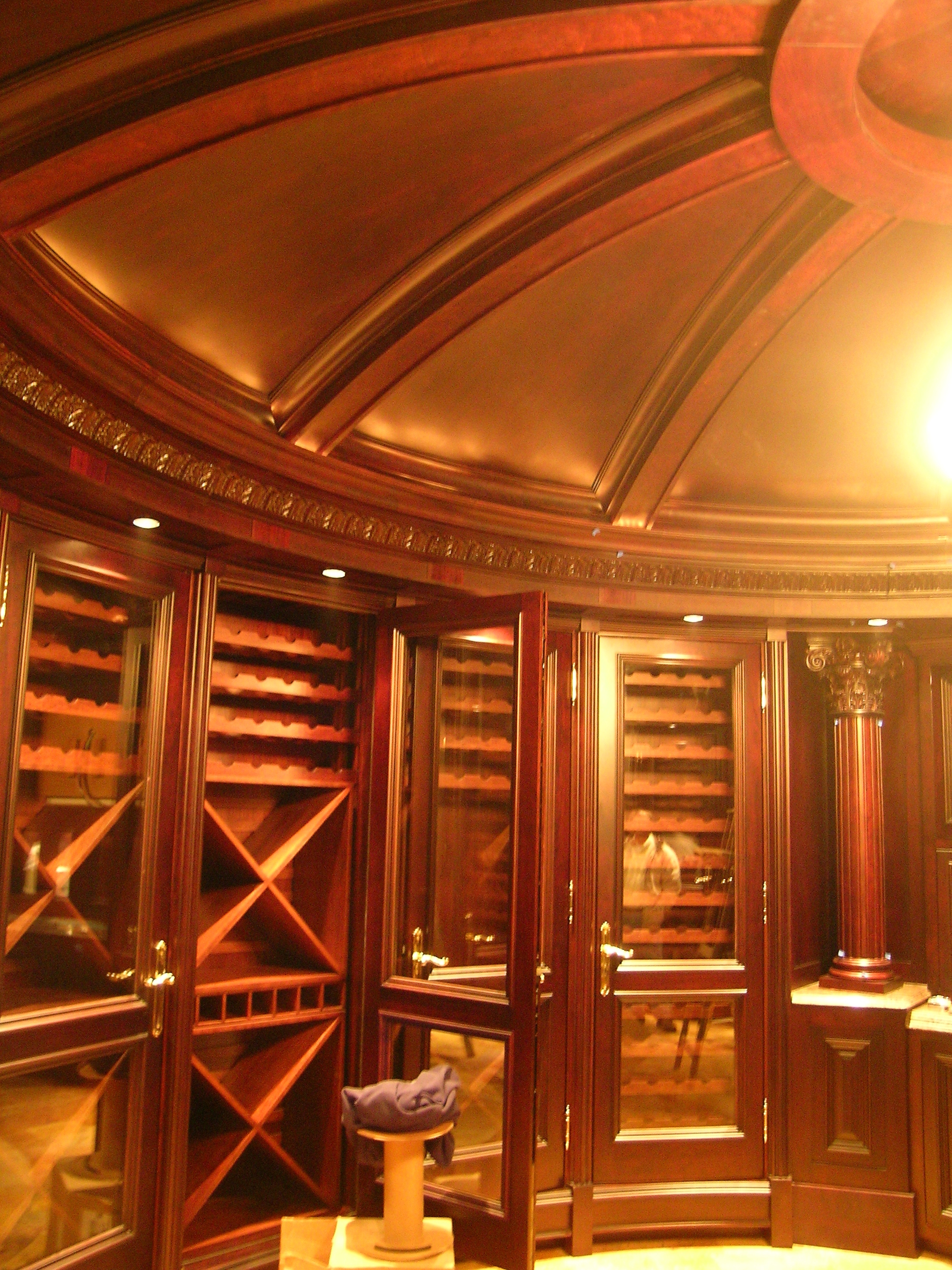

Dave Sochar Member
We have done a few large humidors, and the equipment went into the enlarged toe space on one, and above the top - in the Cornice on another. Then there was the 32' diameter wine cellar with a humidor. As you stated, weatherstripped door, isolated walls and back, all wood to be Cedrola and unfinished. Get a good hygrometer and good components. Let an expert spec the things you are not familiar with, then make it work.
The photo is a humidor amidst 11 wine cabinets that make a 32' diameter room. The cabinet is about 7' tall, 30" wide and 24" deep. A few drawers, tilted shelves, box storage, etc, and there is more smoke in there that an Prince Albert's place.
