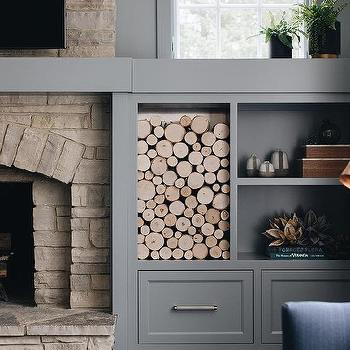

Hi ,
I have an upcoming job doing a built-in around a fireplace. Part of the built-in features a large, open-faced cubbie that holds firewood.
The casework for the built-in and cubbie will be most likely be painted combi-core HDF. I am trying to figure out a good way to protect the inside of the cubbie from getting beat up and scratched from the fire wood.
One idea I had was to apply 1/2" wide strips of 1/4" thick black painted steel on each inside face to hold the firewood away from the painted finish of the plywood.
Any other ideas would be appreciated. Thanks

Have a local blacksmith/fab shop make you a simple wrought iron square stock liner that slips inside the opening and holds the firewood off the carcass. Pretty much what your talking about. Cold rolled square bar stock would work but some hammering/wrought may be a nice touch.

While I hate the stuff, this might be a good application for Plastic Laminate. HDPL is easy to work with and the proper color should be easy to find.
I would also make a plea for using real wood for all the obvious reasons. As this piece ages, real wood can be touched up and repaired, and will gain value. Whereas man-made board only gets worse in time.

Have a thin gage stainless steel or copper pan made to fit inside the entire space. Remind them that firewood is the perfect way to introduce carpenter ants, spiders, termites, and powder post beetle into the home. Bugs come back alive when they come into a warm home in the winter, and even eggs buried in the wood will hatch. Suggest they only bring in bark free, sterilized fire wood for the decoration and other firewood stored outside for a real fire.
