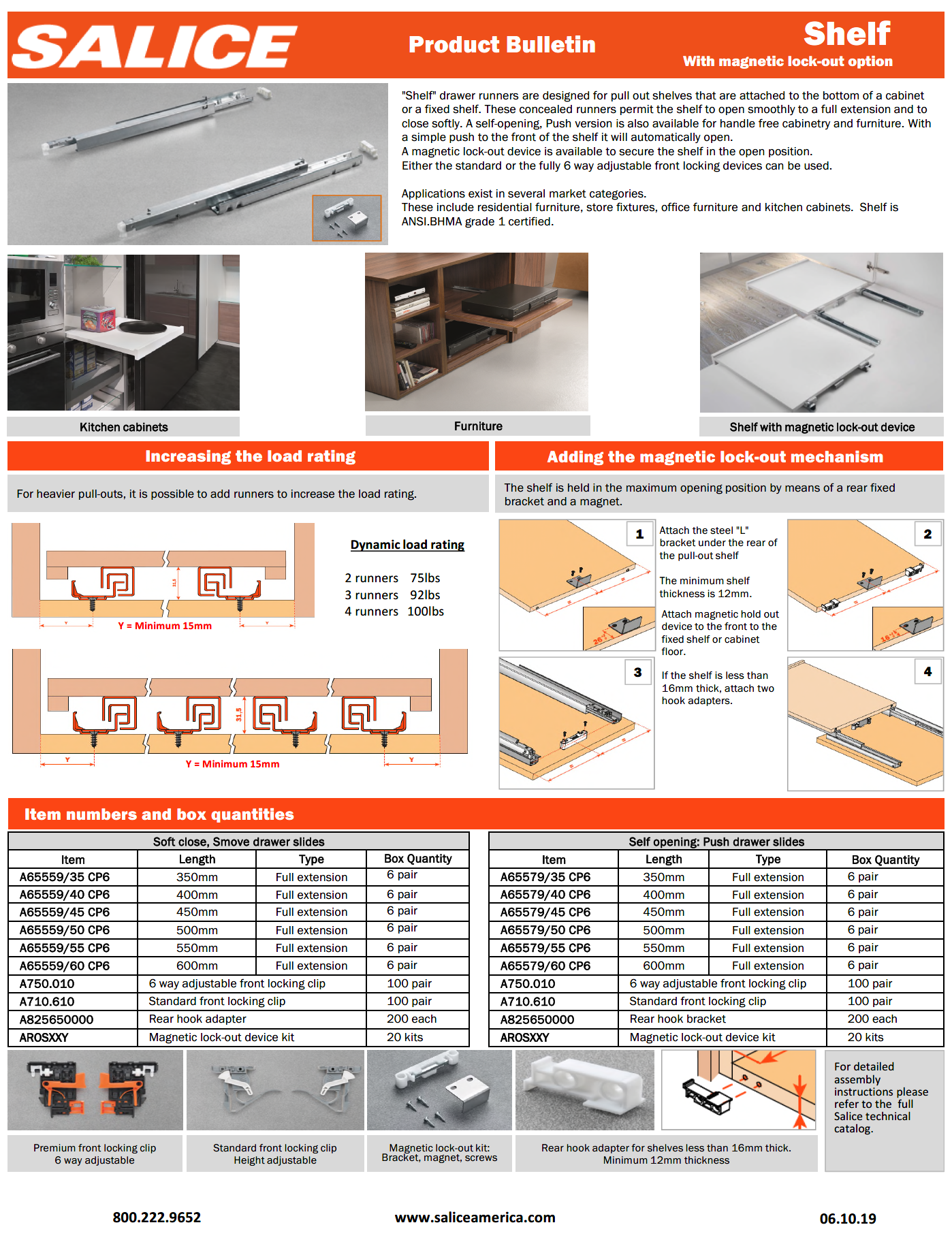

Hello David,
Salice offers a slide made specifically for this application. Coincidentally, it is called "Shelf". This mounts similar to your typical undermount with the exception that it is not dependent on the cabinet side.
Two slides offer a 75lb load rating while using 4 brings the rating up to 100lbs, dynamic. This would be close to a 150lb static rating. The 40" width would not be an issue. There is no racking.
Shelf is full extension and is available in soft close or "Push" to open. There is also an optional magnetic lock-out kit to prevent the shelf from drifting back into the cabinet while in use.
Shelf is available from Salice distributors nationwide.
Here is a product bulletin for shelf and the link to our web page for this.

View higher quality, full size image (1398 X 1824)
Salice Shelf Drawer Slide
