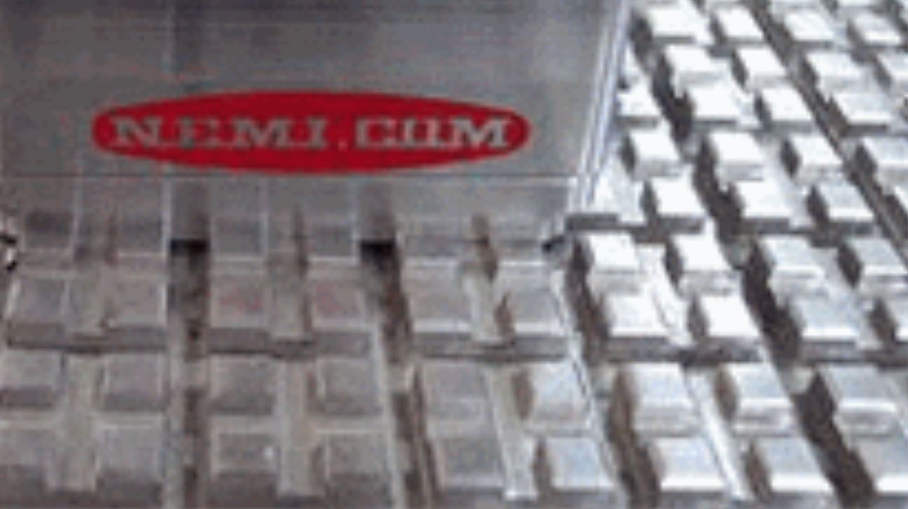

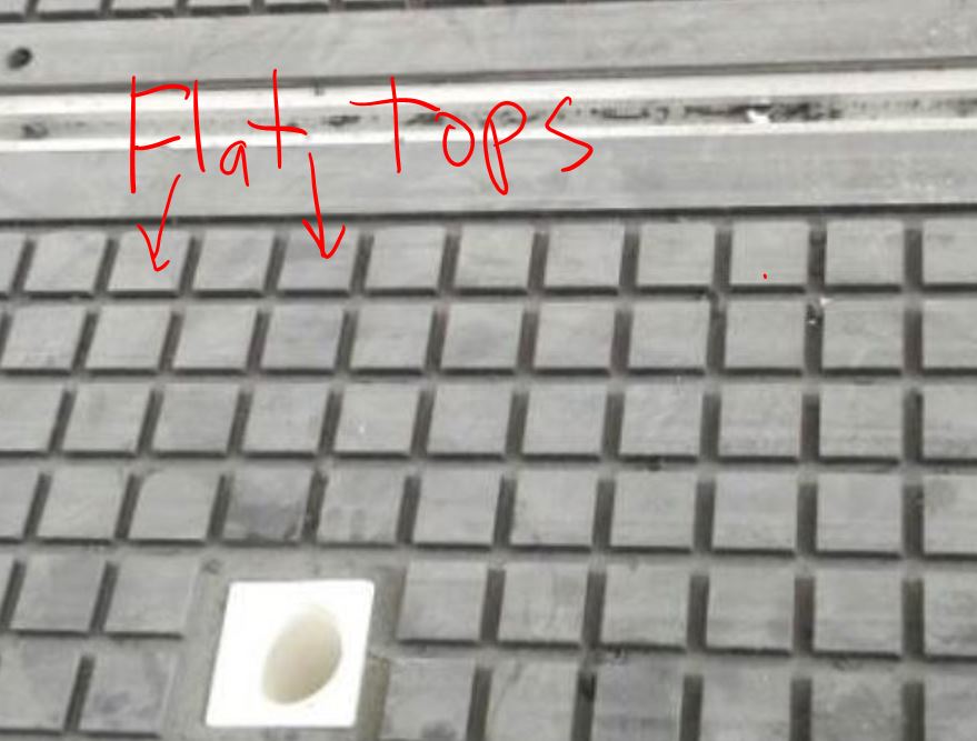

I notice that on some CNC mfrs vac table grid pattern they do not leave the square space between the gasket grooves flat, but rather cut a groove in them. Nemi has this on some fixtures and some others on full tables.
Does this give more vacuum power since vac power is a function of surface area and by cutting a groove you are opening up more empty space surface area? If not why do they not leave the squares full?
We are getting ready to cut the grid pattern in the new phenolic board on our router. Wondering if it would be worthwhile to also mill grooves in the squares to increase the amount of empty space under a fixture being sucked down.

Any thing you do to match or exceed cfm pull flow will be nothing but good
2/16/17       #3: Vac Table - SQUARES with grooved re ...
It is your preference, but the grooves only need to be cut in the squares with a hole to access vacuum. Flow through the grid will be enough to hold fixtures or parts if you pump is pulling sufficient cfm.

Yes, the Biesse table has additional grooves to facilitate the even flow or distribution of vacuum. In addition the table is a manifold design, ie a sandwich that is machined from the bottom side to create a chamber to hold additional vacuum. This typically allows for less vacuum HP, although more is best. My suggestion would be to consider the correct gasket and build the table around the gasket. The UXR-25-312 is the most popular one we sell and can is most cases increase the overall Hg by .5 to 1 bar. Its inexpensive and as stated above any grooves internal with the proper seal and right pump will create a good hold. If V grooving you will need to spend a little more time debating between surface support and even vacuum distribution.
https://www.cnc-tool.com/cnc-gasket.html
