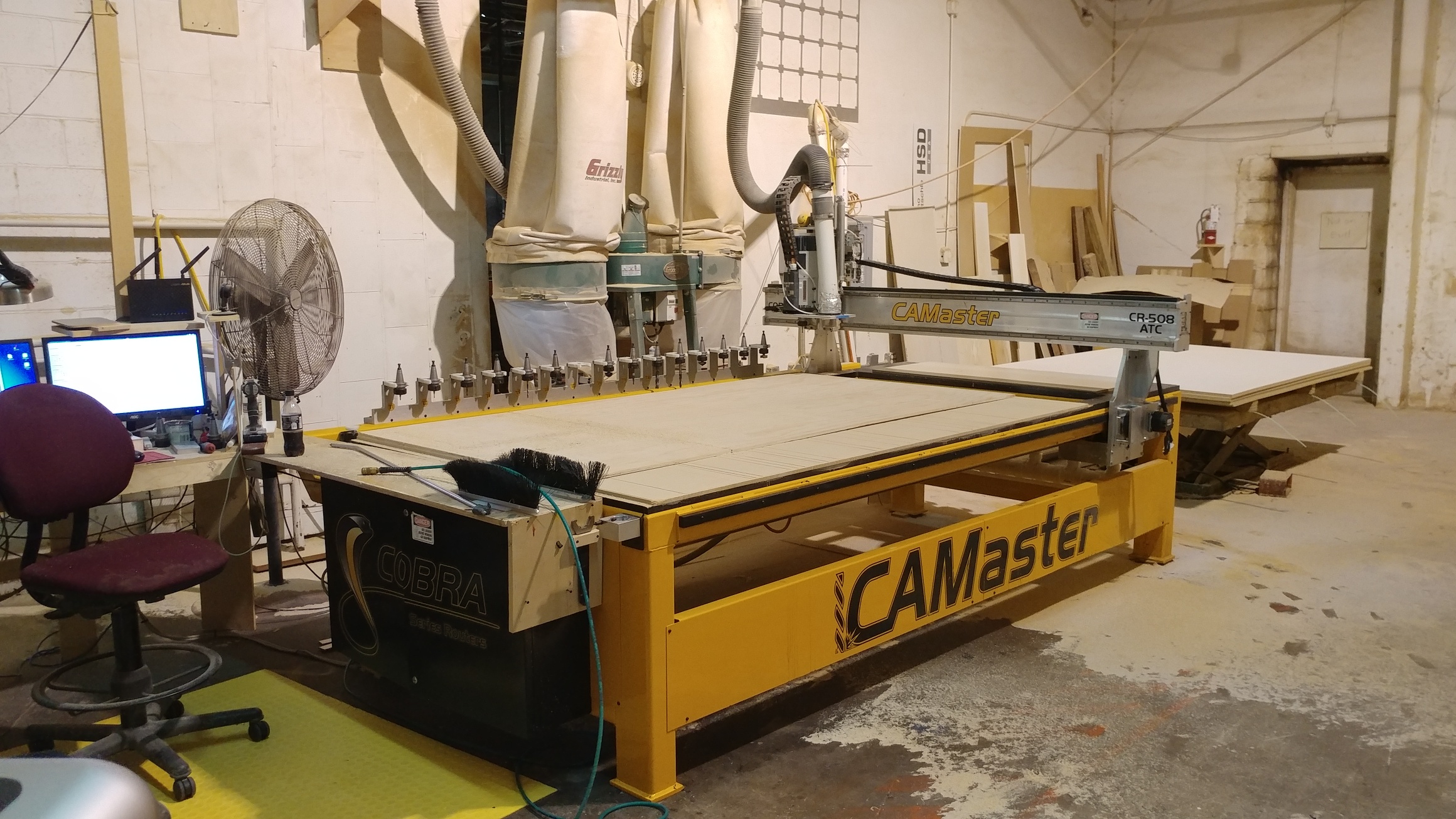

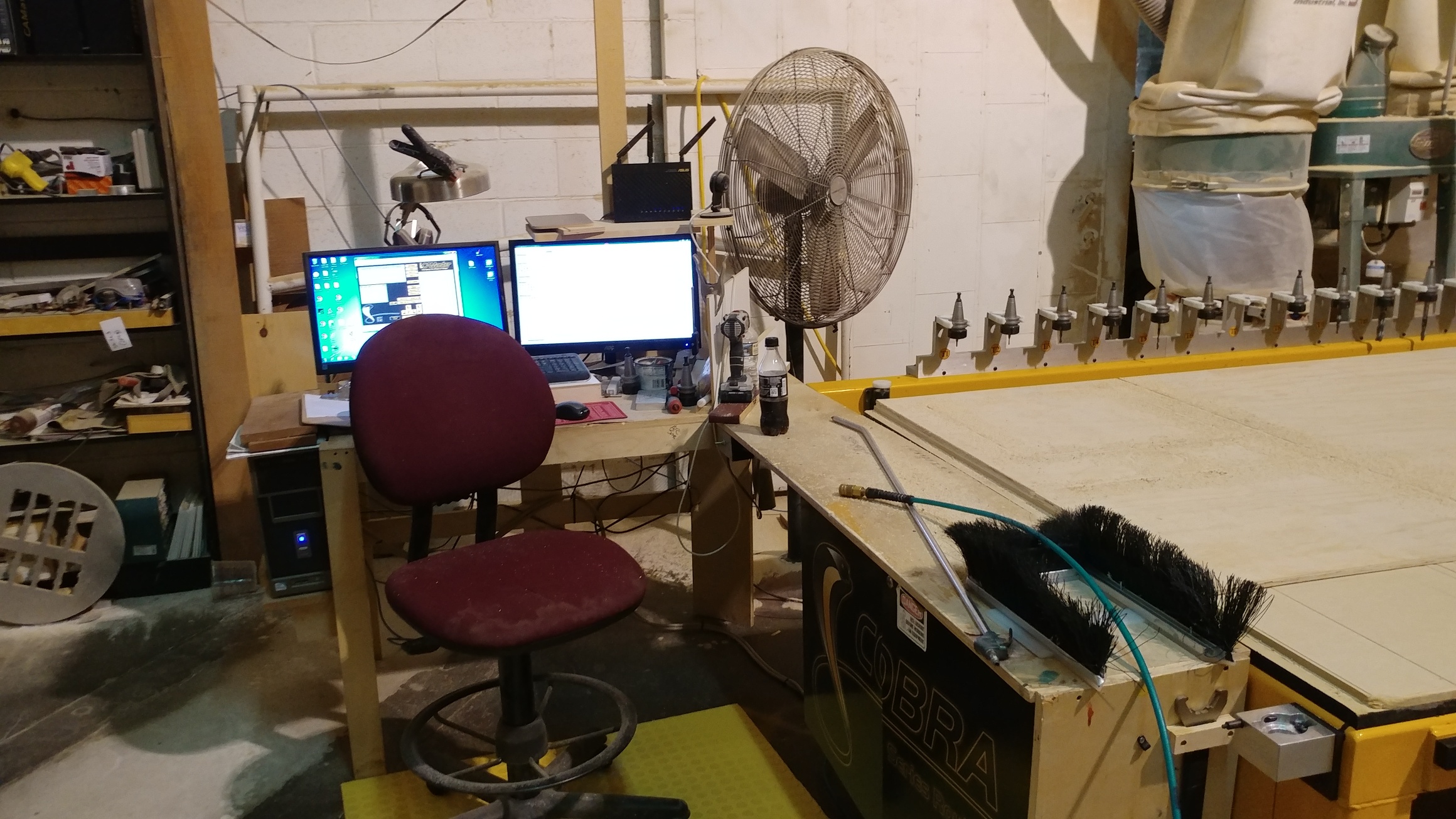

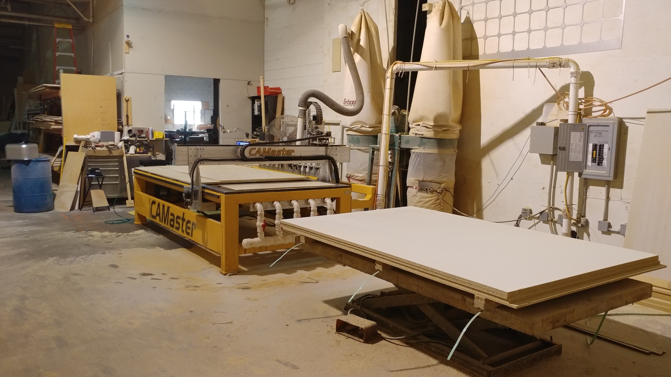

This machine (my 5th of 6 Camasters) has run daily since 2012, No breakdowns of any kind other than operator error,
CAMaster hasd s support forum with a good 2-300 on it at any time and thousands who have the machines, company tech support is life time and all parts are generally available in 24hours or less
View higher quality, full size image (2320 X 1305)
