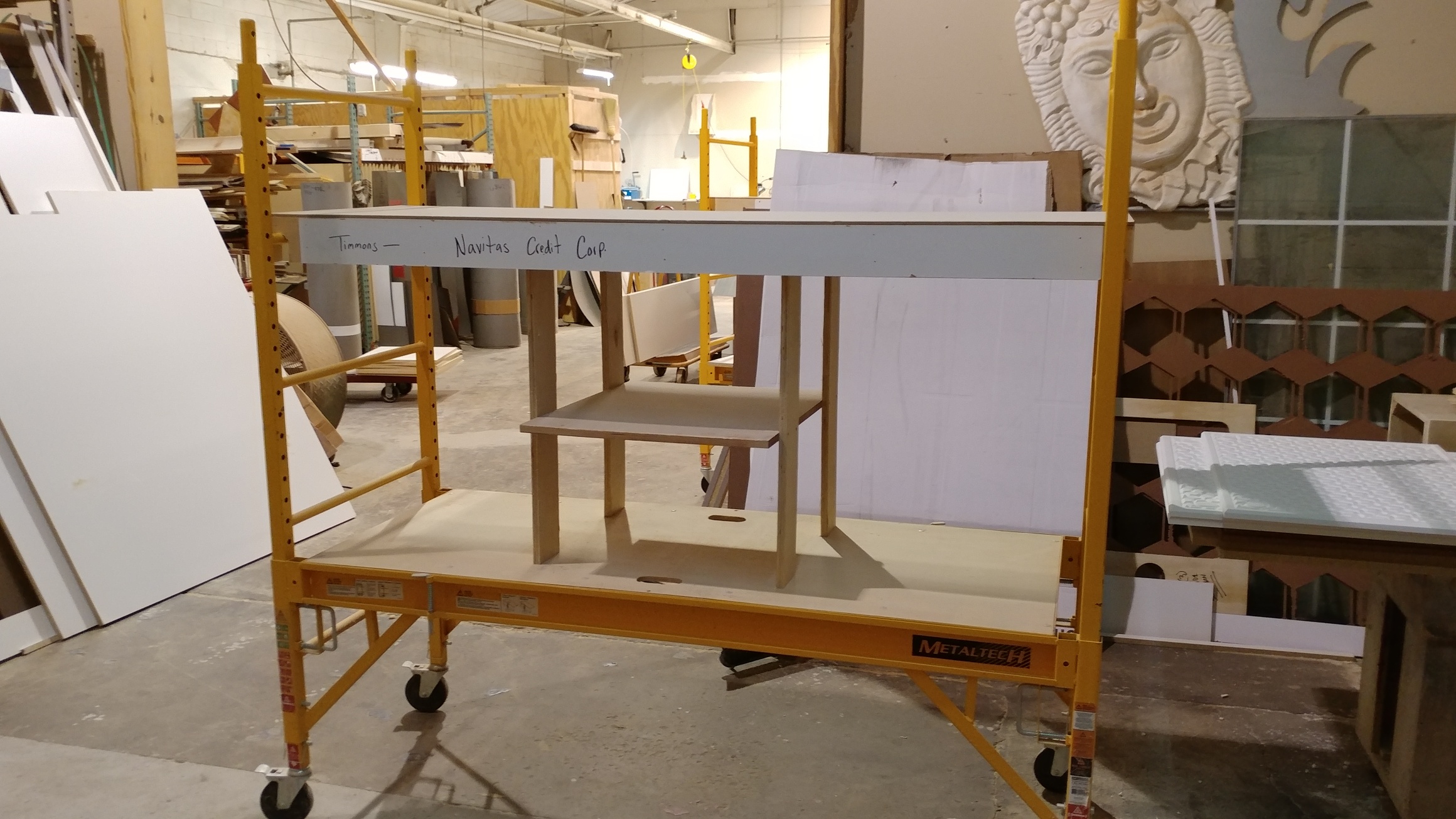

Shop silly photo by some shop silly Guys, But you can see the $150.00 bakers scaffolds we use where we made an extra shelf and put dividers in with shop ply. worked with these for years

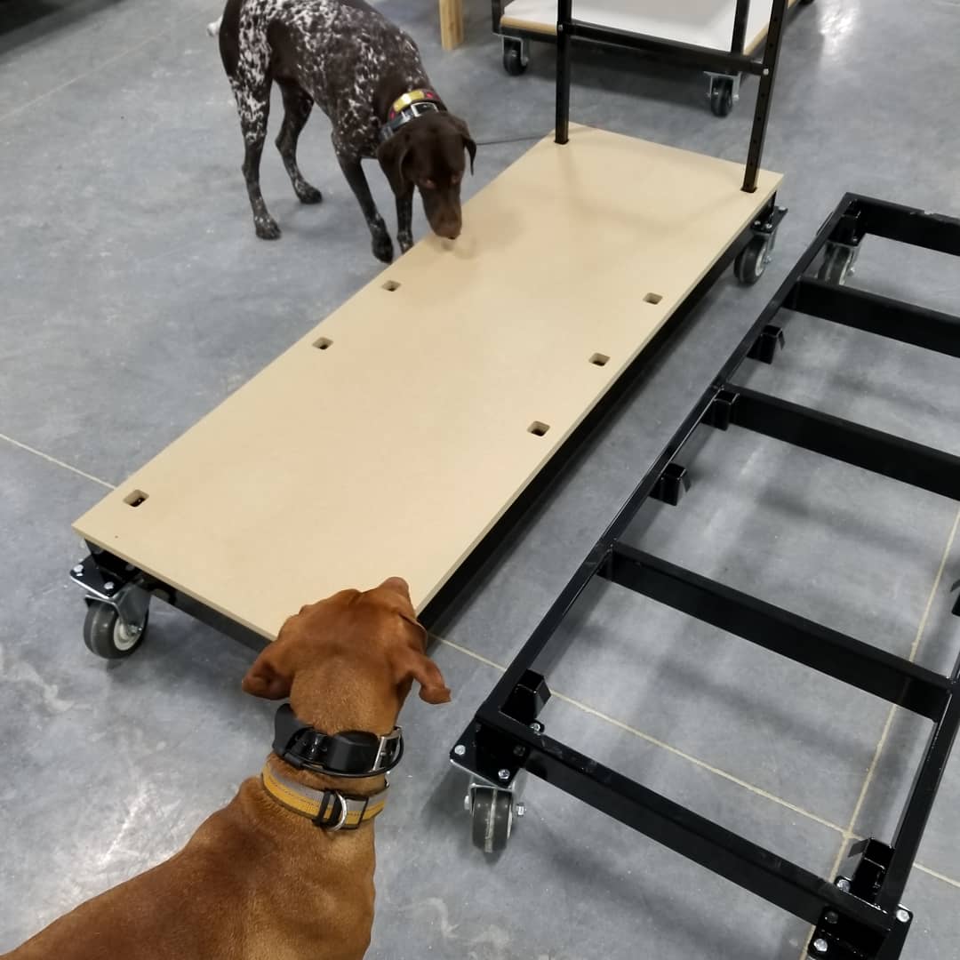

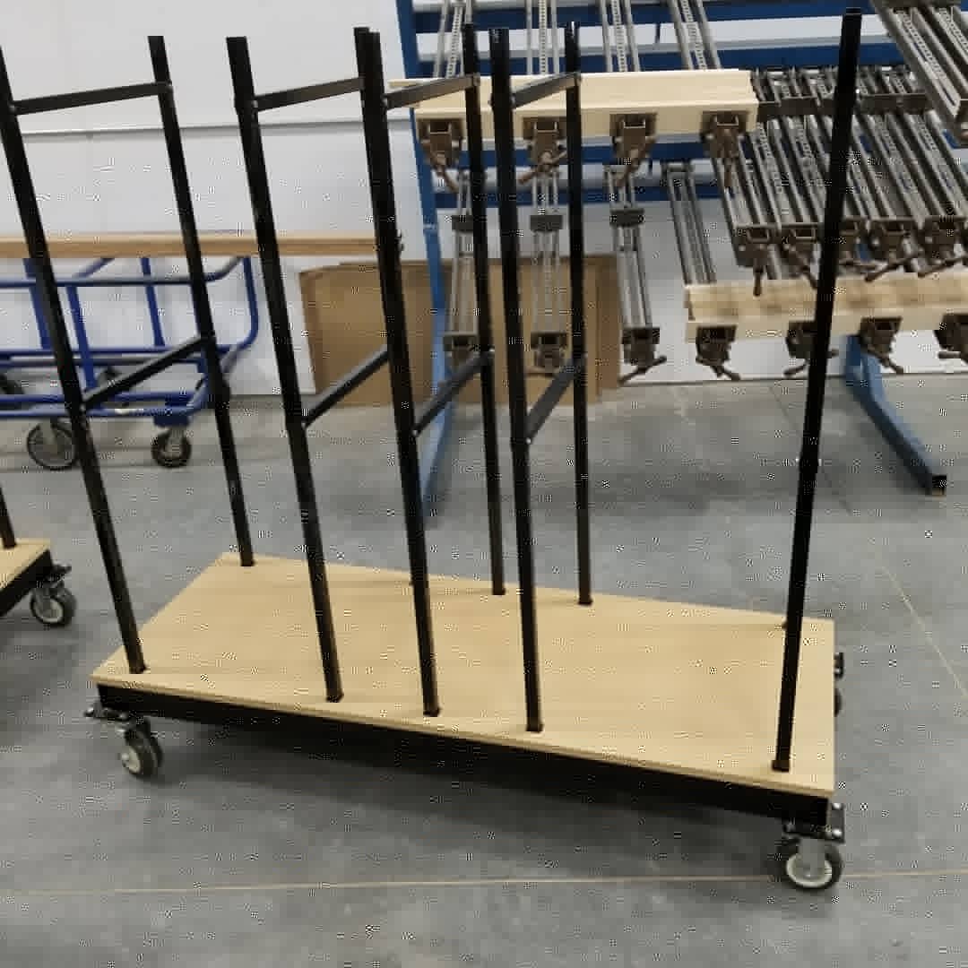

A buddy of mine works at a big metal fab shop and I traded him some woodwork for carts. We copied the Hafele design.
I park them just outside the light fence and stack up parts grouped by cabinet, in order.
I don't know if there's a perfect solution that doesn't require massive capital investment but this is relatively cheap and has been working okay for us.
