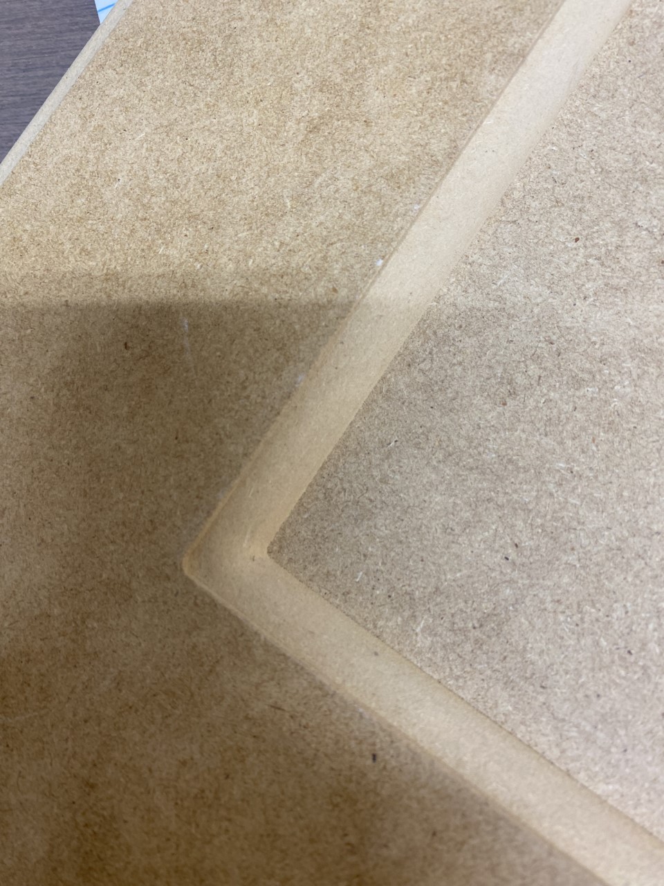

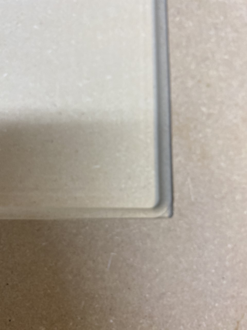

how i can get sharp corner on mdf inside corner

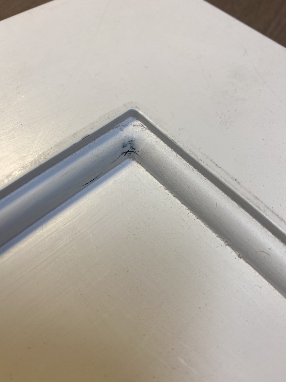

first picture show my doors two next one sample door from customer
any hint will help

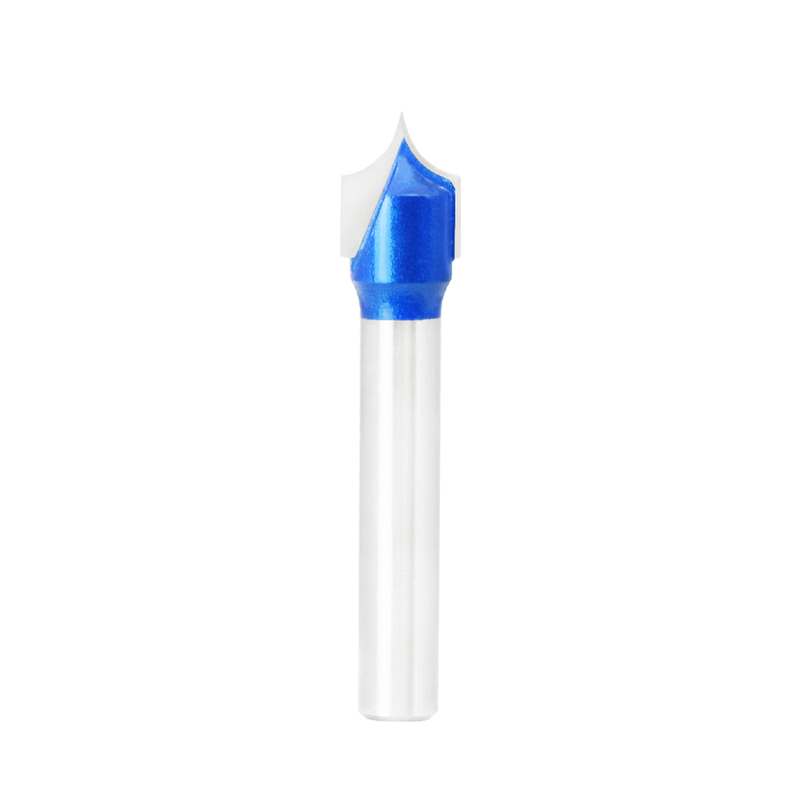

oo for profile cut I'm using
Amana Tool RC-2480 CNC Insert Nova System Bead Plunge Form for MDF and Wood Cabinet Doors 25/32 D x 23/64 CH x 1/2 Inch SHK Router Bit

There are cabinet door modules in CAD/CAM software packages for creating that corner. I'm pretty certain Enroute has one. It's always been my understanding that the software generates a 3D toolpath with a small diameter core box bit. I've never used one of those modules though so there is some speculation in my response.
12/23/21       #3: mdf 1/4' round door ...
The software I had used a canned program and a V bit ramping out at a 45 degree angle.

I cannot tell from the pictures you posted but typically these doors are produced using a beading tool. Which is similar to a round over router bit but it comes to a pretty tight point. Usually around 0.03" diameter at the tip. The radius at the top is then "squared up" with a 1/8" or 1/16" diameter router bit. This doesn't create a perfectly square corner that you would get from a 5 piece or mitred door but it's close.
It is also possible to do this with a ballnose tool as others have suggested. The drawback to doing it this way is not all software supports that function and it will take longer to clean up the corner. I would try to steer your customer in the direction of using the beading tools.

I don't particularly want to burst any bubbles here but the very small radius above the quadrant moulding is only likely to be produced by using a tiny tool that matches the radius,You can see the roughly triangular feature that was cut using the small tool after the tool similar to that shown in post #4 was used.Would I be correct in believing that the material inside the quadrant section was pocketed out too?

Most use a 1/8 Día Solid Carbide Straight bit to get in the corners
