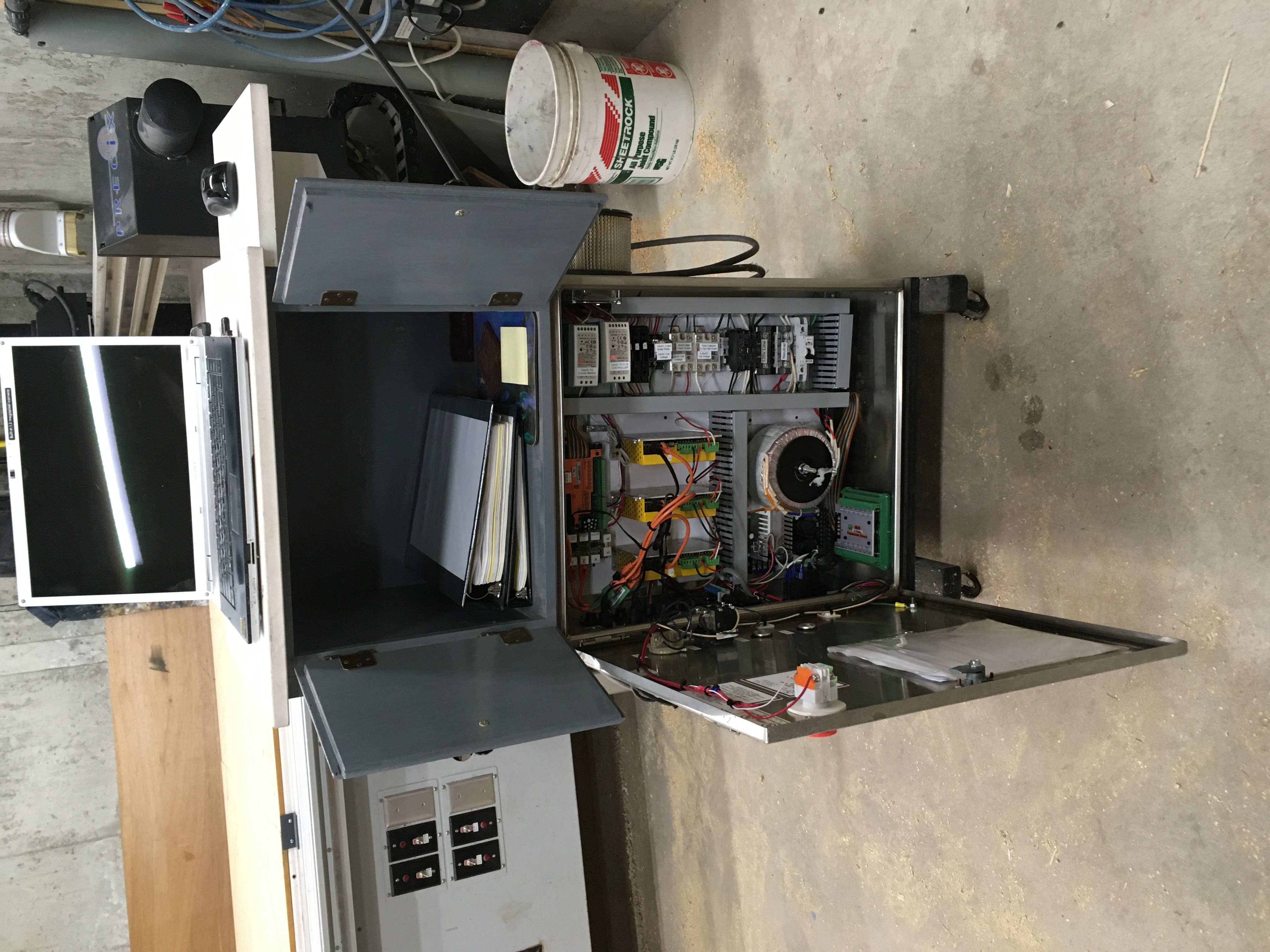

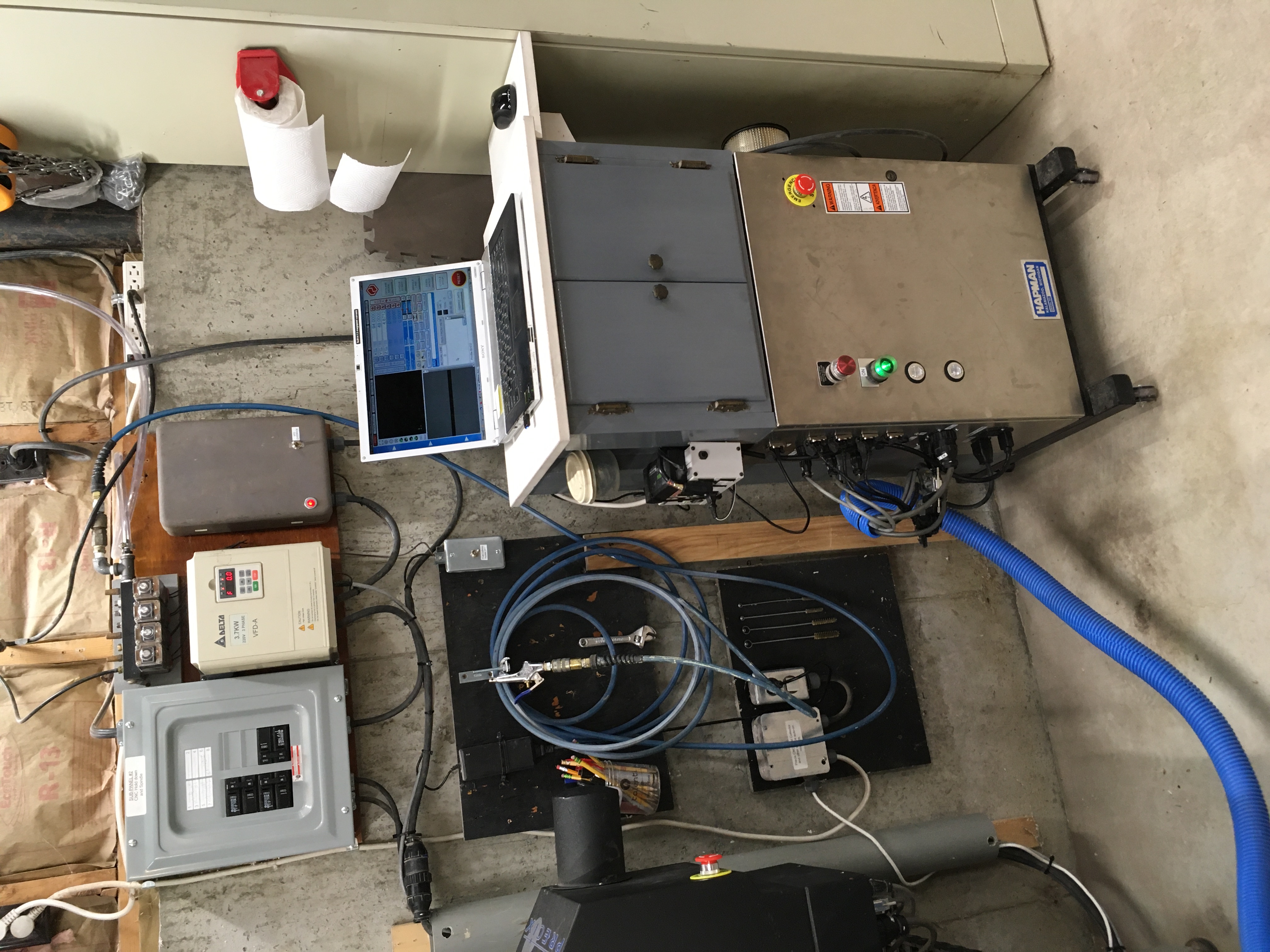

Are you interested in building a new control yourself? It took a long time but I built a new control for my early 2000's Precix router. I used CNC4PC for the parts and guidance and UCCNC for the control software.
Other than learning how to tune the servos it was a pretty straight forward electronics project.
