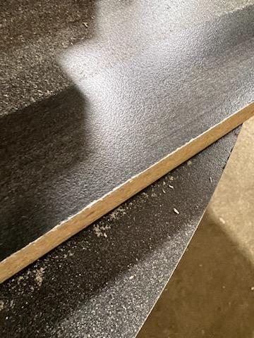

Good Afternoon!
Recently I have had a couple customers asking me how to solve some chipping problems while cutting Formica brand HPL. They are both using high quality tooling and the feeds and speeds are dialed in perfectly. As soon as they cut a different material (HPL or TFL) the cut quality is perfect. Deductive reasoning points directly at the material but I'm just wondering if anyone else out there in the nesting world is experiencing the same problem. The photo shows some of the fuzzing/chipping.
Cheers!

We use 3/8 inch compression spirals, no Chipping problems.

I'm hearing that these guys are only having problems with Formica HPL. The other brands are cutting fine. Are you cutting Formica brand without any chipping?

Just ran a bunch of Formica no problems, 3/8 comp bit. Either bits are dull or hold down is bad

We run Plam with zero problems on both cnc machines and table saws,, what and how are you cutting with

Also, is this Plastic laminate (HPL), or melamine (TFL) ?

From what I understand, it's only the Formica HPL that is causing the problem. Other brands of HPL and all of the TFL is cutting without any issue. The feeds and speeds are dialed in correctly to match the specified chip load and the tools are high quality.

Check your part spacing. I had a similar problem that was remedied by using the spacing of .515 on a 3/8comp bit.
