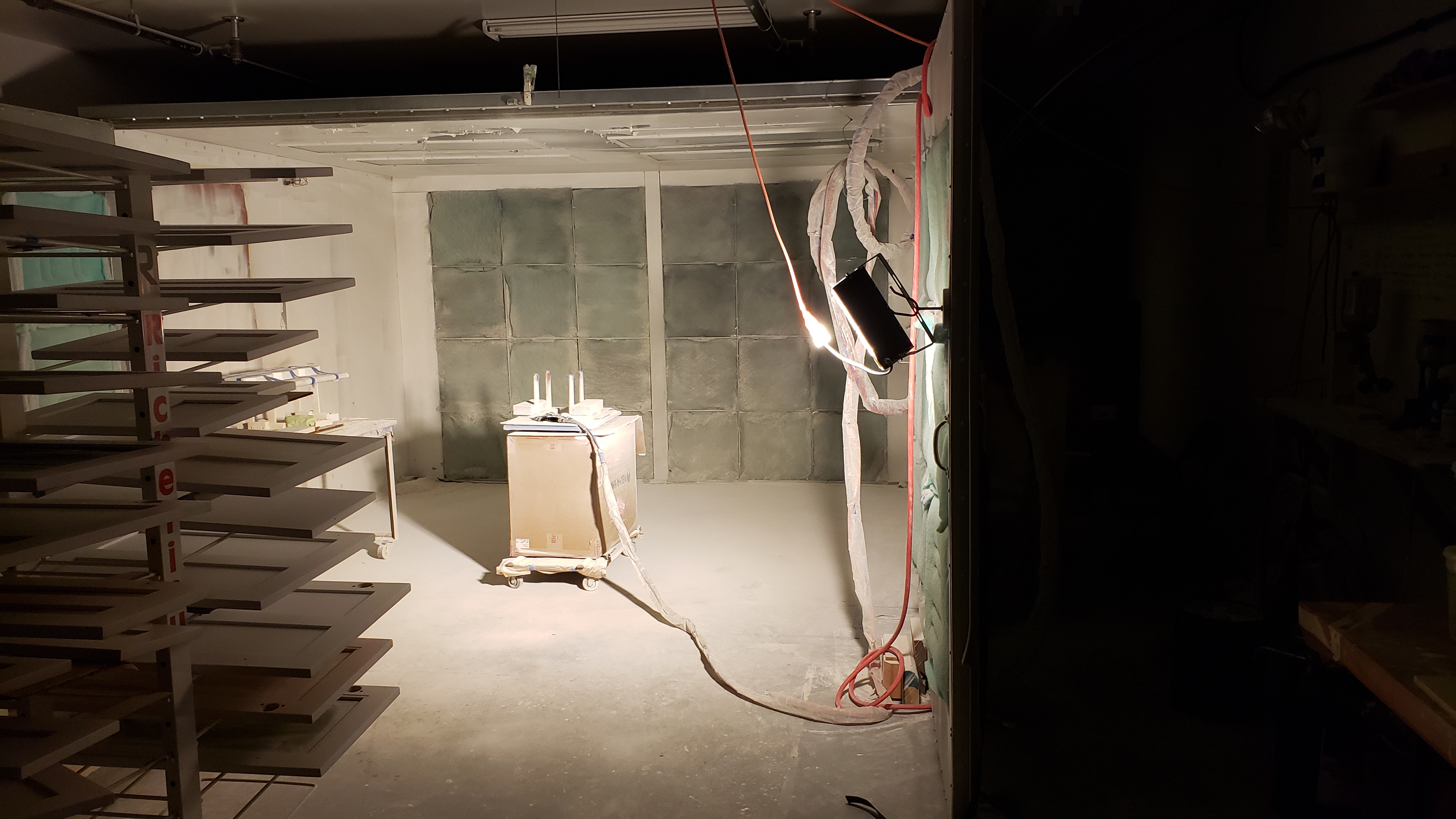

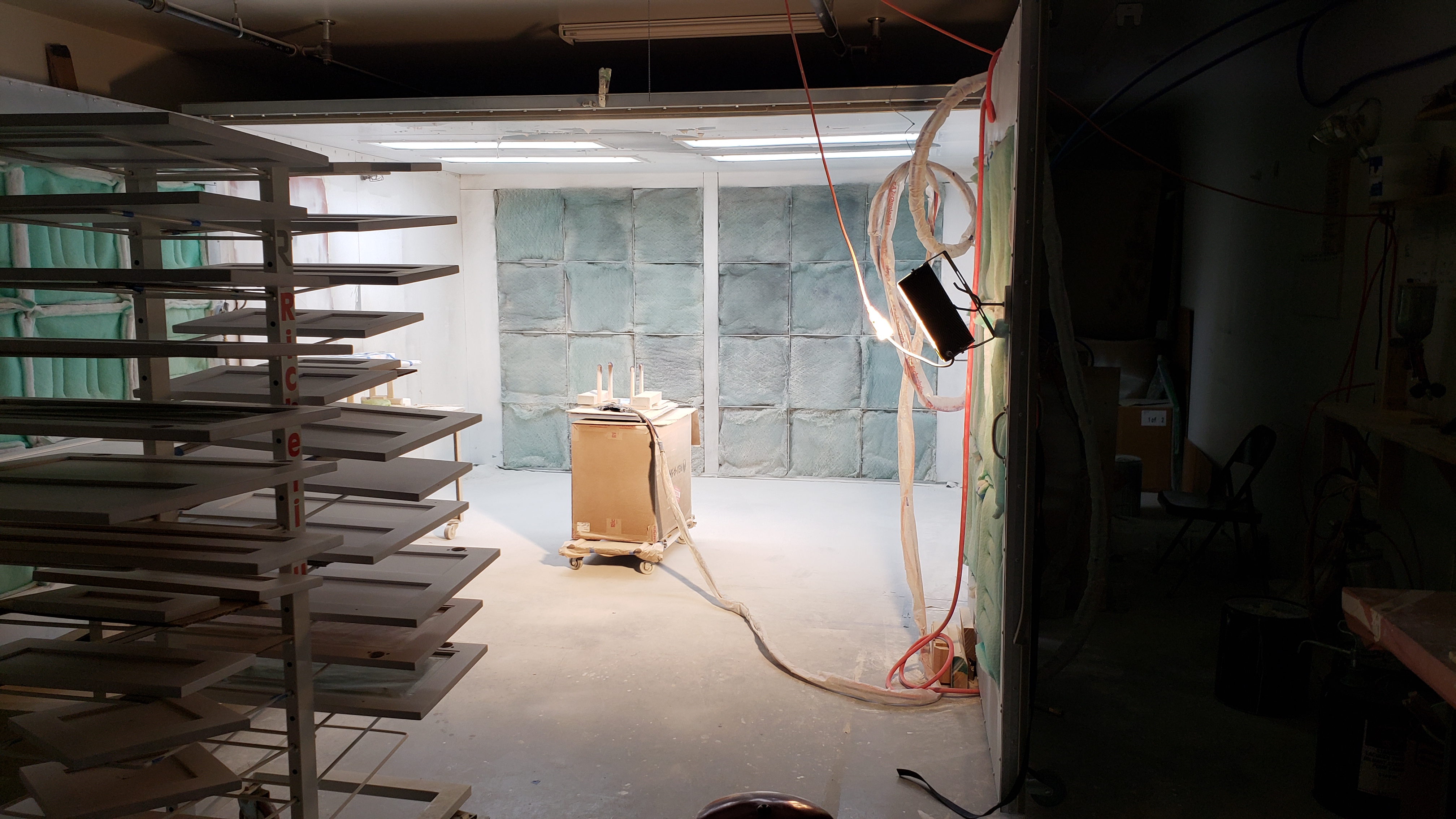

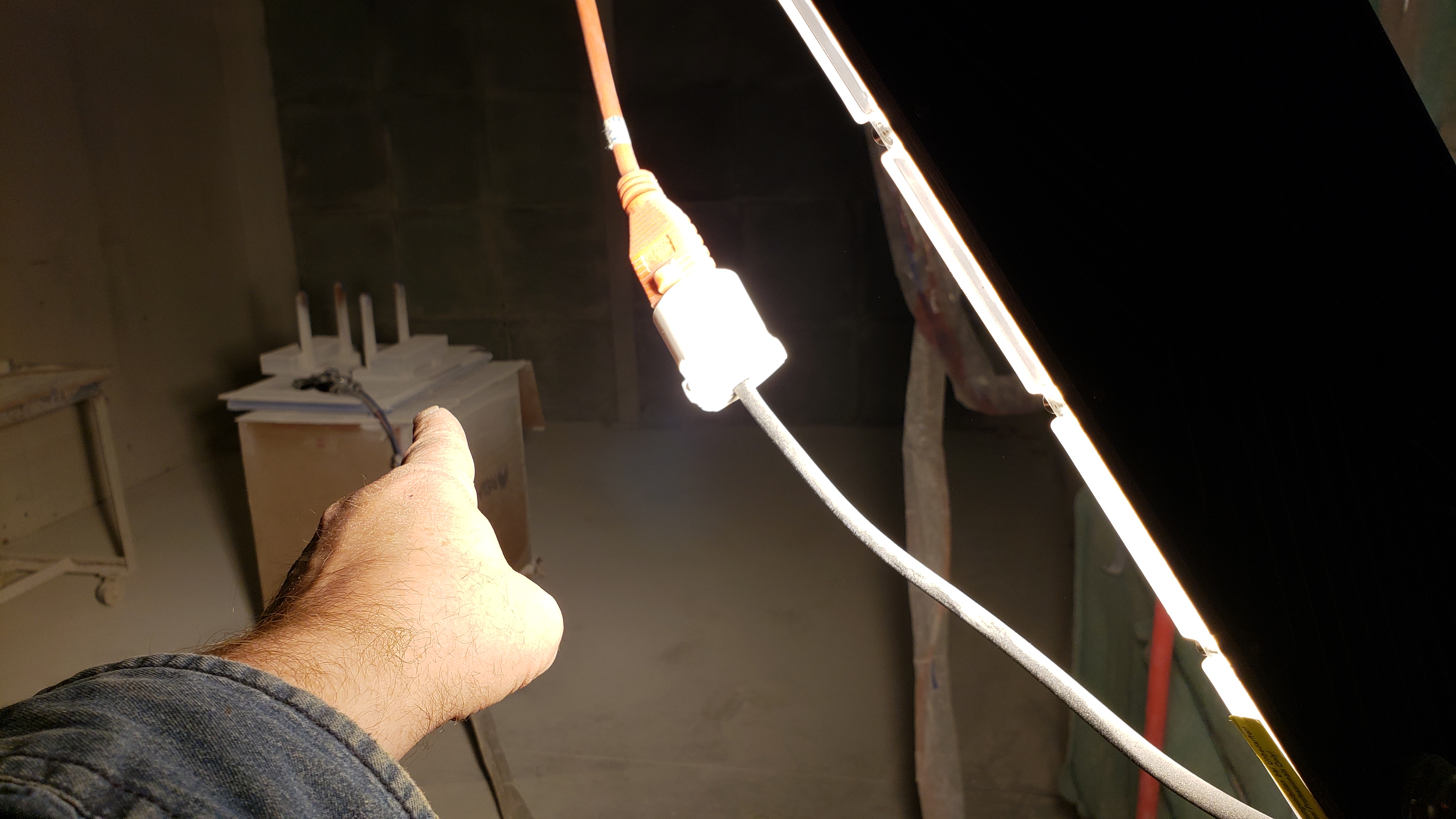

2/14/20       #6: spray paint lighting ...
dan shaf Member
Here's my lighting setup.
