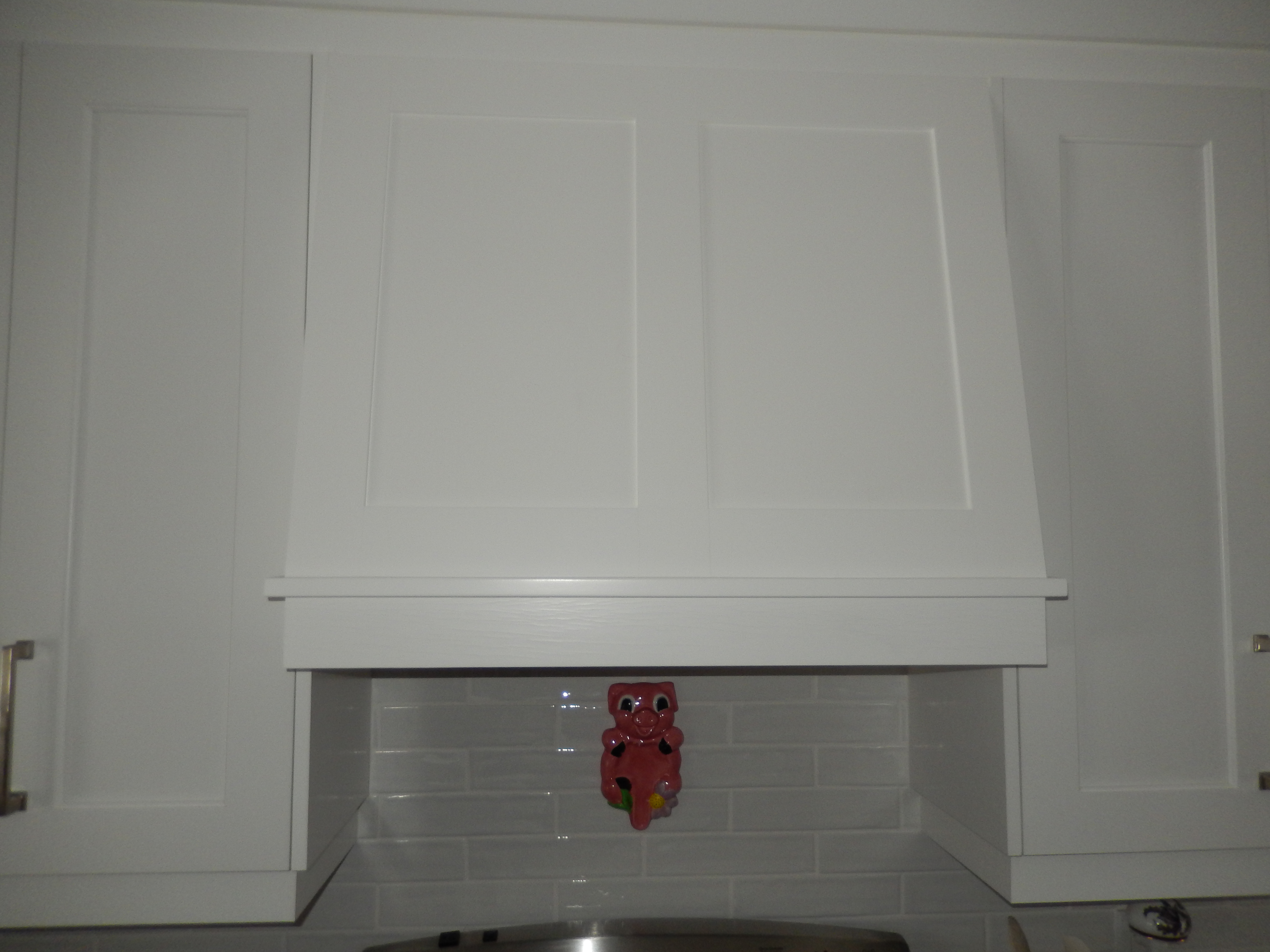

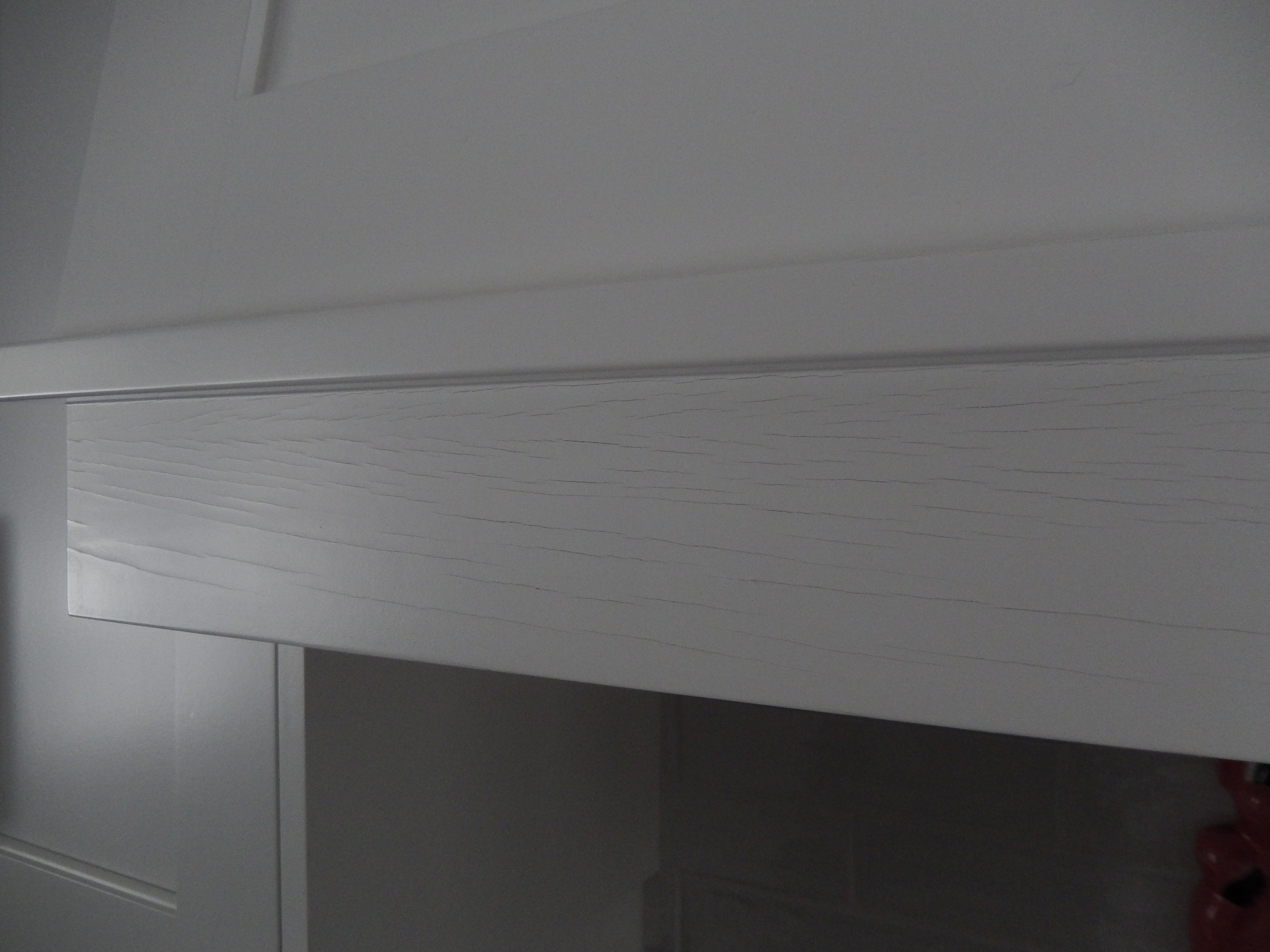

Hello All.
I received a call from a customer complaining about a cracking finish on the front of the hood vent which was installed a little over one year ago. As you can see in the picture it looks like the cracks run in the direction of the grain. I have contacted the supplier of the hood vent and their response was that the hood vent finish damage was not their fault. “It was from excessive moisture/steam coming from the stove.” I pointed out to them that the finish on the end boards and the boards inside the hood vent showed no signs of cracking. The customer has a high quality KOBE exhaust fan installed.
Questions I have are:
Why did my finish fail on this one board only?
Can this problem be corrected or will the finish always fail?
View higher quality, full size image (4896 X 3672)

It does look like paint lifting from wood grain

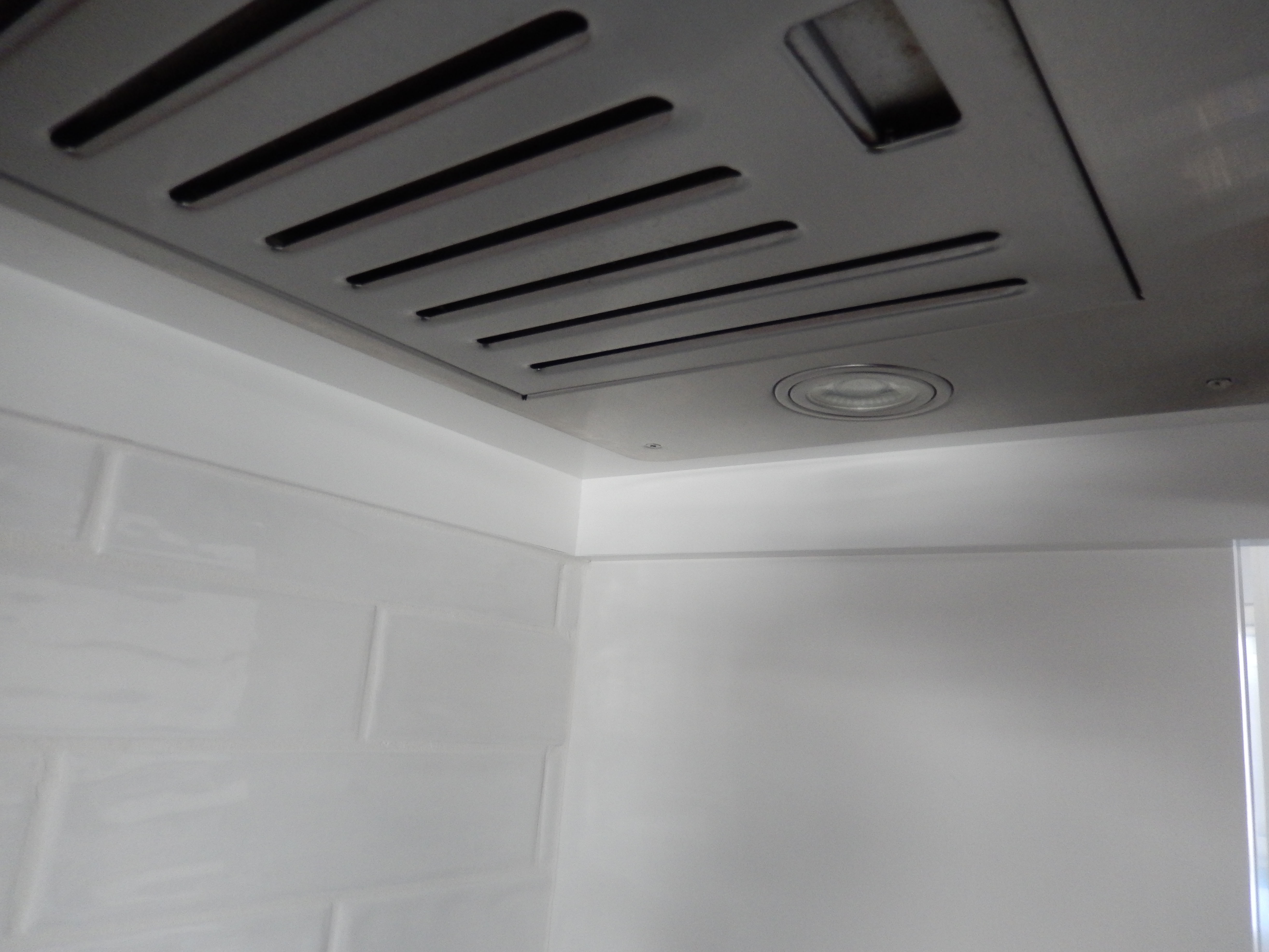

A photo of the inside would be helpful. Is there a liner in it or just a false bottom made of plywood.

I work for a builder in SC and we have been seeing this lately, usually on panels such as refrigerator panels. Is that board solid wood or veneer? I believe what we are seeing is a result of cheap China veneer core with too high a moisture content. weeks, or months after the install we are seeing what you have there. It appears to be the veneer core drying out and shrinking causing the surface veneer and finish to crack in the direction of the grain.
1/18/23       #8: Finish Cracking On Hood Vent ...
I agree with Bill. There is something wrong with that piece of material. The rest of the hood could be made from MDF. It does look like the veneer is delaminating.

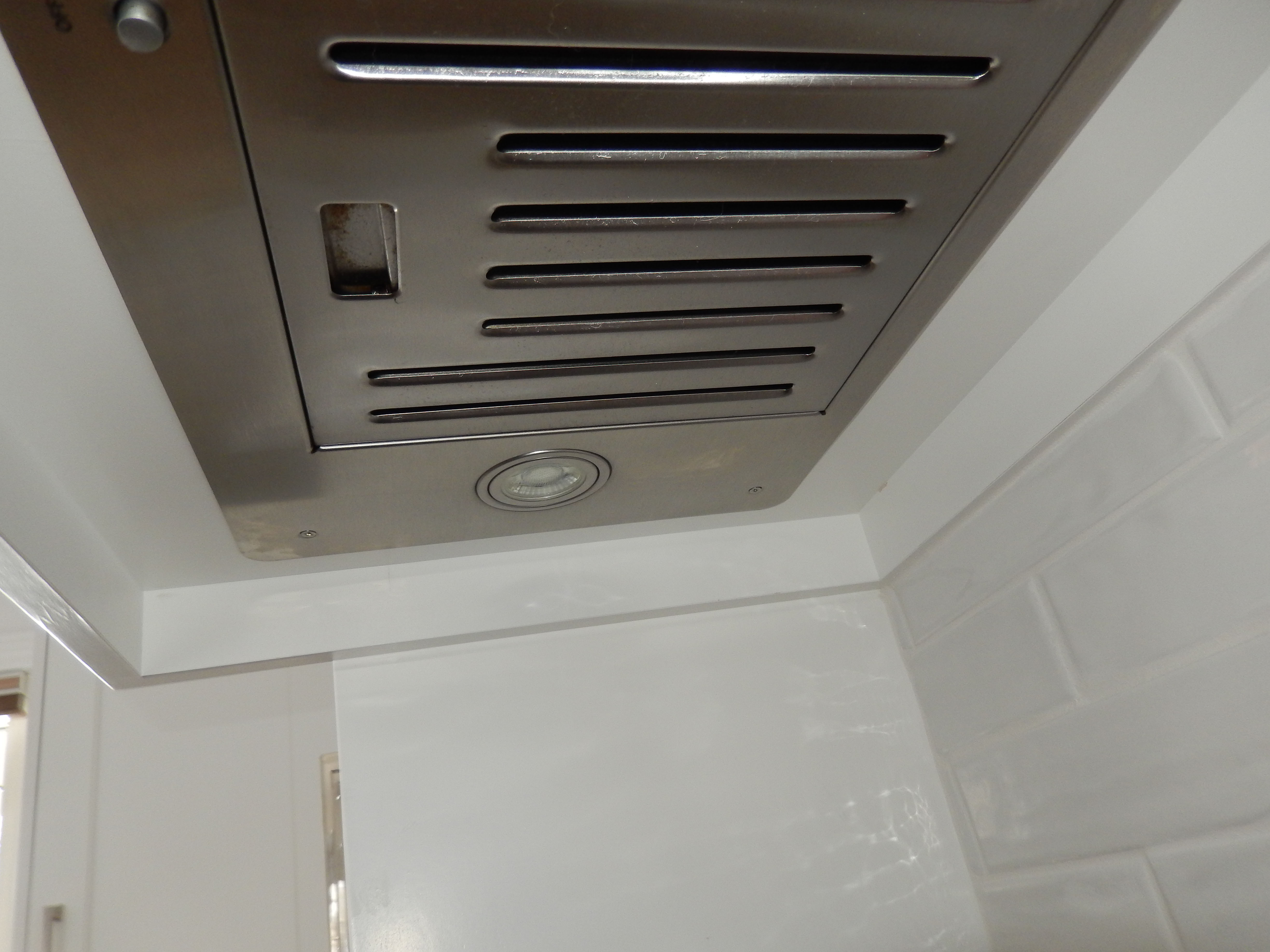

Bill and Adam are spot on. Further investigation shows that there is a basic butt joint where the front board and the side boards meet. The joint can be seen in the attached picture. The joint is covered on the front by a veneer. From everyone's experience can this veneer be sanded and refinished with the original lacquer finish? Will it be a permanent fix or will the finish crack again later.

So no linear?

No, there is not a liner. It is in essence a plywood box with edge banding veneer on the bottom The edge banding veneer is starting to loosen on the inside.

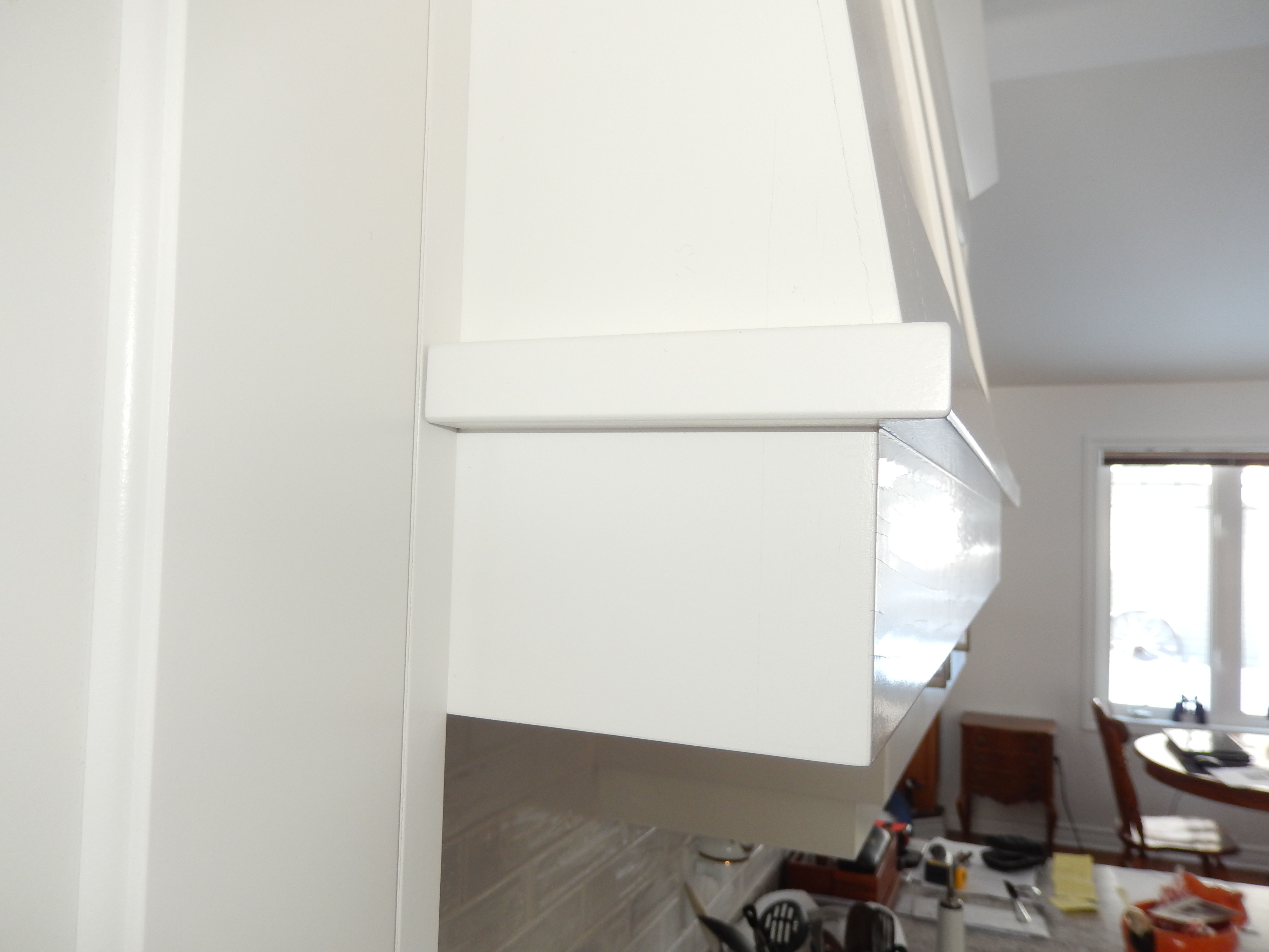

The cracked veneer on the front covers the corner joints. This veneer is cracked right down to the plywood. See pictures attached.
