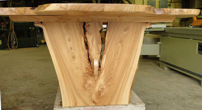

The 22" width for your leg assemblies should work fine. The 1.75" thick oak top is going to be too heavy to tip over unless there were several very heavy people sitting on the edge. You could make a couple of test pedestals with some scrap to verify.
The photo is of a live edge elm dining table I made a few years ago. The top was almost 54" wide at the end shown, and the pedestal was about 20" wide on the floor. No stability issues.
