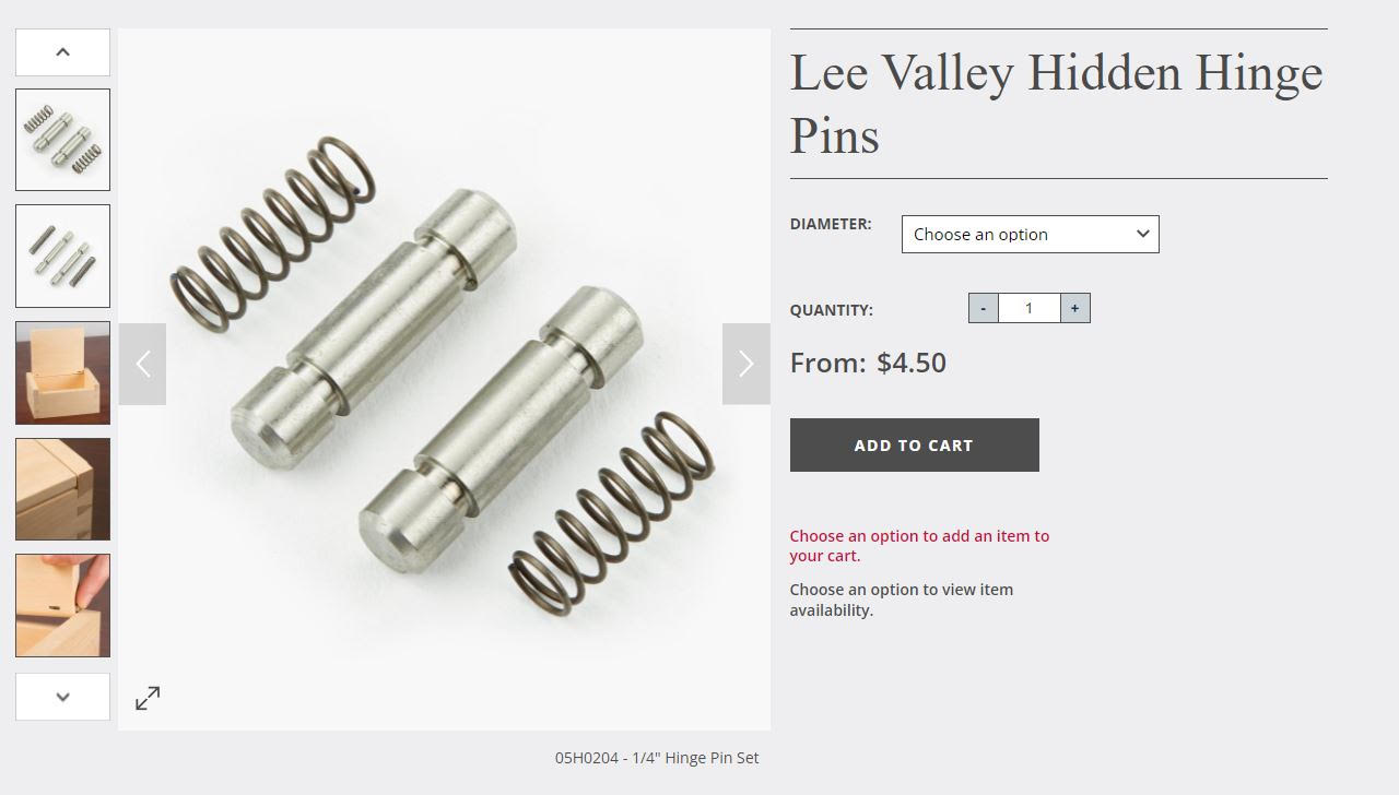

Hi all,
Currently working on a timber furniture piece that requires a similar hidden spring hinge as seen attached. However I'm struggling to locate a supplier close to Melbourne, Australia. Any alternatives or suggestions are greatly appreciated.
View higher quality, full size image (1280 X 728)
4/1/22       #2: Spring Loaded Pin Hinge ...
That would be incredibly easy to fabricate. Use brass rod and you could cut the grooves on a wood lathe. If you never want to remove the lid, you don't need the grooves.
4/2/22       #3: Spring Loaded Pin Hinge ...
And only one side really needs the spring.
4/4/22       #4: Spring Loaded Pin Hinge ...
Dave Sochar Member
I learned to make these out of wood to repair broken movable slat louvers. Easy. We raided all the retractable ball point pens we could find....
Metal and the grooves take it up a notch.
