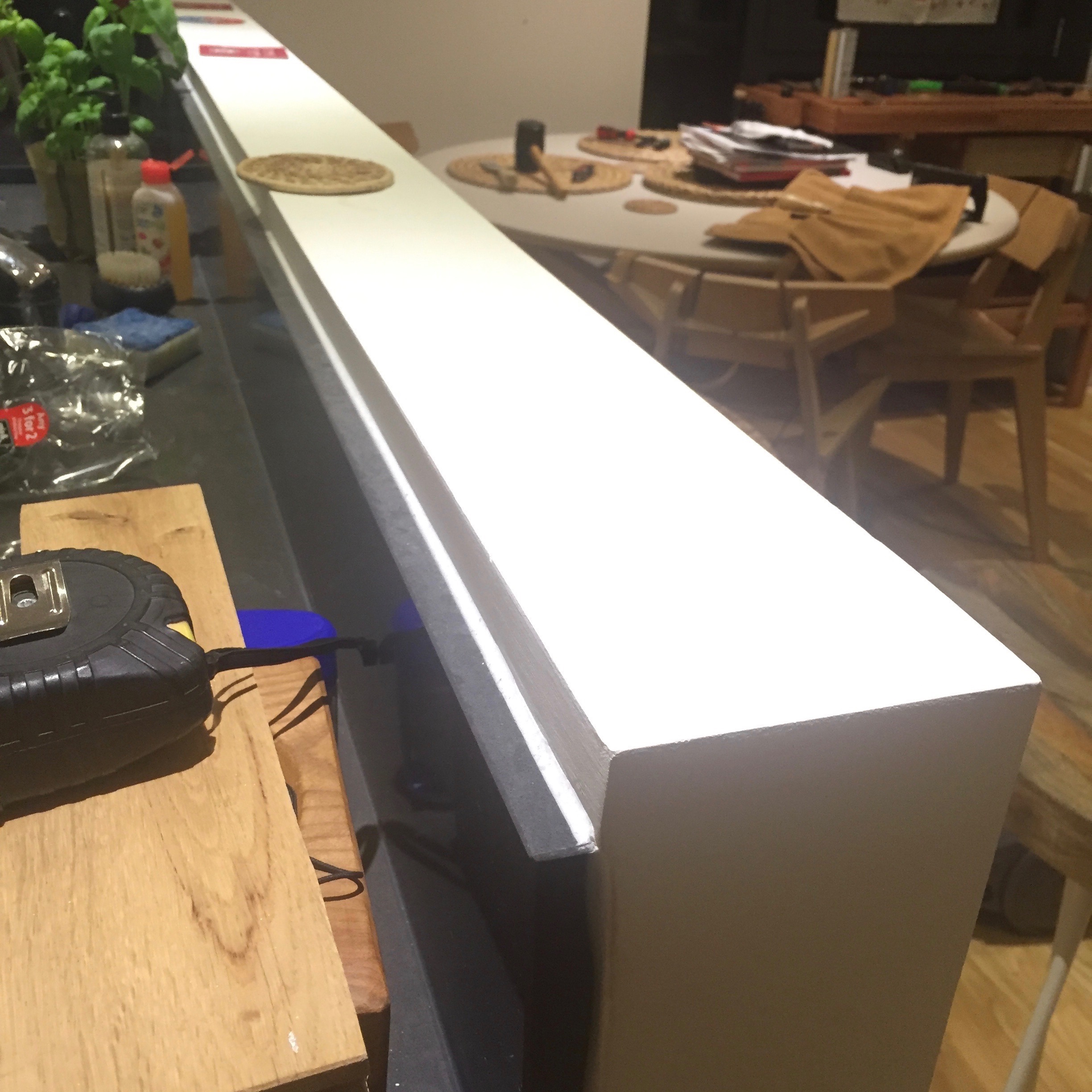

Hi,
Firstly, thanks for the informative thread so far.
Im trying to do exactly the same thing in that I need to install a wooden breakfast bar on top of an existing kitchen pony wall (worktops and units already in place).
I was planning to take off the top layer of plasterboard down to the wooden crossbeam as has been discussed here, however, i have found an added complication in my case is the wall is the thin metal stud kind rather than wood. I'm therefore not sure the top brackets will have enough purchase if I just screw them into the metal.
Does anyone have any recommendations as to how I could fit this on?
I have included a few images to help show what I am working with.
Thanks very much
