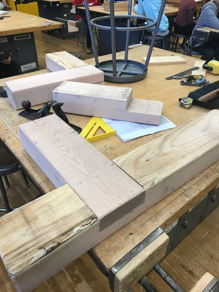

Hello,
I am trying to dry out some wood just milled 10 days ago. I'm building a rustic bar with green lumber and I have it built in my basement. Do I want to run my pellet stove or not? The bar is 8' from the stove and the room temp. can approach 80*. I have some checking on the wood, but it looks cool with the look of the bar (that's kind of the idea), but I don't want it to split into 48 billion little toothpicks. Any help would be great.

Doublewide, as we say here in the country, you've got the cart before the horse....BUT salvagable. There's proper joinery techniques for working green wood which EVERYONE should learn as they apply greatly for both green and dry woods, it's ALL about learning wood movements. Not doing a class here.....soooooooo.... PROVIDING you DON'T anchor a top to this OR learn the proper techniques to anchor for floating, your frame will survive BUT it will shrink in the basement (or anywhere else) and especially with the heat source. Timbers are slow drying due to size. I would run a fan on low NOT blowing on the bar BUT circulating the air around the room and a DHumidifier to remove the moisture...you've sealed most of the wood already, finish ALL bare spots/parts to balance the drying. That will get most of the basics. I do like the layout !!!

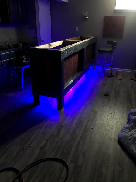

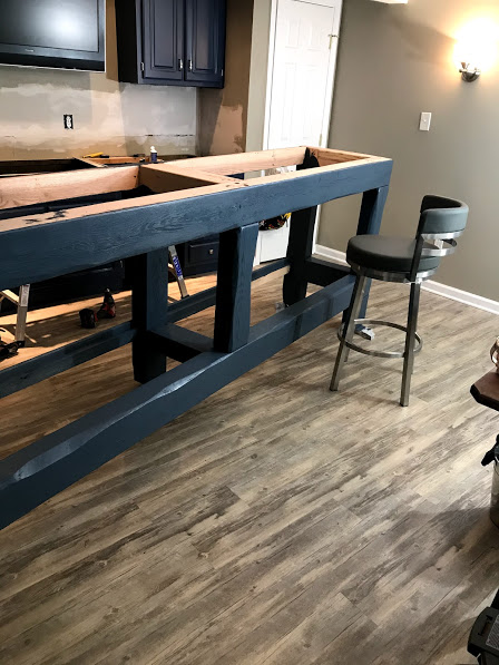

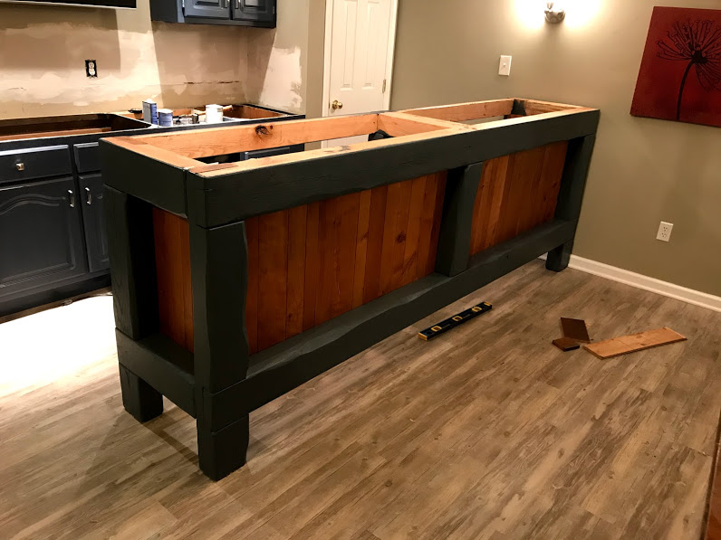

Well I'm moving ahead on this project. Everything looks fine. I know log cabins have been built for hundreds of years using green timber. It should crack a bit but still be plenty strong. I put a fan on the project and I run the pellet stove a little bit. I designed the wood joints to have some play, so time will tell what happens. Thanks for all the help. I included some updated pics.
View higher quality, full size image (796 X 597)
View higher quality, full size image (448 X 597)
