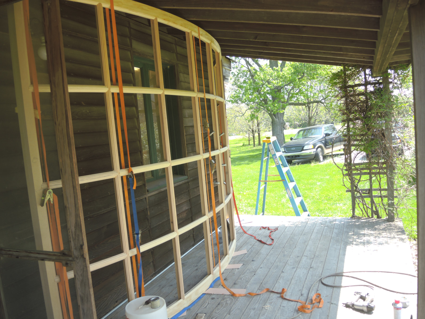

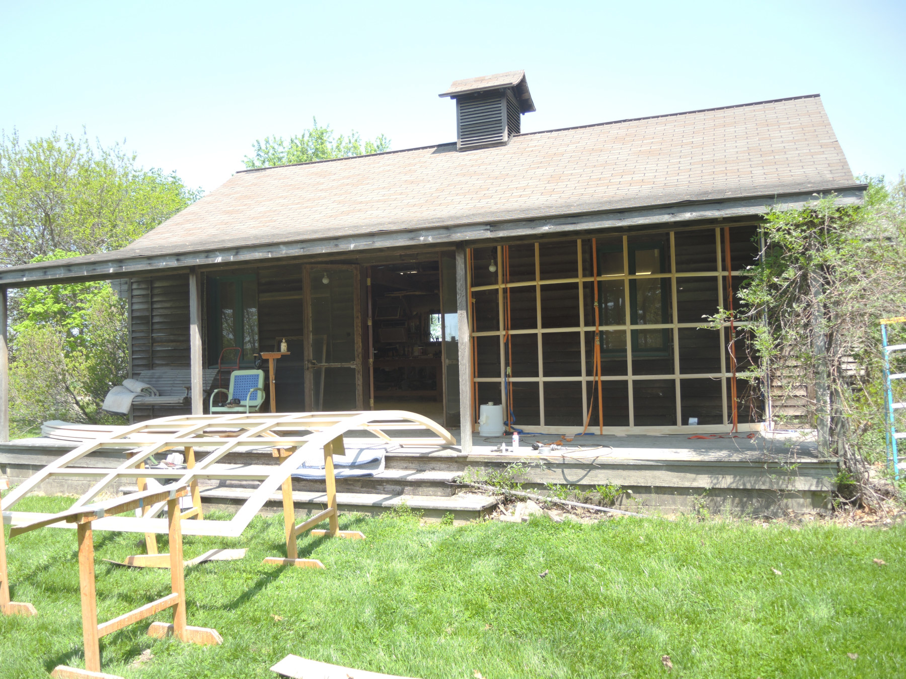

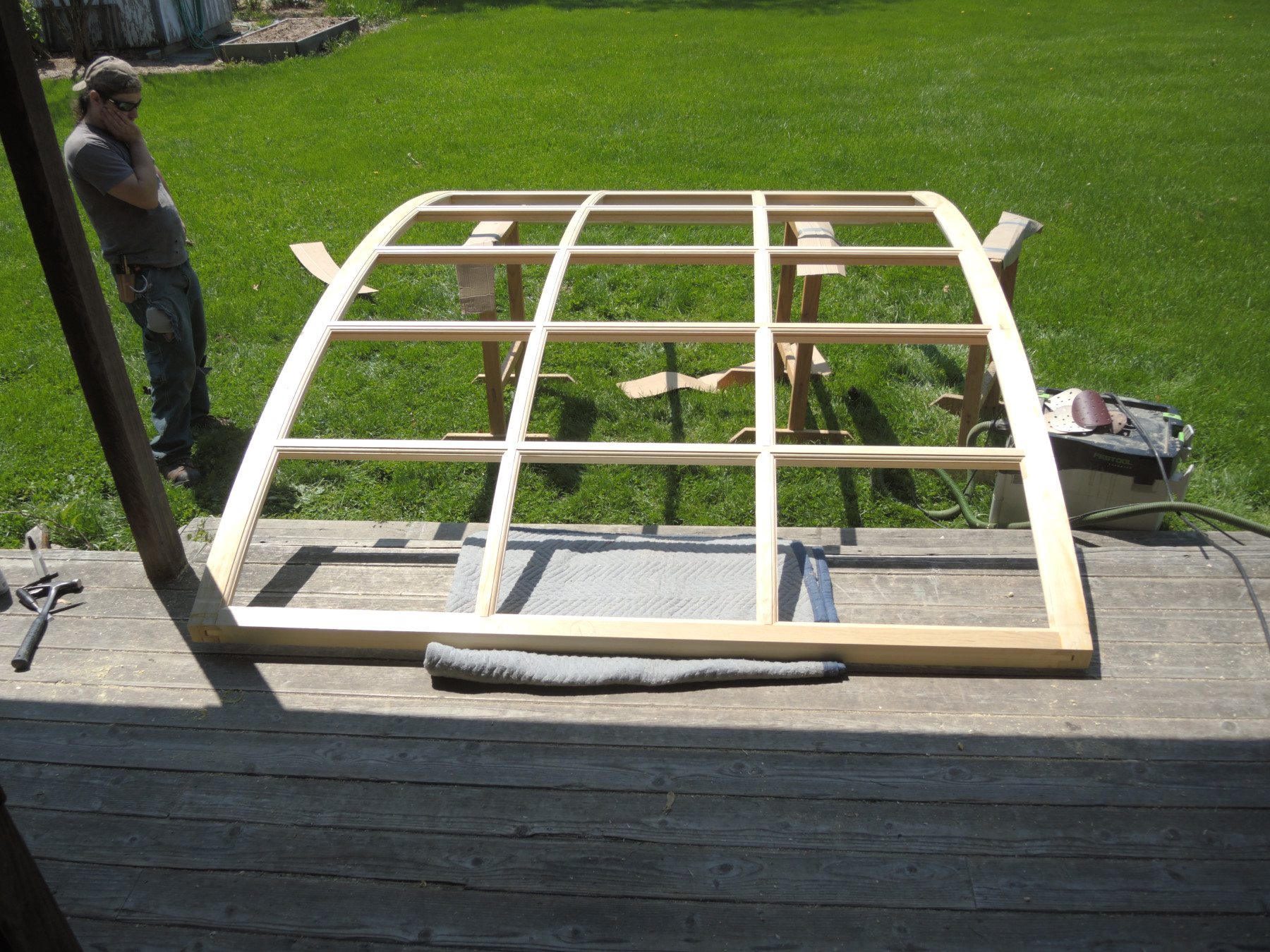

The photos are of a large sash with long verticals and short horizontals to facilitate the radius. The horizontals were not tenoned, but were coped nicely. The vertical are tenoned as well as coped. We used spacers to locate the mutts, then set the glass and mitered the stops with RTV both sides. Once it was cured, it had almost no ability to twist - it was rigid. The dry fit photo has the straps on it to hold the verticals in place. We had two of these, both just a hair too big to fit out the shop doors.

Sam
David
Couldn't help but notice in the picture
of the porch ... that's a funky looking
beam support arrangement that the
porch rafters sit on .... any back story
to that?
Sam
7/19/17       #10: True Divided 60 Lite Sash ...
Sam - Yes, it is true that I am not a framer. Adequate, but not proficient.
That arrangement came about because I wanted a thin beam to span from post to post - did not want it be low enough to be in my field of view. Also, I wanted a certain angle of drop to the porch roof. Being OCD about such things does not always make for logical pathways.
I moved the beam back off the post tops to where is was half on (or half off), helping preserve the angle by some fraction or another. The beam - two 2x6 and some 3/4" ply - is heavily nailed at the point where is is on the half laps on top of the posts. The rafters are deeply notched.
The odd part is that I built the shop as a hobby shop before quitting my last real job, running a 12 man shop for a full service wholesale lumberyard. No one there - estimators, draftsman, salesmen - could tell me what I needed to span the 12' distance. They asked what I planned and said it ought to work. It does work fine, even with a good snow load.
You may notice the Summer Office - porch swing and rocker - is open in this picture. The porch has come in handy for everything from assembly, to lumber storage, to weddings.
