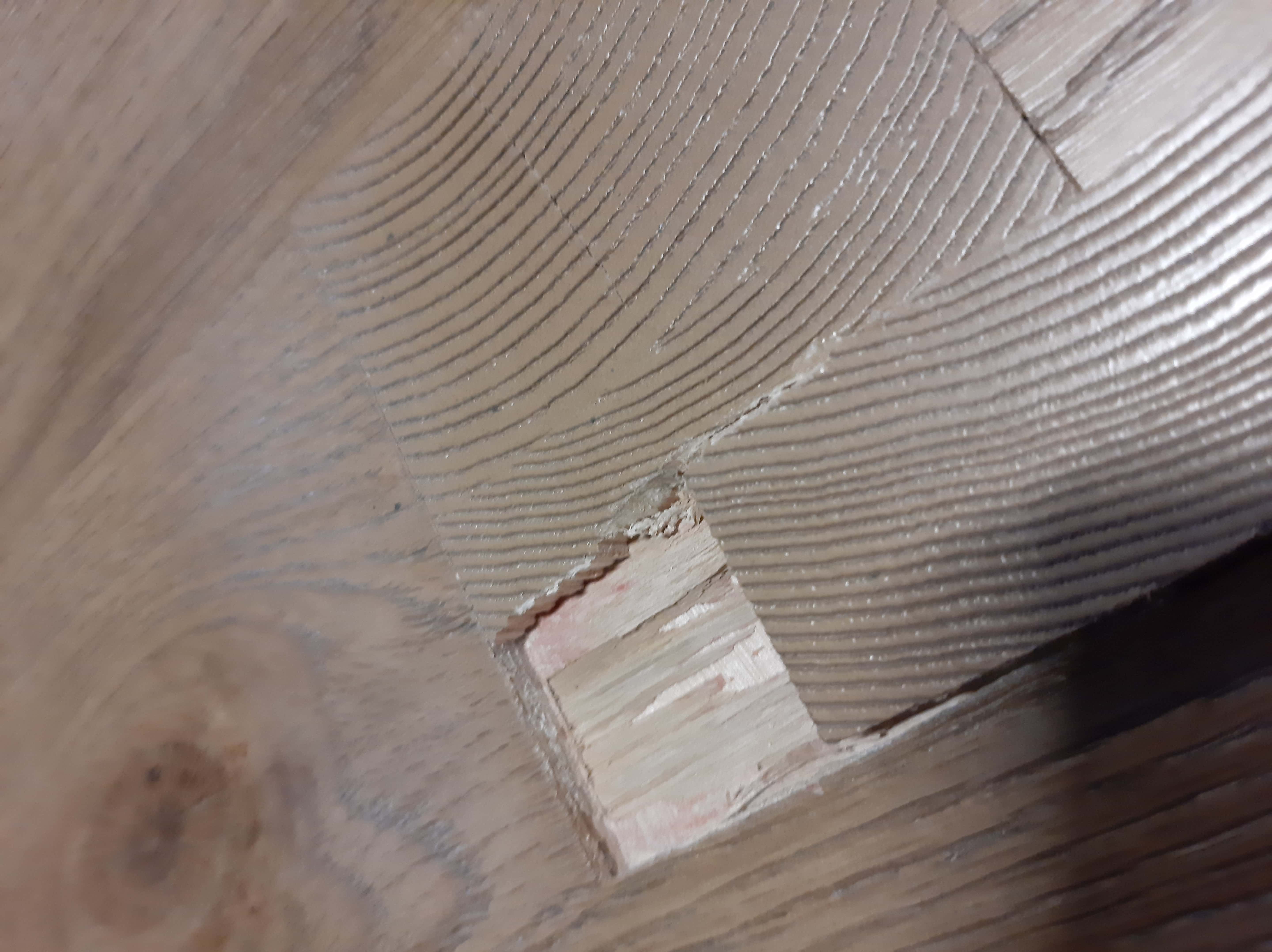

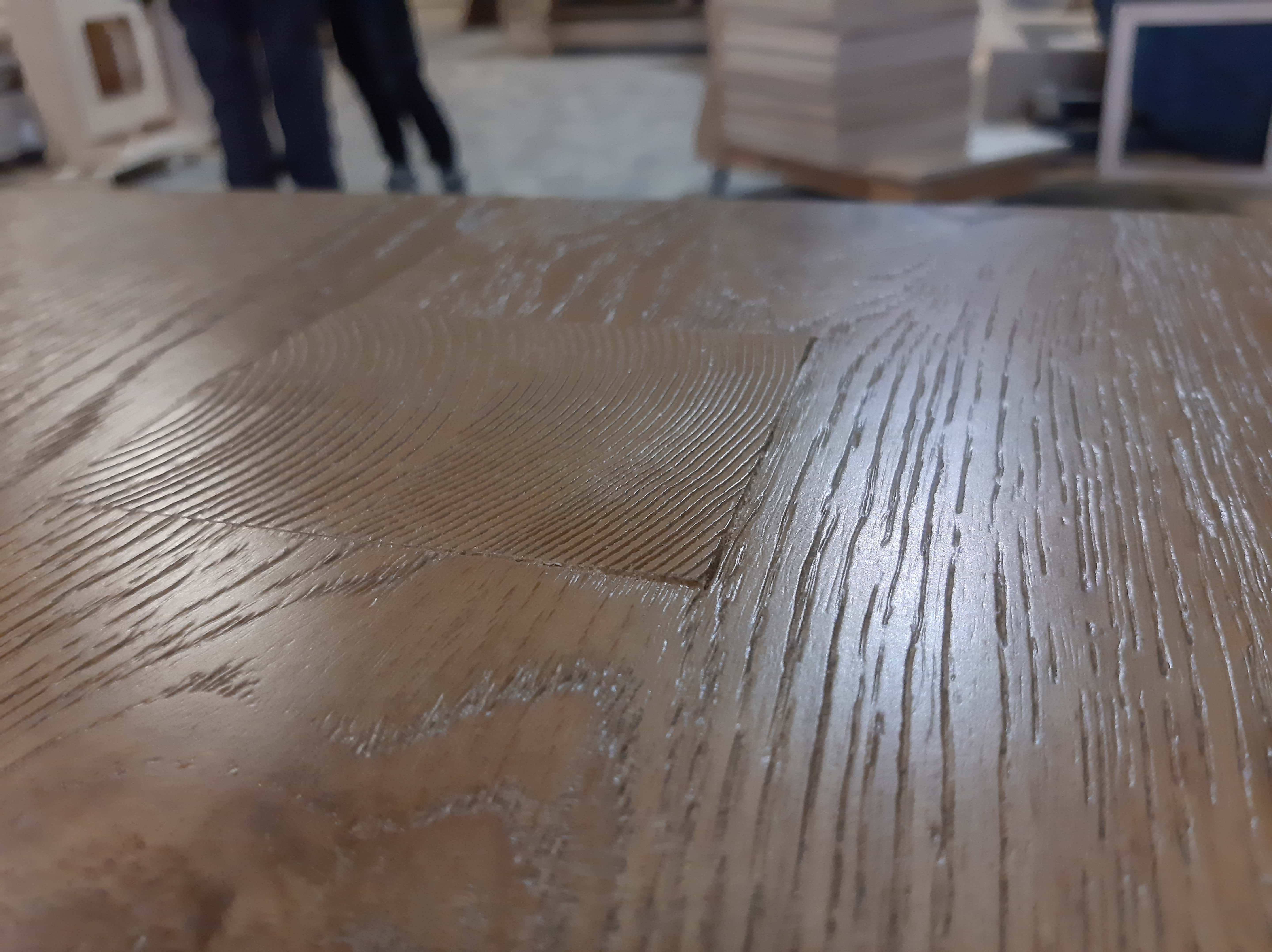

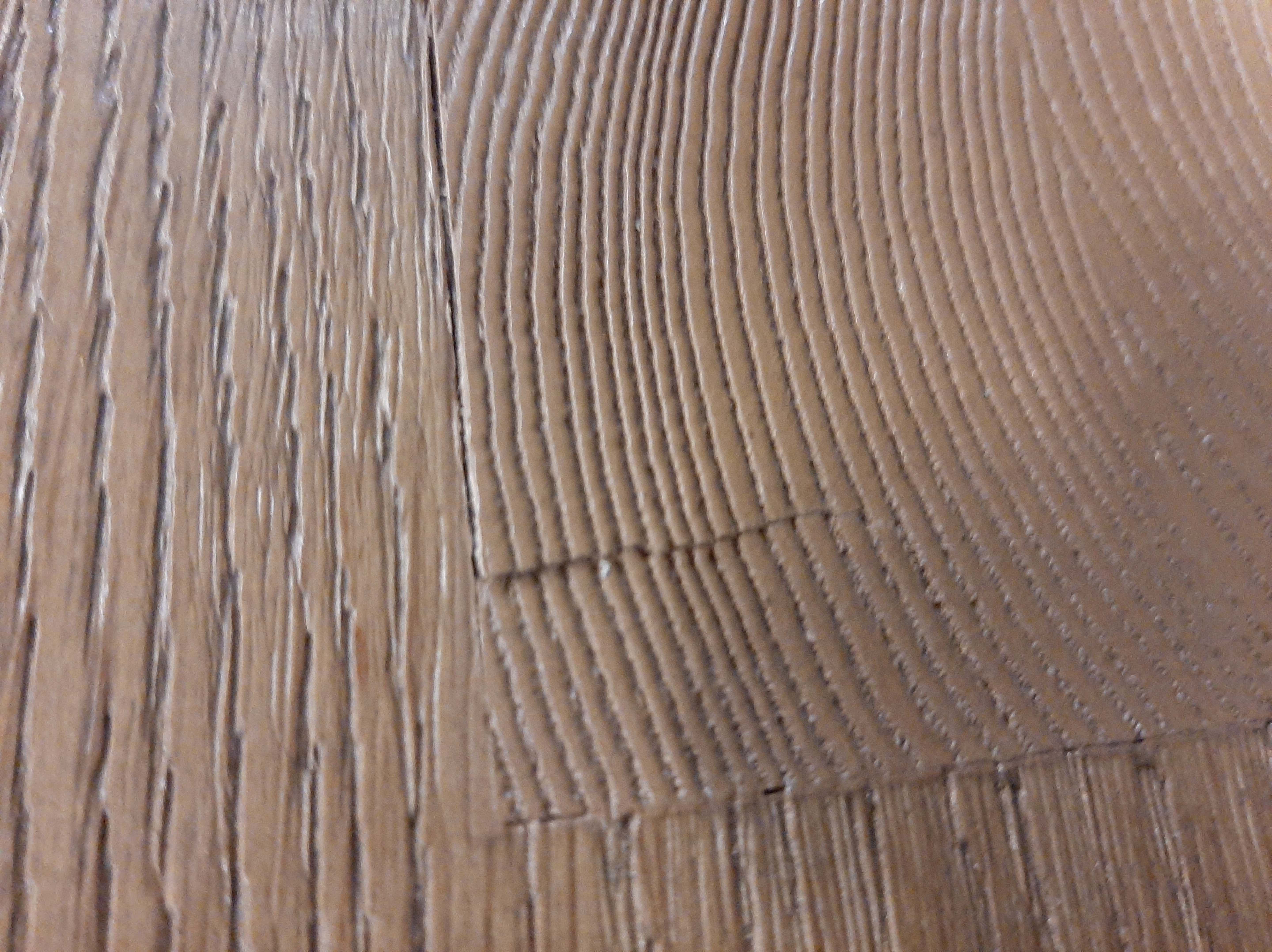

Hi all,
Having a problem with a vanity top.
The designer is asking for an end grain oak inlay to make it look like the wooden vanity top has four wooden legs holding it up with through tenons.
The rest of the top is oak veneer on marine ply.
The size of the inlay is 3.5x3" square, 1/4" thick.
On the sample top, the inlay started cracking and warping up.
It was only finished on the top, so do you guys think that sealing on all sides before install would prevent that the warping? would going 1/2" prevent it? 3/4"?
Do you think it's an issue of warping up, or expansion and contraction issues?
We would prefer not doing an end grain inlay on a vanity top, but that isn't an option unfortunately.
View higher quality, full size image (5760 X 4312)
2/18/21       #3: Endgrain Inlay ...
duster
It looks like your solid oak end grain inlay shrunk and then cracked, most likely because it wasn't dry enough. Making them thicker won't solve the problem. I'd try making them thinner and make sure they're dry. Also, maybe try epoxy instead of a water based glue, which may add moisture to a porous end grain inlay.

Way too thick. What you might try is to cut the end grain as you did before but 1/8" thick and epoxy it to a piece of 1/4" Baltic birch ply, with a veneer backer as balance, and then run it all through a widebelt sander with the end grain up until the end grain is close to veneer thickness, and then inlay that into your veneered top. Use a waterproof glue to adhere the inlay into the top.

My approach would be to super dry your endgrain inlay (heat, toaster oven, low oven, however you can), leave it as thick as you wish (within reason but a bit thicker wouldnt be bad) because the conventional rules of wood movement as it pertains to veneer dont apply here, and run your inlay with either PVA or Epoxy as normal. Super drying the inlay will mean that the instant it comes out of the heat it will begin to take-on moisture an expand. It will be somewhat like inlaying a compressed dry sponge and as it takes on moisture it will expand into the cavity. This will keep the inlay in constant compression likely holding throughout seasonal movement for eternity.
Being end grain and relatively small the expansion will have zero effect on the top but the small inlay will be forever trying to expand having the best chance of keeping the joints tight.
My approach would be to leave the inlay relatively thick and take it down to the surface with a flushing router jig/lamello lipping planer/whatever you have. At least that way the inlay will stay as flat as possible and allow you to clamp it in place.
Concern with running the end grain inlay very thin would be whatever glue/epoxy you have coming through the capillaries even with non-white oak species.

I see two issues here. One, the shrinkage and cracks and two, poor glue adhesion.
Both can be addressed with an epoxy joint with the caveat that the epoxy will wick up the open cells. Can a filler be added to the epoxy to increase the viscosity?
Last note. Is that a water borne finish? If so it likely contributed to the failure because the end grain would have been an open avenue to the pva glue bond further weakening it.

It is a 2k polyurethane finish, and a pva glue.
To be honest, I've never used an epoxy to glue before, but I'm game to try.

Over dry your inlay and walk away. If the endgrain inlay is going to move, shrink, cup, your dead. Come as close as you can to eliminating those and walk away.
We have a good customer that spends with wreckless abandon but for whatever reason buys a good bit of furniture from sh(tholes like Ashleys and Wells. Tables with this same faux element have gaps that will hold a half a teaspoon of cheesy goop that falls off someones fork. Its accepted, and dealt with.
The over-dry inlay will get you closer to something you can sleep with though likely not perfect. Your finish has zero to do with your problems.

Epoxy absorption can be an issue on end grain. What you might try is the West System 105 resin, whatever of their hardeners suits your open time requirements, and their 406 Colloidal Silica as a thickener.
