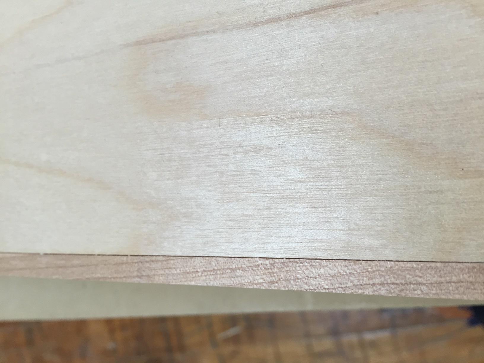

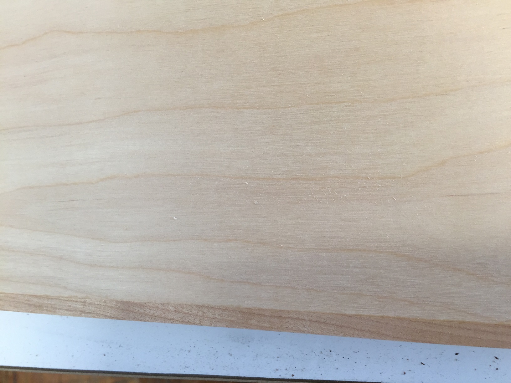

I have an edge press that gives inconsistent glue lines.
Some are good some gappy. Usually the tight side is facing the operator , and gappy on the back side of panel.
I have taken out heated platen bar and shimmed the rear edge to try to roll the heater bar and square up to panel edge.
I can get good results with something like oak(grainy wood) but maple or birch ends up looking pretty bad.
How have others tweaked this machine to get it to perform as it should?

there seems to be no pattern, other than is almost always back edge. Do you have some theory ?? I did a test the other day with no heat and it seemed better, I am starting to think the heated platent is a fussy feature that needs more attention than I have been giving it, and that I may be shrinking the outer face of the hardwood edge,pulling it away from the substrate
