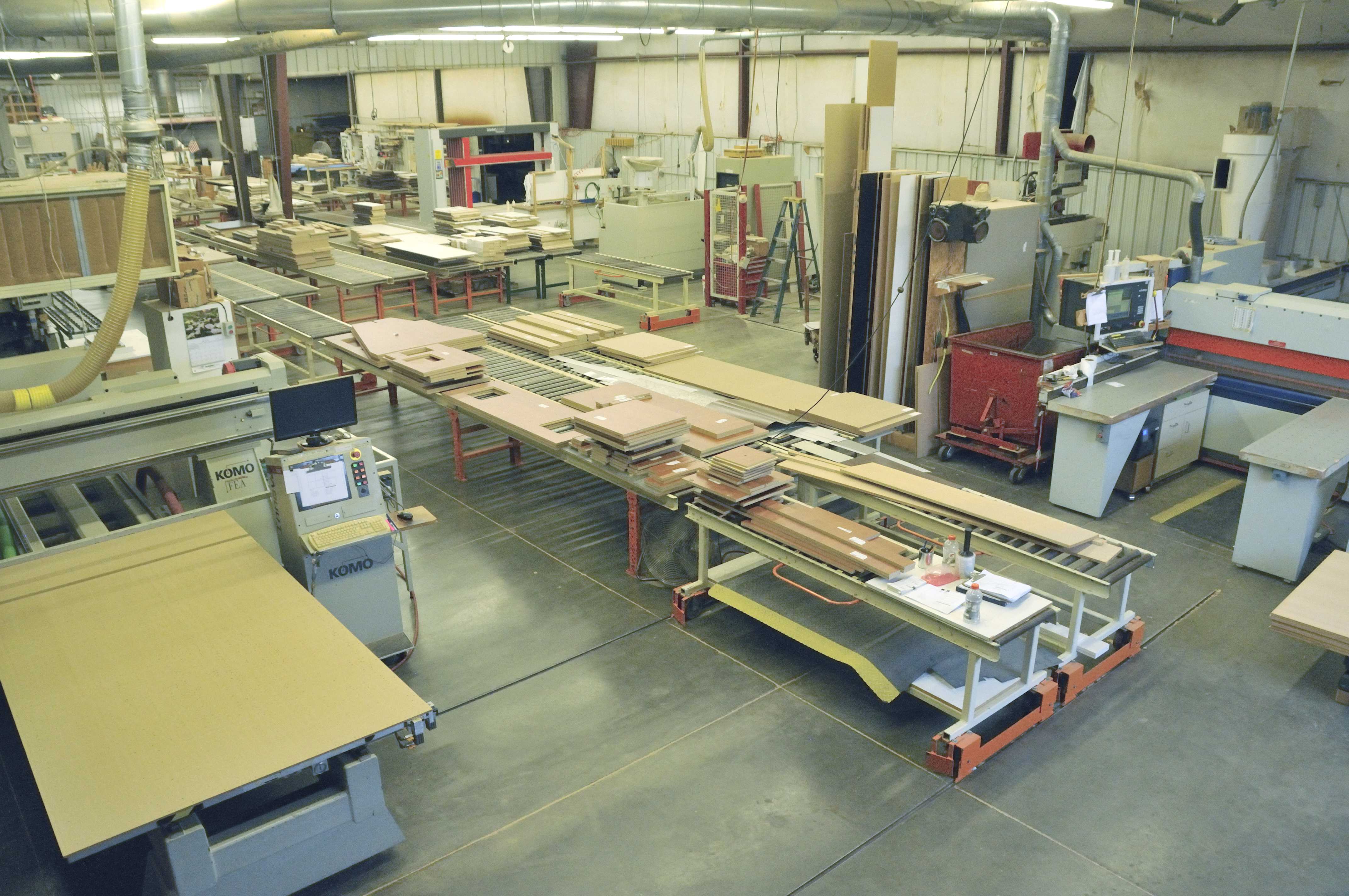

7/2/16       #13: CNC job cart ...
Photos of our conveyor system. 1st one Router & beam saw input. 2nd one Bander on left, assembly straight ahead, doweling & clamping rt. 3rd 10, 10' sections of sorted parts for each of the assembly benches. Not seen, the final assembly station for case clamped stuff. 450' + 5 transfer cars. Tracks are recessed into the floor. Works for the diverse assortment of things made in store fixtures.

7/6/16       #14: CNC job cart ...
Bill  Member
Website: canadianacabinets.com
Nice shop layout. How much space do you have?
7/6/16       #15: CNC job cart ...
Bill, We've got 25,000', You can only see about 7,000 in the 3 photos.
