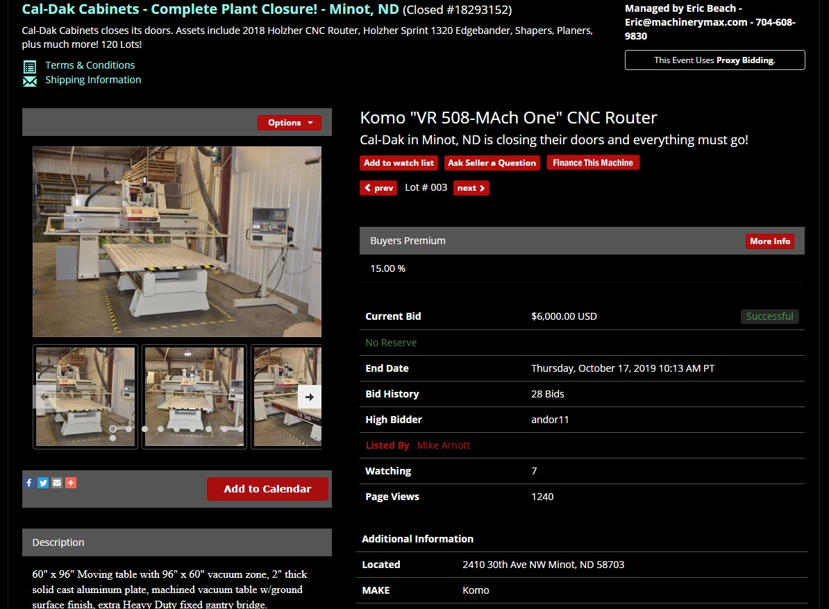

11/17/19       #4: Router specs for miter folding soli ...
Komo I saw recently at auction
View higher quality, full size image (1194 X 878)
11/18/19       #5: Router specs for miter folding soli ...
You might try and find a used Northwood or Komo that has a 0-90° saw for mitre folding. I have a Northwood and we are always using the saw for mitre folding everything, including solid surface. Does a much better job than a router bit. If you can find a used machine with a servo saw, that would be even better.
11/18/19       #6: Router specs for miter folding soli ...
Pat Gilbert, Someone got a bargain!
