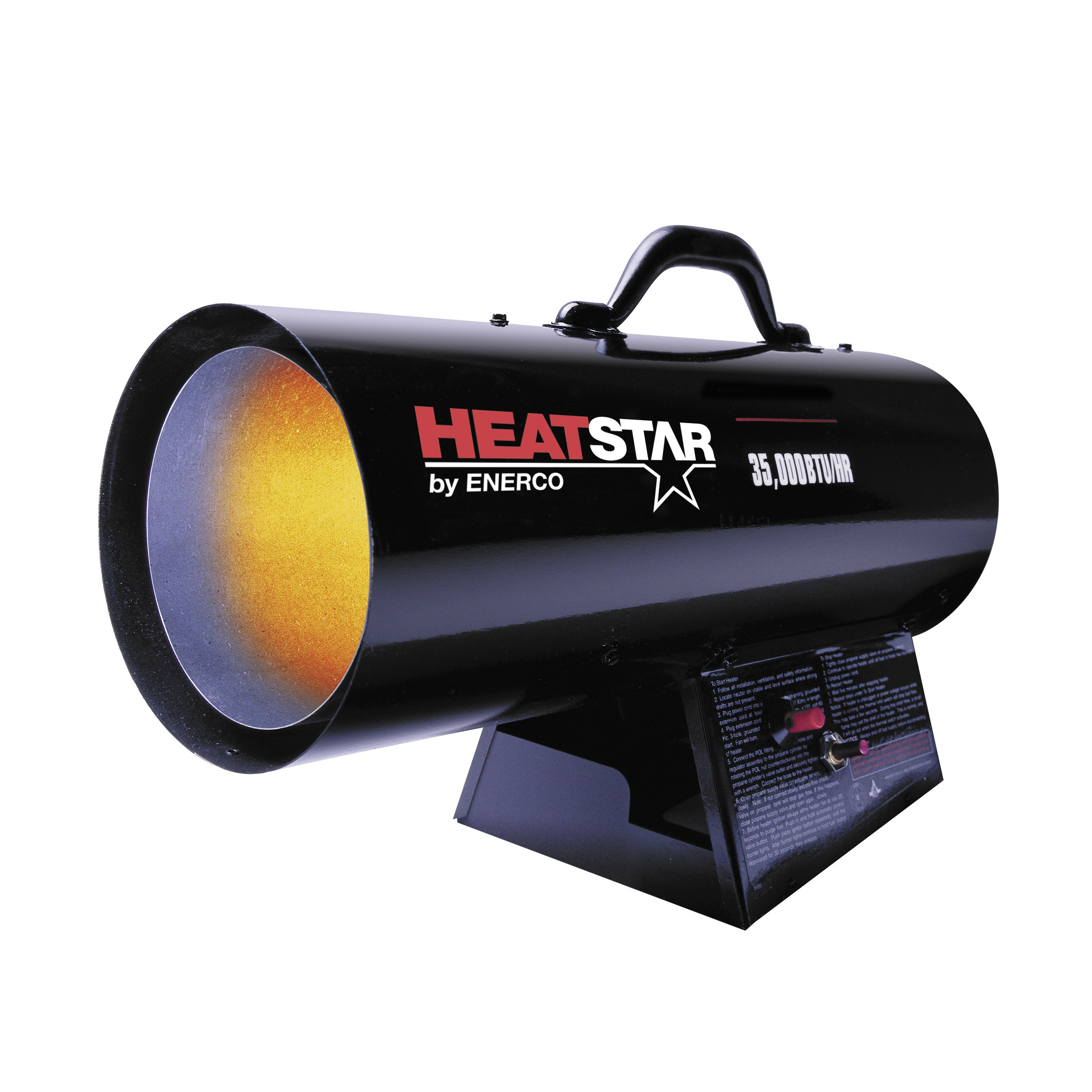

yeah, i think a fired forced air heater will do the trick and throw a duct over the heat outlet of the device. Just looking for the product that has the remote bulb that goes that high. worst case scenario I can wire a relay to the on off switch
View higher quality, full size image (2550 X 2550)
10/30/17       #6: wood kiln electric heater ...
Mark B Member
That cheapy goes to 210F. The heater you post will surely do the trick as long as your comfortable with distance and spark arresting.

Best idea I've read about was using an element from a home oven, mounted to a thick piece of aluminum used as a heat sink. Worst I've seen is that torpedo heater mentioned.
10/31/17       #9: wood kiln electric heater ...
Tennessee Tim  Member
Mark, the main thing is to be careful with the safety side of this...MOST DH units have electric as a option. So that would entail safety switches AND components for HVAC systems....NOTE I'll keep ENDORSING SAFETY!!!! The force gas heat as the salamender is a NO-NO!!!! Dangerous as a cocked gun with a hair trigger AND it just got dropped!!!

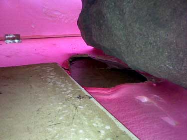

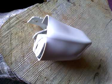

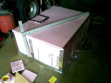

I beat the odds once BUT I almost cost myself a lot as one source of electric heat I tried the safety switch DIDN'T work...MAJOR melt down of parts.... I couldn't find my pics of damage BUT I got to it just prior to igniting. Bottomline is ...safety switches and company testings are for a reason!!!

I found the pics....Did I mention MELT DOWN!!!!
Top pic mini kiln....
2nd pic weather station sending unit (actually still working on same batteries (NO choice, I can't replace them due to meltdown)
3rd pic hole melted through pink board
