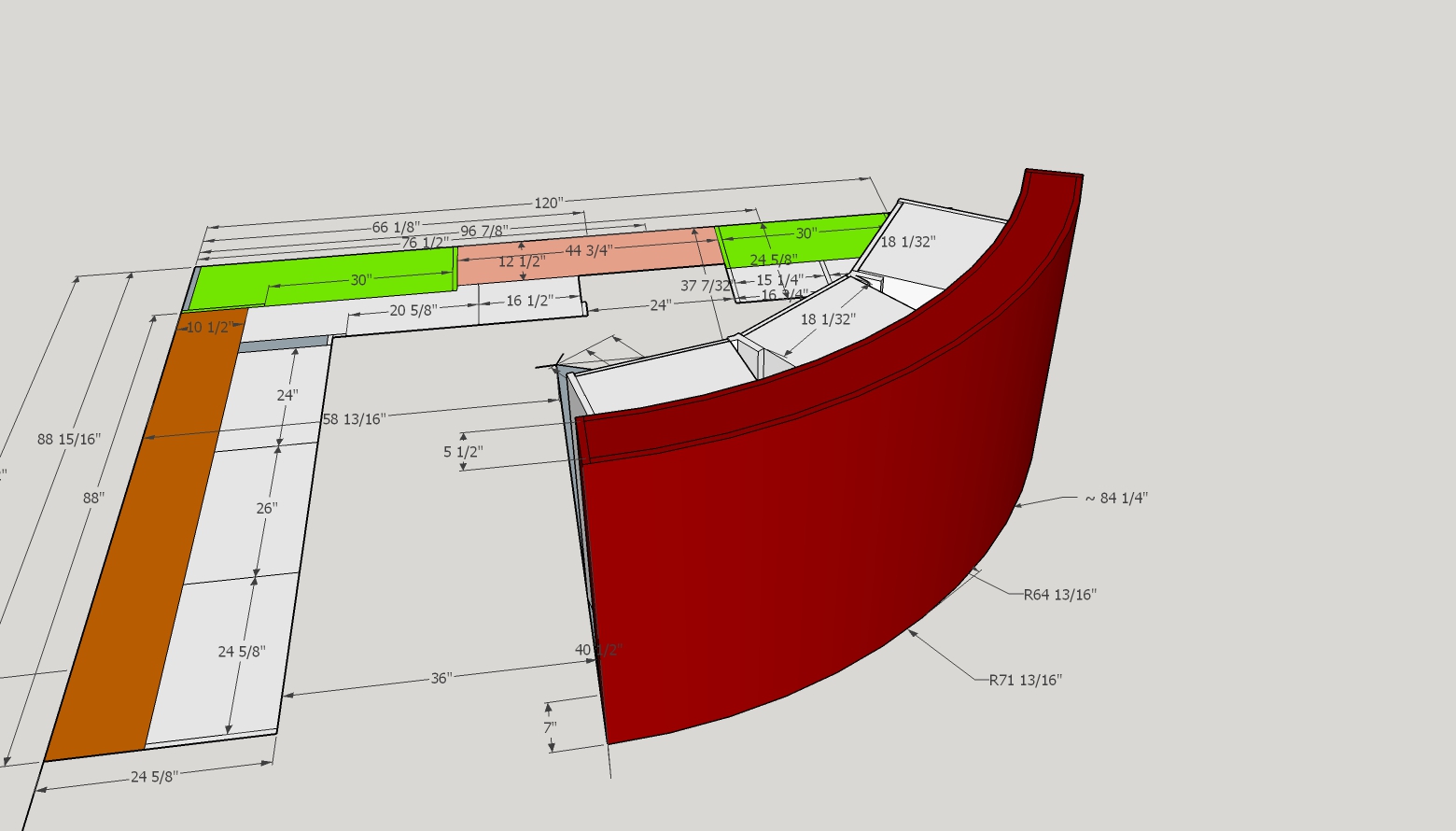

Hi all,
I'm making a curved bar front and trying to figure out the best way to do it. I was going to build a framed plywood curved wall with a radius of around 71 3/4". the wall will be 40.5" tall and a length of 86". After I have the skeleton of the wall I'm going to wrap it in 3/4 timberflex. Then I was going to use either a spray or roll on contact adhesive and apply the veneer and trim later. Is there any glue that is forgiving? Do I have the right idea of what i'm doing? does it matter if I use fleece or paper backed veneer? where is a good place to buy 8x4 (grain running the 4' direction) walnut veneer. Thanks for the help

7/19/19       #2: adhering veneer to timber flex ...
Veneer is not wallpaper. Despite the DIY guys that will gladly tell you contact cement, spray adhesive and similar will work for bonding their veneer. Those are all considered temporary, inadequate glues for only the quickest and dirtiest things.
Vacuum bagging is an accepted way to clamp the veneer to the wall, using a plastic resin glue, or dedicated veneer glue for adhesives.
Forgiveness comes in the production design. Your experience (flat veneers?) will tell you a lot about what you are about to do. A vacuum bag has the ability to clamp as a dry run, no glue, to see how it will all go together and anticipate the tight spots.
7/19/19       #3: adhering veneer to timber flex ...
I recommend applying a crossband veneer to the face before vacuum bagging the curve. It keeps the veneer flat - less prone to wrinkles and resists telegraphing imperfections in your substrate. Even staple depressions will be visible through a single layer of veneer.
