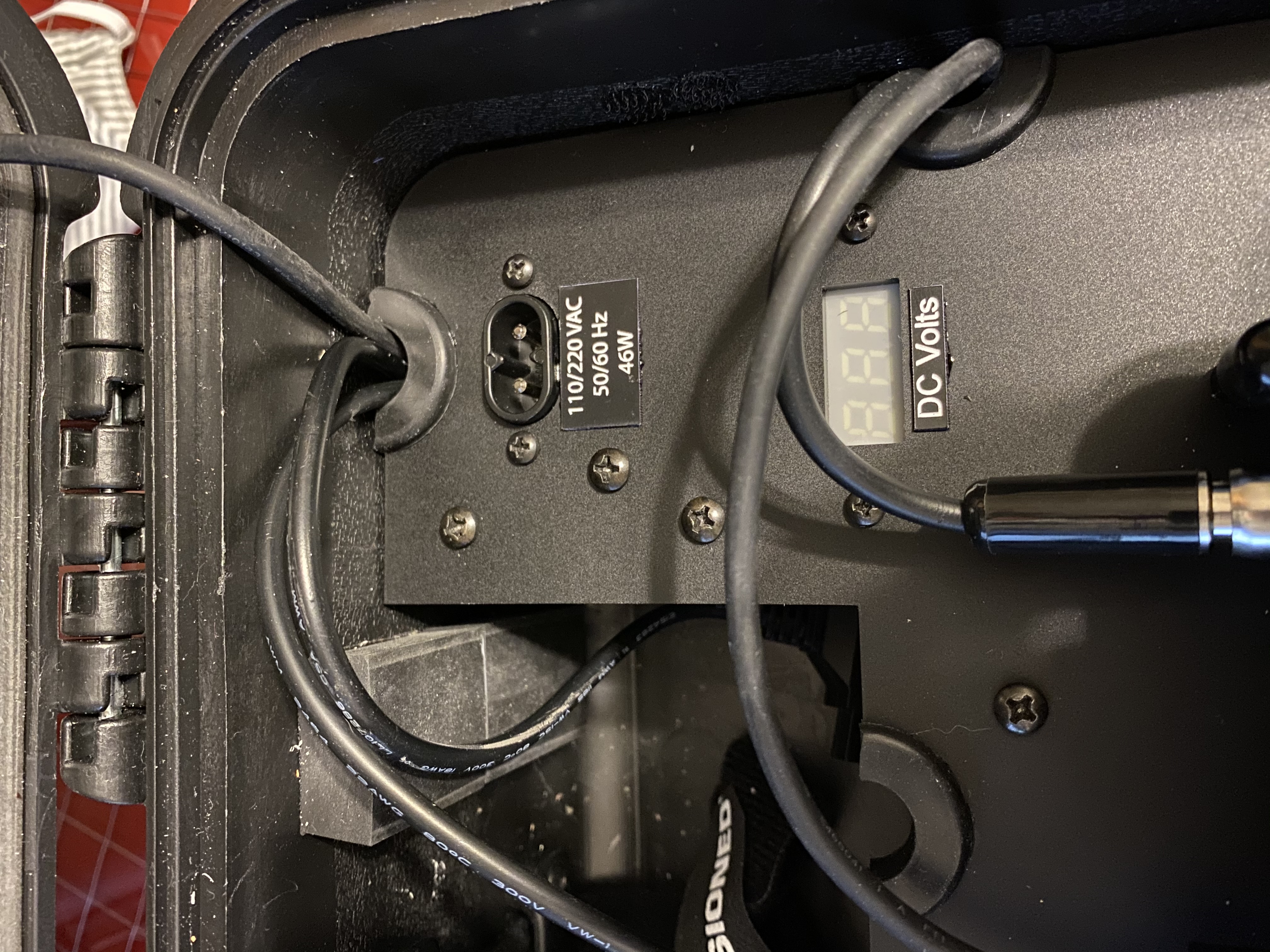

I want to attach a couple of labels to a thing I'm making. I'm engraving the labels out of .030 Flexicolor material from Rowmark (basically plastic) and sticking them to matte acrylic. In my first test (see photo) I used CA but, as you can see, it tends to squeeze out around the edges of the labels. I might be able to find just the right amount, and develop the right technique, to prevent this, but I'll be making more of these and I'd prefer a process that's less finicky. Can someone recommend a different adhesive?

3M #930xxLE
used extensively in automotive markets. xx = thickness in 0.xx mm
eg: 93010LE = 0.10 mm thickness. You can get in various widths. Minimum quantity will probably be your issue.
A stock 1/2" x 5.2mil (.13mm) roll is 18 rolls per case. Other stock configurations are much higher (for Auto Plant consumption)
The attached link will give you a selector screen to enter your substrates and find the best product.
3M Adhesive Transfer Tapes
1/30/21       #3: Seeking adhesive suggestion ...
3m VHB tape. They sell all kinds of sizes on Amazon. It’s insanely strong. It is structural double back sticky tape.
