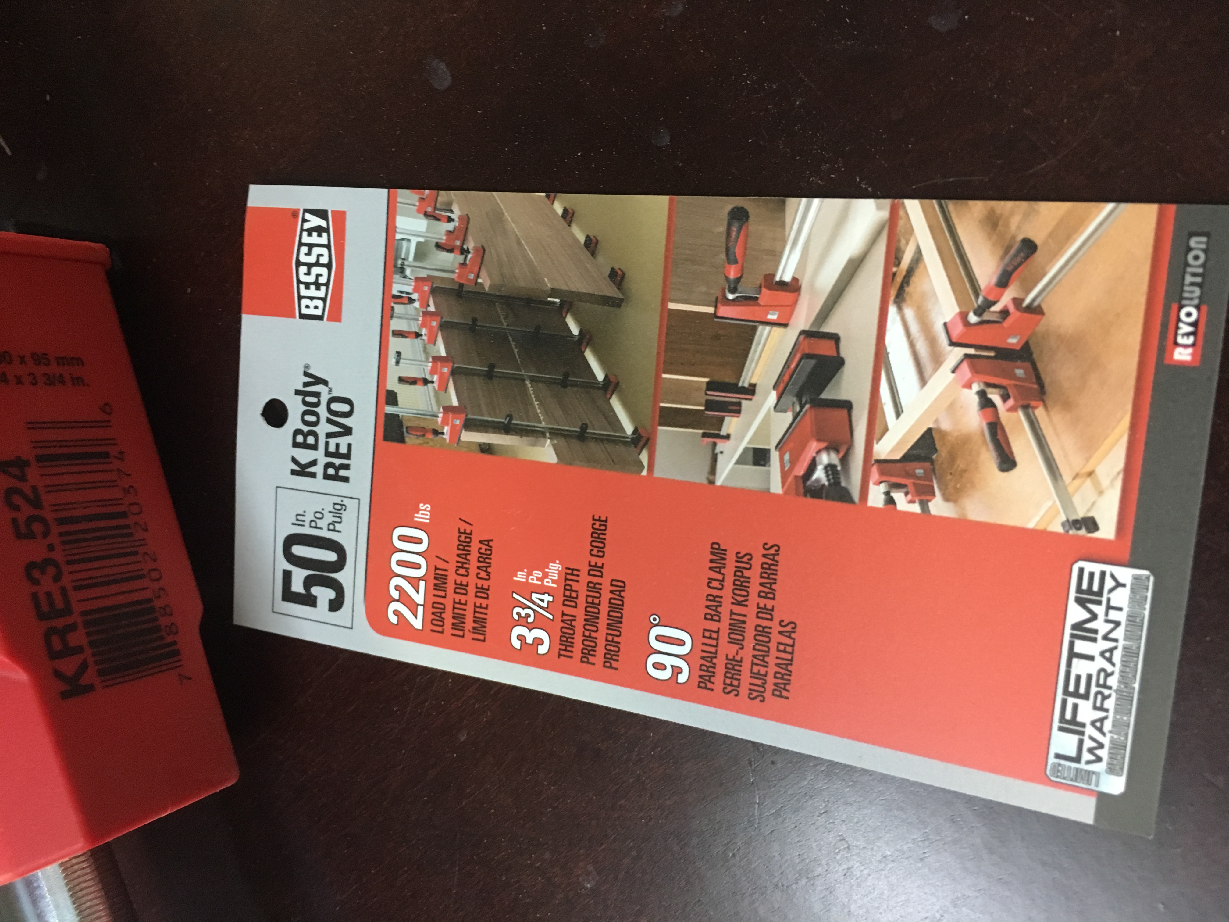

I decided to stock up on clamps last week, and thats when I discovered BESSEY has redesigned their Revo parallel clamps,
Old style are models KR3.5xx. And new style (which began shipping early April 2018) are krE3.5xx
The new ones are better, and I will not be buying the old style clamps unless they go on NS-4-real clearance
I haven’t found a single word on this anywhere online, but I got my info from Bessey, after buying several hundred dollars worth old style & about the same of the improved version from several Home Depot stores in my area.
I subsequently RETURNED the inferior Revo clamps and exchanged for KRE clamps by running all over hells-half acre to nearly every Home depot store in my area, and I’m writing this in hopes that I can start spreading the word
That being:
Unscrupulous business practice.
Bessey, put the word out as you should have before shipping out the new & improved models, & either pull your old stock, or put them on clearance.
Updating your product info on your webpage would be a good idea as well
New clamps have increased clamping force.
& its not just greater max force, its greater pressure throughout the range
(I.e. these are not commensurate with KR model revos, & I would prefer not mix them on a single glue up)
2200lbs vs 1500lbs is a big difference in many applications.
Also, new style clamps have hex socket in handle, & long 6mm hex in a cordless drill/impact works amazingly well
Overall clamp action feel seems different, but these are all new clamps so ???
What else? Logo/emblem and color are different (new = bright red)

Trying to post some pictures
