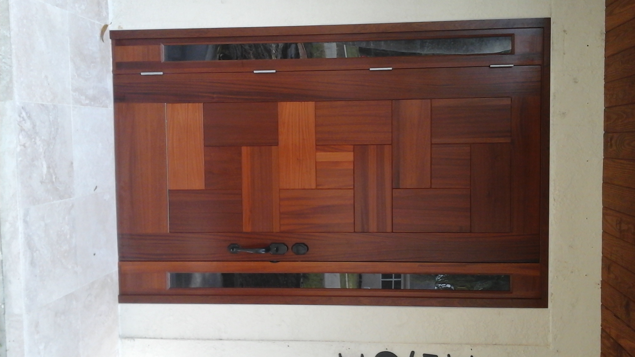

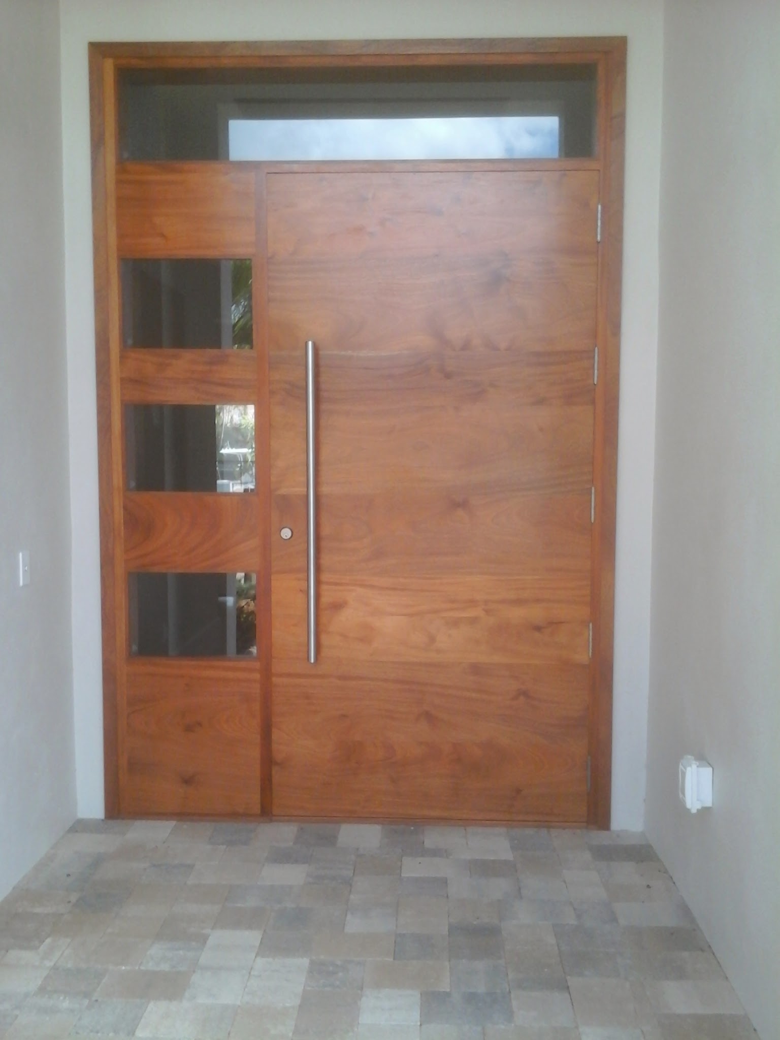

doug mclaren  Member
1/ if u have to ask dont quote it
2/ doesnt really have to be an " impact " door?
3/ often houses that are co'd already can be a typical entry door.
4/ typical requirements- laminated not single piece anything.
2 1/4 inch thick
Solid 1 3/4 jambs anchored to buck and concrete every 12 inches with tapcons
7/16 +impact glass
Tested by lab with 2x4 cannon impact test
Approved engineers deawings
Some entries need 5 point locking system
Typical doors can be 400 +lbs so need commercial grade closers
Heavy duty hinges like 5 each 3/16 nickle chromed bronze hinges with bearings at the knuckles
