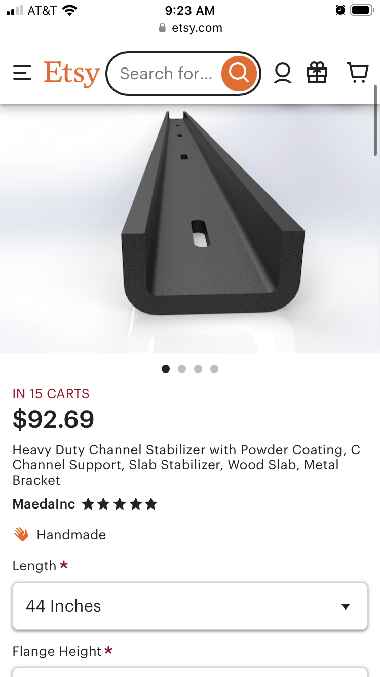

You most certainly can use metal to hold a top flat. I recommend “C” channel. [edited] There are times when metal channel strips are your only option, especially outdoors. Of course get something meant for the outdoor environment the piece will live in. Epoxy is the only glue I would use in this situation, as well as tongue and groove joints. Bid accordingly and bid high!

The c channel I was referring to is readily available in many sizes at what I think are good prices. It comes made for wood tops, so they already have slotted holes.
View higher quality, full size image (750 X 1334)
