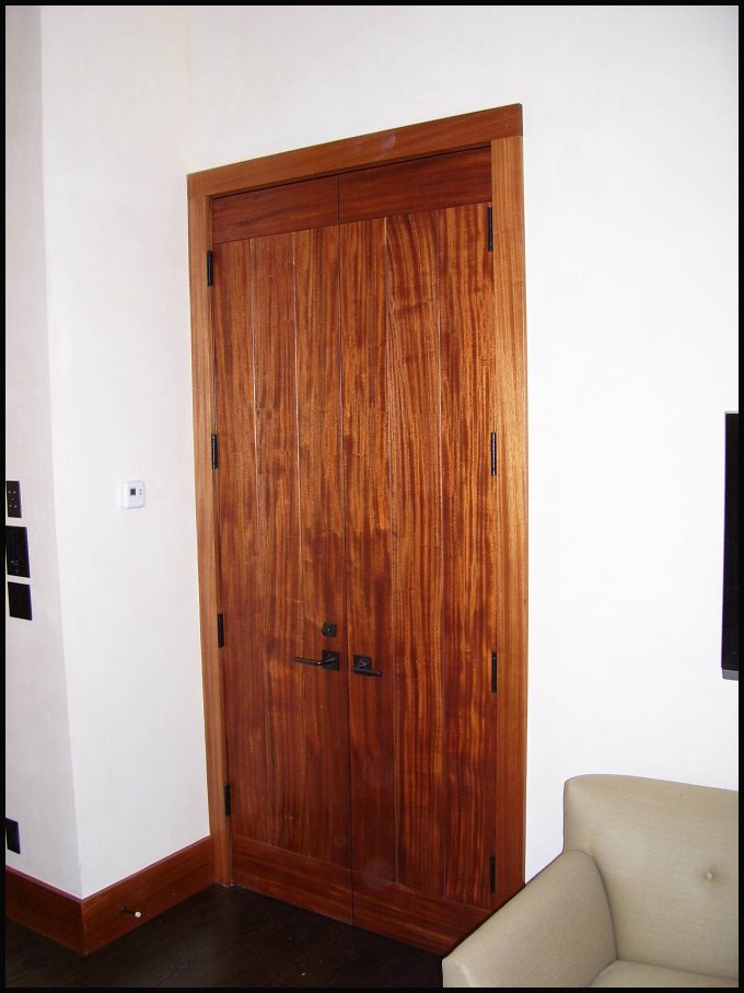

Joe Calhoon
We did a house full of this type door a few years ago. We used square edge cope and stick, Splines, not glued between the planks, loose tenons glued on the interior planks and dowel joinery glued at the corners. Any type of joinery done right should work. Material should be well seasoned or engineered.
This allowed the planks to expand or shrink a little. In my area wood usual shrinks but the opposite might be true in CT.
I was worried about this job holding up especially the exterior door with the wide members. Last time I looked everything was fine. 6 or 7 years old now.
Joe
View higher quality, full size image (680 X 907)

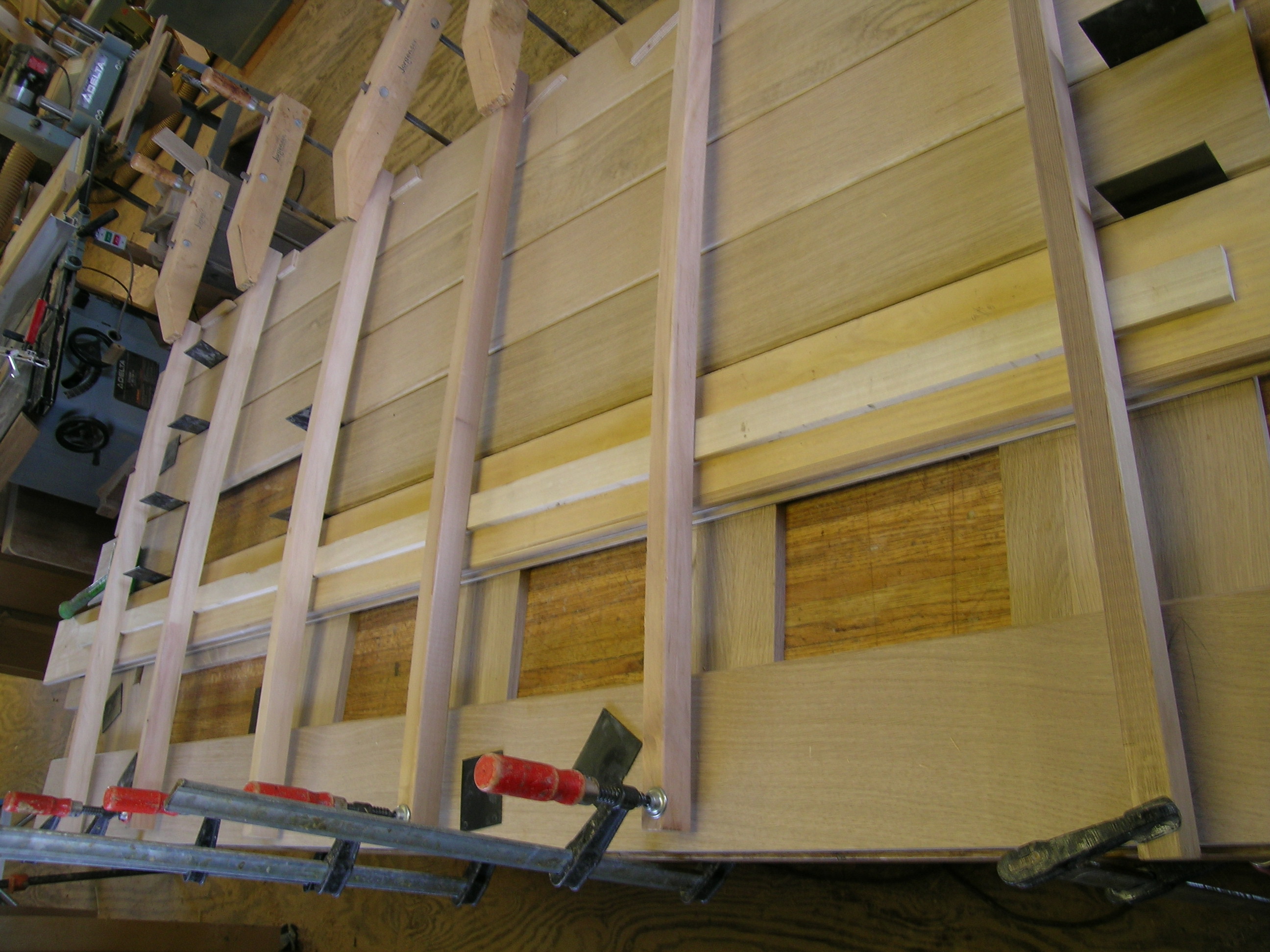

I have built many doors like this, but my methods are somewhat different, and based on historical doors that have survived decades.
I would build this as a three ply 'ladder core' door, with the center ply being a mortise and tenoned frame the full width and height of the door. Two stiles 5" wide or so, and about 6-8 rails with 3" tenons into the those stiles a very rigid core. All from jointed stock at 3/4" thick. This is simplified - yours will be more complex with the glass in it.
Think of the two faces as laminations. I would join the two vertical stiles to the rails with long, open tenons the full width of the rails, again, all at 3/4" thick. The filler boards would each be tongue and grooved into each other and the stiles and rails, glued to the core, with a gap between the t&g boards. The gap will be about .050 if v-jointed, and about.075 if square edged. Do not glue the T+G except at the ends of the boards. The idea is to let each board move in it place, while the outer perimeter is rigid. Ct is like Indiana - if anything, these boards will swell if the lumber is at 6-8% now. Fill the voids in the ladder core with rigid foam insulation before adding the second face.
Use quarter sawn stock - especially on that wide bottom rail. I would even consider making the bottom rail a five ply rail - face at 1/16", cross band at 1/16", core at 1/2" of quartered solids, then cross band and inner face. I see quartered Honduras Mahogany at 12" that hasn't moved, but I still would loose sleep over it. Other species I would not trust.
As stated to an earlier query about planks in a door, things are not always what they appear to be. Joe Calhoun builds a good door, and don't overlook his comment on "engineered" stock. Stable stock will eliminate all the movement issues and allow total freedom for reveals, joints, etc.

5/20/14       #18: Solid Wood Plank Entry Door ...
I neglected to mention that this would be a 2-1/4" thick door. Pretty much the standard thickness exterior door around here until after WW2.
You can make thinner faces - 1/2" - but the 3/4" allows for a t&g joint along their length. You should have something to plug the gap, since a gap has top be built into the door. 1/2" can allow for shiplap, but then one edge can curl - the t&g holds everything parallel.
The core rails can be narrower than the faces. I would use stock about 3-4" in width, and about 6-7 of them from the top to bottom. You want to lay them out so a rail - second from the bottom - catches the ends of the floating faces and the upper edge of the wide rail. Same at the top. I'd have to think and draw to figger out the glass....
Think of those floating face boards as 'semi' floating - they are glued to the core rails, and to the horizontal face rails where they meet, but not to each other along their length. Let each one move in its own little place is the guiding principle.
Cross grain movement will be most threatening in that bottom rail. I'd do several things: redesign it to 10" max, with quartered materials. The 5 ply is foolproof, though, and makes for a better long-term solution, in my opinion.
The pictures show a plank door with a small window going together: core, faces, and second face, with spacers.

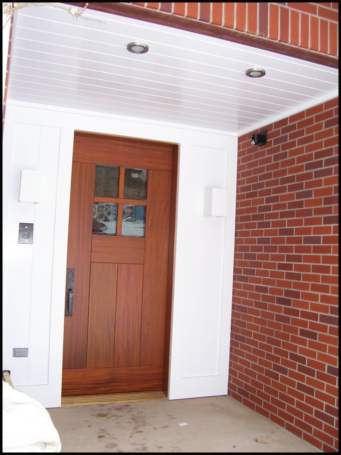

5/22/14       #25: Solid Wood Plank Entry Door ...
Joe Calhoon
Jeff, Have a look at this UK door.
Not sure of the exact construction but it looks like he has allowed for movement of his solid cladding. It is a interesting form of ladder frame. Joe
Door
