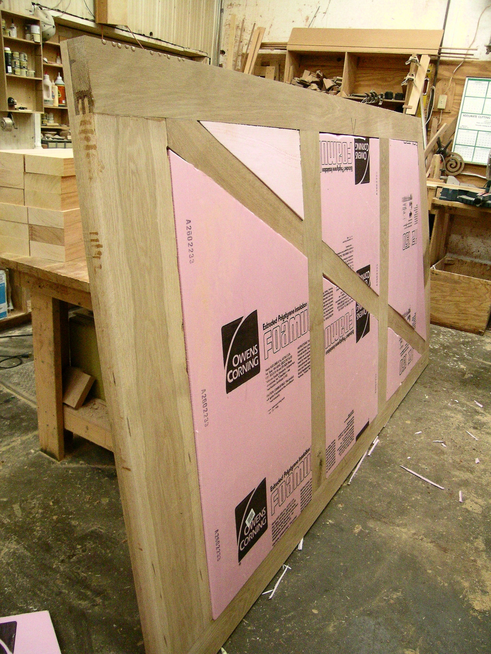

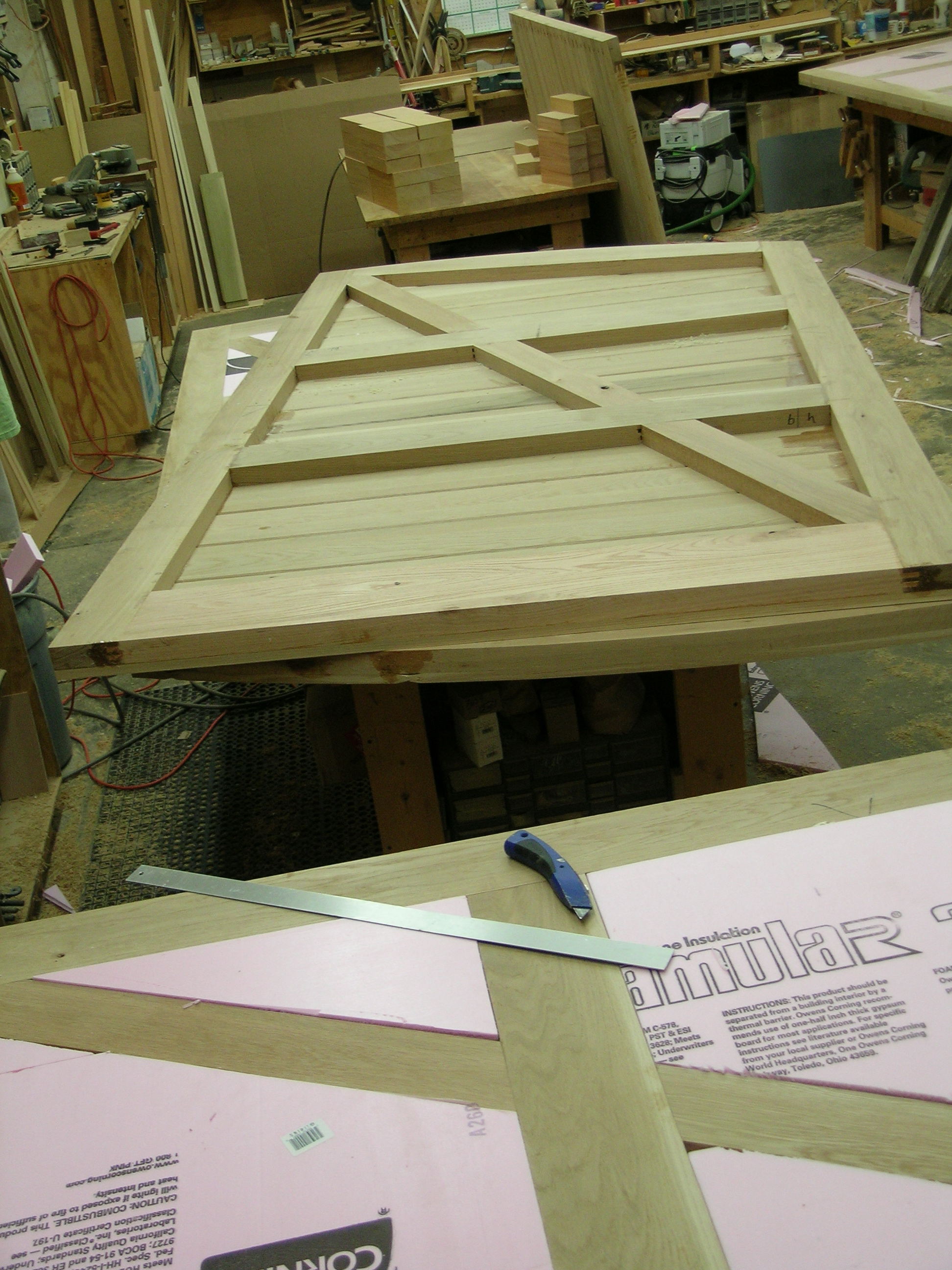

Thin skins help keep the weight down. We have pressed the skins only (1/8" 'door skins' or 1/4" 3 ply) back to back with the face veneers and then once out of the bag, pressed them to the core - a latticework of sticks with foam, lock blocks and edgebands. Nerve-wracking as all hell, but it worked well.
Looked for pictures, but all I found is attached. Similar principles, but all much heavier - 3/4" faces each side and 1-3/4" core frames.
