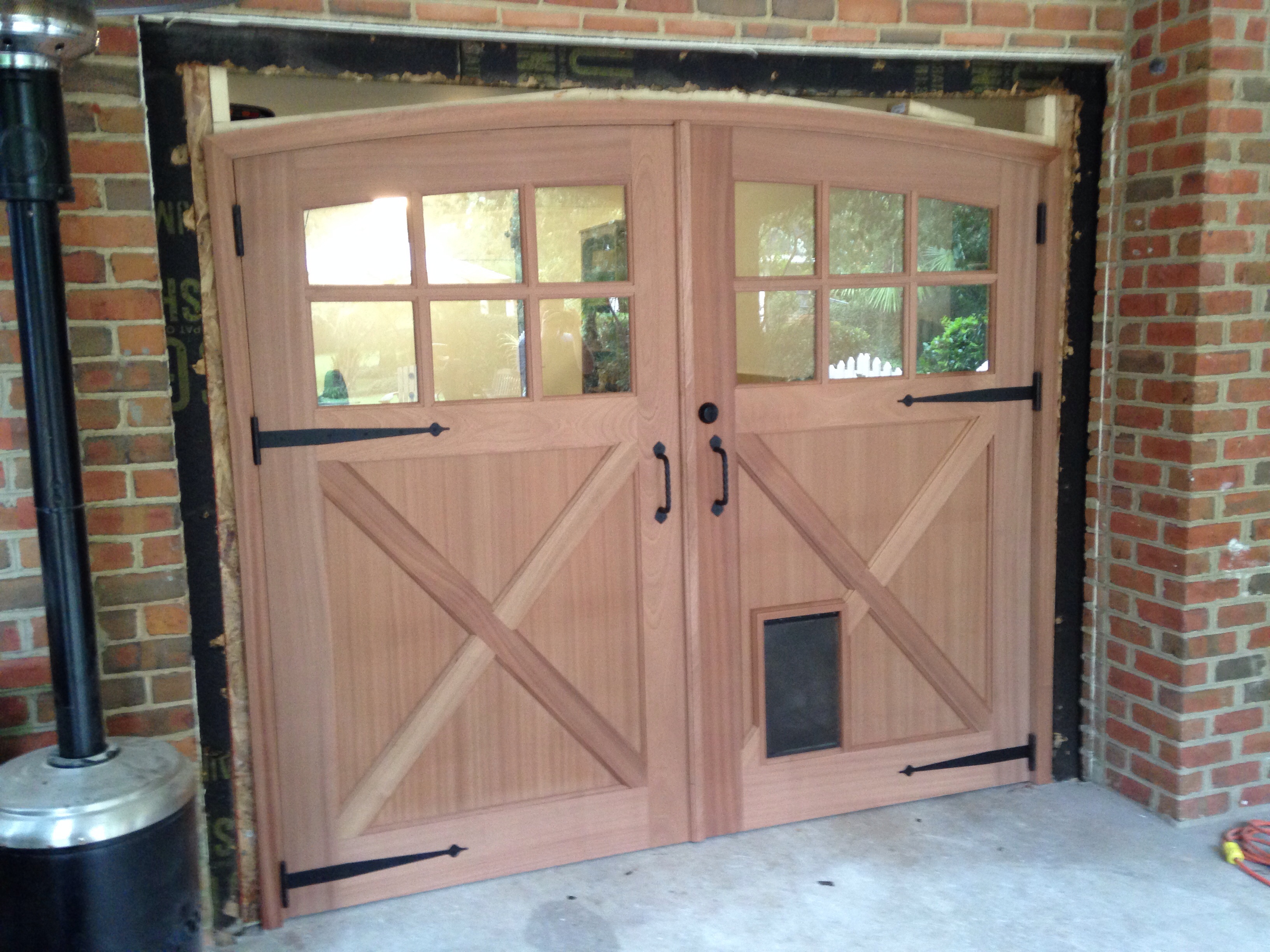

A few weeks ago I inquired about getting into making entry doors. Well, I finally finished and installed them today. Thanks to Gary Katz for the very informative book on door construction and installation. I found the info very helpful! I learned a lot with this project and I get to build another set in just a few weeks. I used Artcam software for the part design and my ShopBot to straighten and plane one side of all the lumber. All in all this was a very nerve wracking and fun project.

Kip,
How did you end up making your curved molding for the glass (earlier post question)?
What type of wood?
Looks good,
Geoff
9/22 #4: Doors finally finished ...
This is Sapele wood. It was actually really easy to cut the window stop since the profile was a simple 1/2" round over. I just cut the curved pieces on my cnc to match the rail and rounded the edge on the router table. I'm sure a more complex edge detail would have presented a bigger challenge though.
