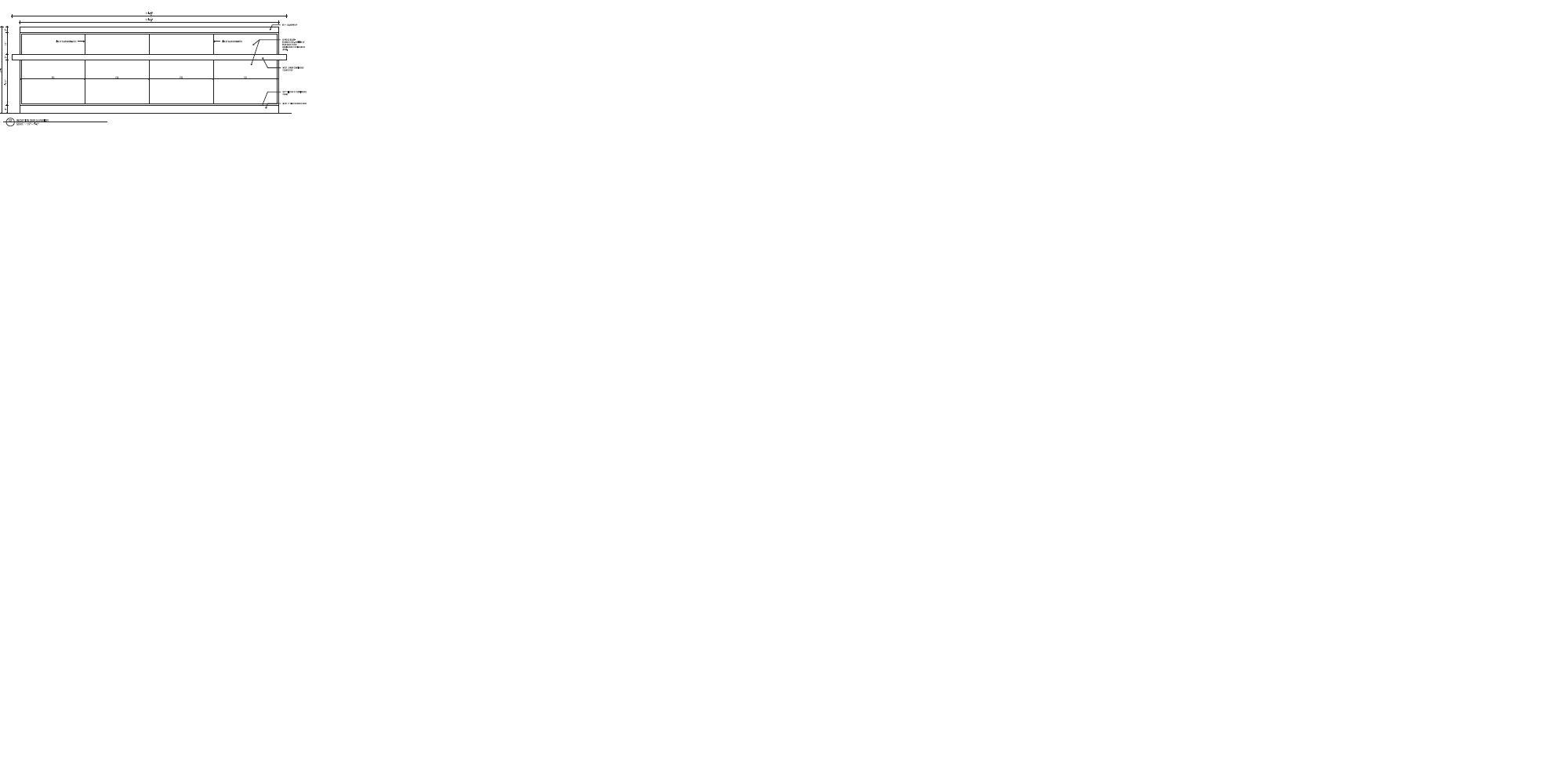

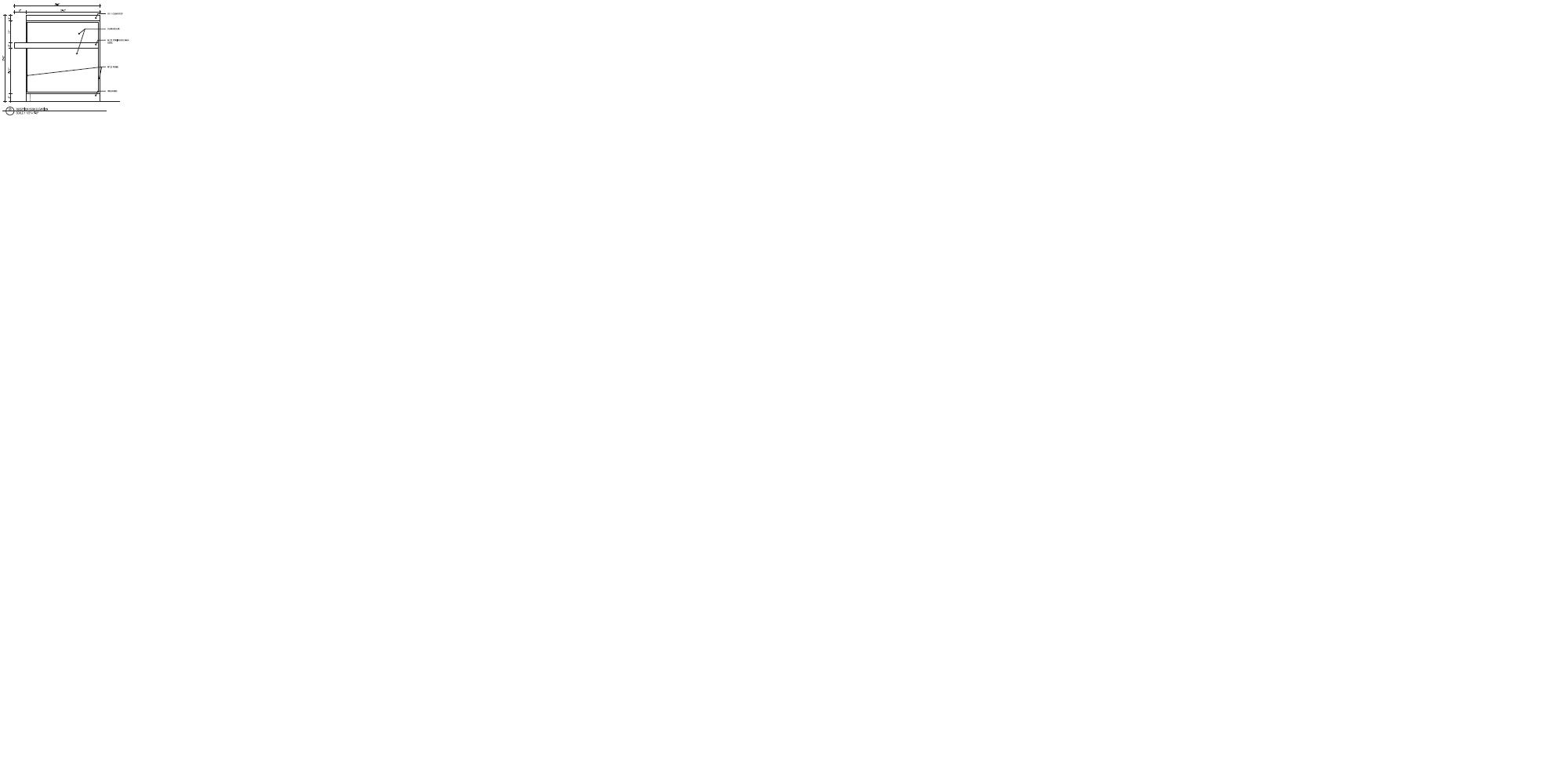

i have a reception desk to build.
attached the details. they want solid walnut slabs book matched as shown surrounded by a nickel trim and in between a transaction counter.
1: worried about expansion.
2: anyone know of a shop that can plane material this wide and glue it up for me?

The images didn't show well enough on my computer. Really small.

Still not big enough or enough details for me to help. You should likely give your area of the country since shipping those slabs across the United States would be expensive and damage would be likely. You can't affix metal across the grain of solid wood. The wood must be able to float.

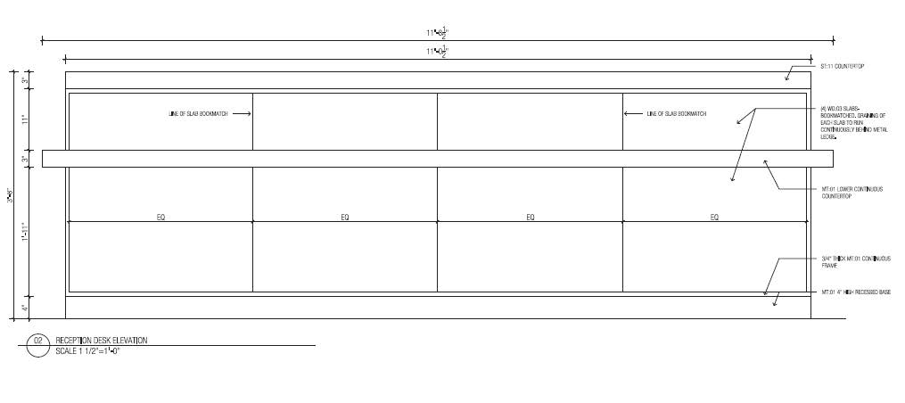

i am figuring how to post a normal size image.
re architect she insists its solid as they are bookmatched solid walnut crotch. a few bucks all in all but worried about expansion.
any further ideas?

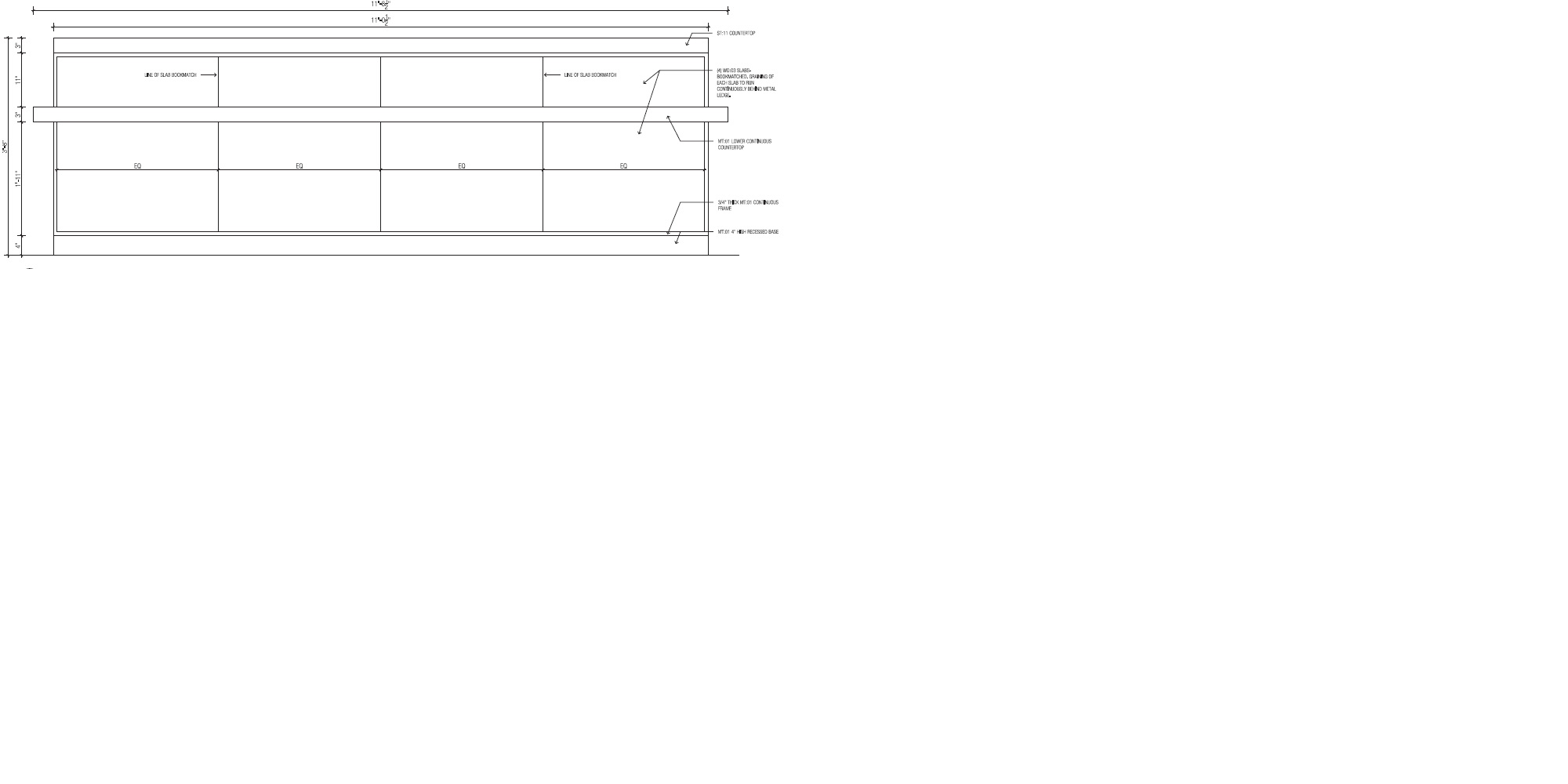

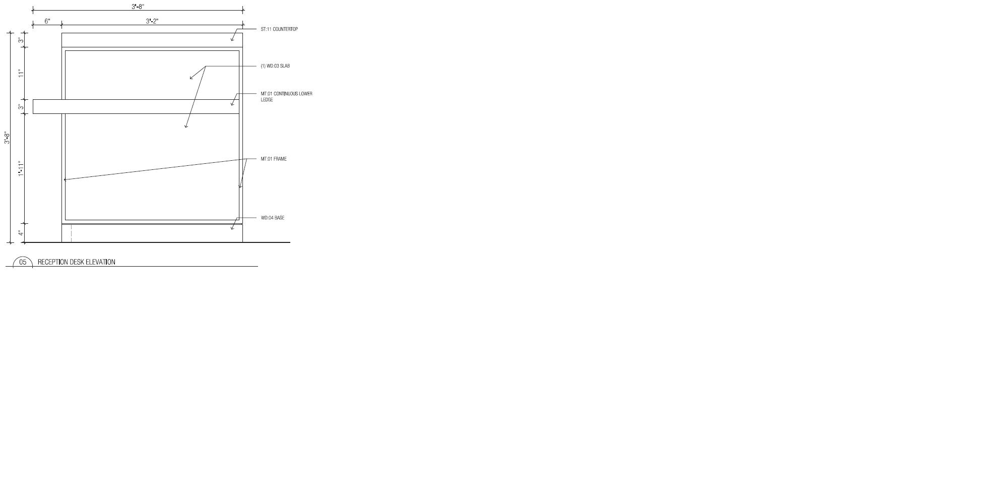

one last time with image :)

"Slab" is the term that is giving everyone problems. It implies solid wood. However, the metal frame, and tight construction, demand veneer on a stable core.
These two things are in direct conflict and will not allow successful construction.
'Bookmatched' can be used to describe positioning of solid wood slabs and it can also be used to describe how crotch veneers are oriented to each other. You need to talk to the designer about terminology and materials.
If you understand this, then you have to communicate the conflict to the architect. If you do not understand this, then you should say so and pass on the job.

i had meeting with arch. she is quite knowledgeable. she insists on solid book matched [at 2 points] of crotch cut walnut solid slabs that i can procure.
the movement in nyc interior is not all that much. i have calculated that .
however am figuring out a way to allow the wood to expand or contract "within" the metal frame. much like a solid table top ,say, screwed to the sub frame with holes larger than the screw.
what do you think?

As far as a solid rim band, no. A channel will work but the thickness of the metal will have to be proud of the face. If flush you would have to rabbit the panel to receive it, but you would have to leave a reveal so the panel can move. You also have to allow foe movement where they are attached. You are not going to win an argument with mother nature. If the architect insists and you are compelled to do it, include a clear disclaimer in your submittals and insist she sign off on it as well as approving the drawings. Architects have a PHD in deflecting blame, and you will be held responsible. Surely you are not going to
build this with out approved drawings.

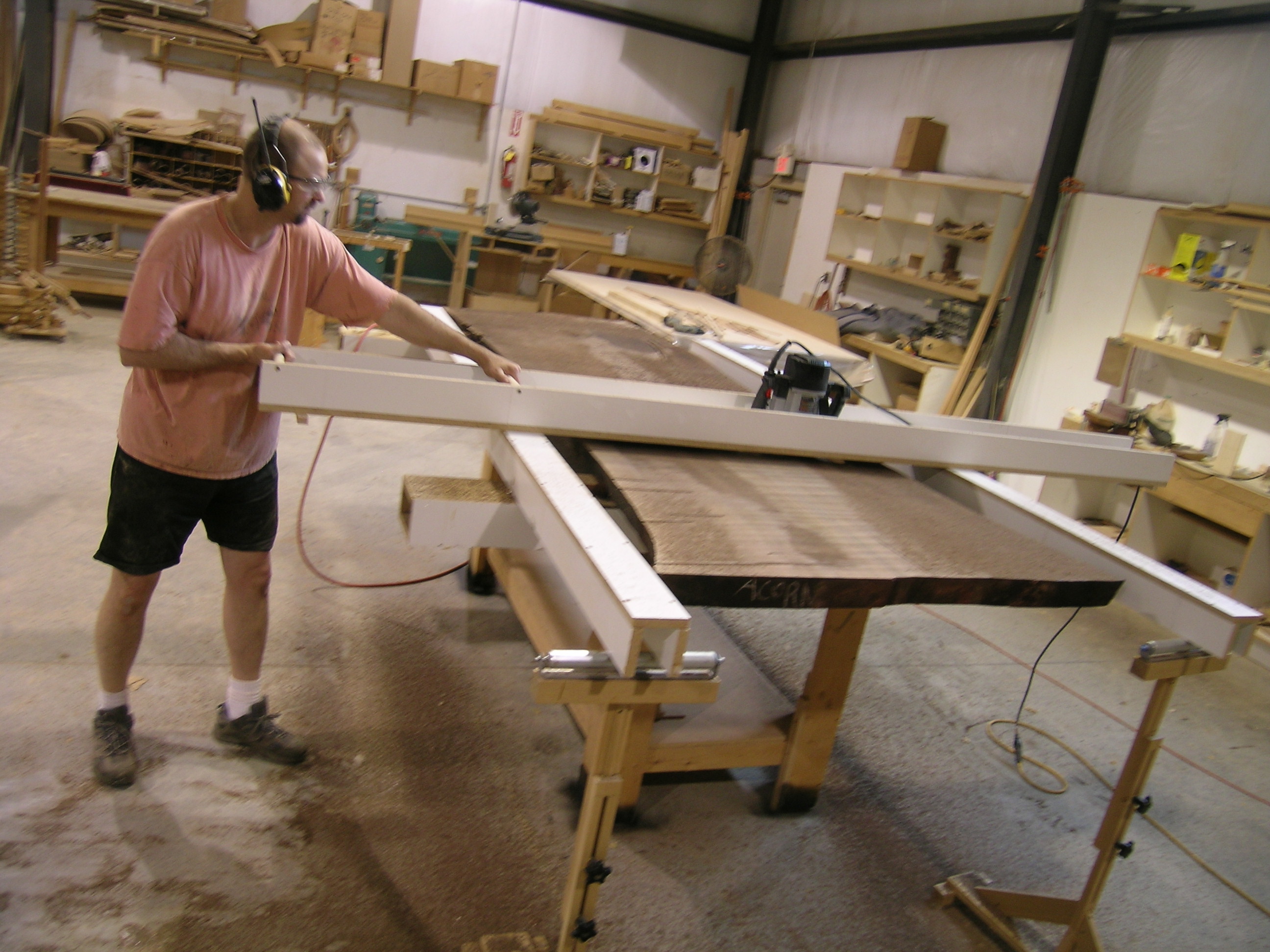

Here is one way to surface a slab.....
4/23/15       #15: reception desk -solid walnut detail ...
k
Having flattened slabs like that a few times with a router sled on parallel beams, I can say it is effective but quite tedious and dusty. I would be looking for a local shop with a CNC router to do the job.
