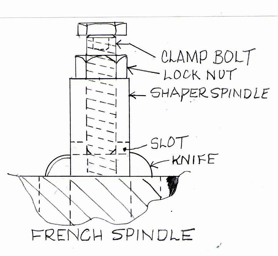

From a Google search:
French Spindle
From the magazine "The Woodworker" May 1922.
"Tracery panels are glue-joined with a square edge rubbed joint, so that the sinkings will not show up unsightly. These panels are then worked out by tracing and are jig-sawed or pieced, afterward being molded on the French Spindle as shown in Fig. 5. This spindle is usually 1/2 or 5/8-in. diameter and after the piercings have been made by a jig saw, the panel is dropped carefully over the head of the spindle, onto the machine table, and moved around until the cut is completed. The panels are then passed along to the carver to be cut in at the corners, pockets, etc."
So this a an adaptation of a shaper with a small spindle and a rub collar. It looks like it would be made by using the spindle as the rub collar.
Fig. 4. Is a special tool used on a drill press to make the radius molding shapes. You can see how the knife is retained with set screws. Similar in concept to the French Spindle, I didn't draw it. My drawing is an interpretation of the poor magazine illustration.
View higher quality, full size image (912 X 839)
