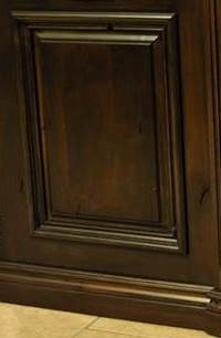

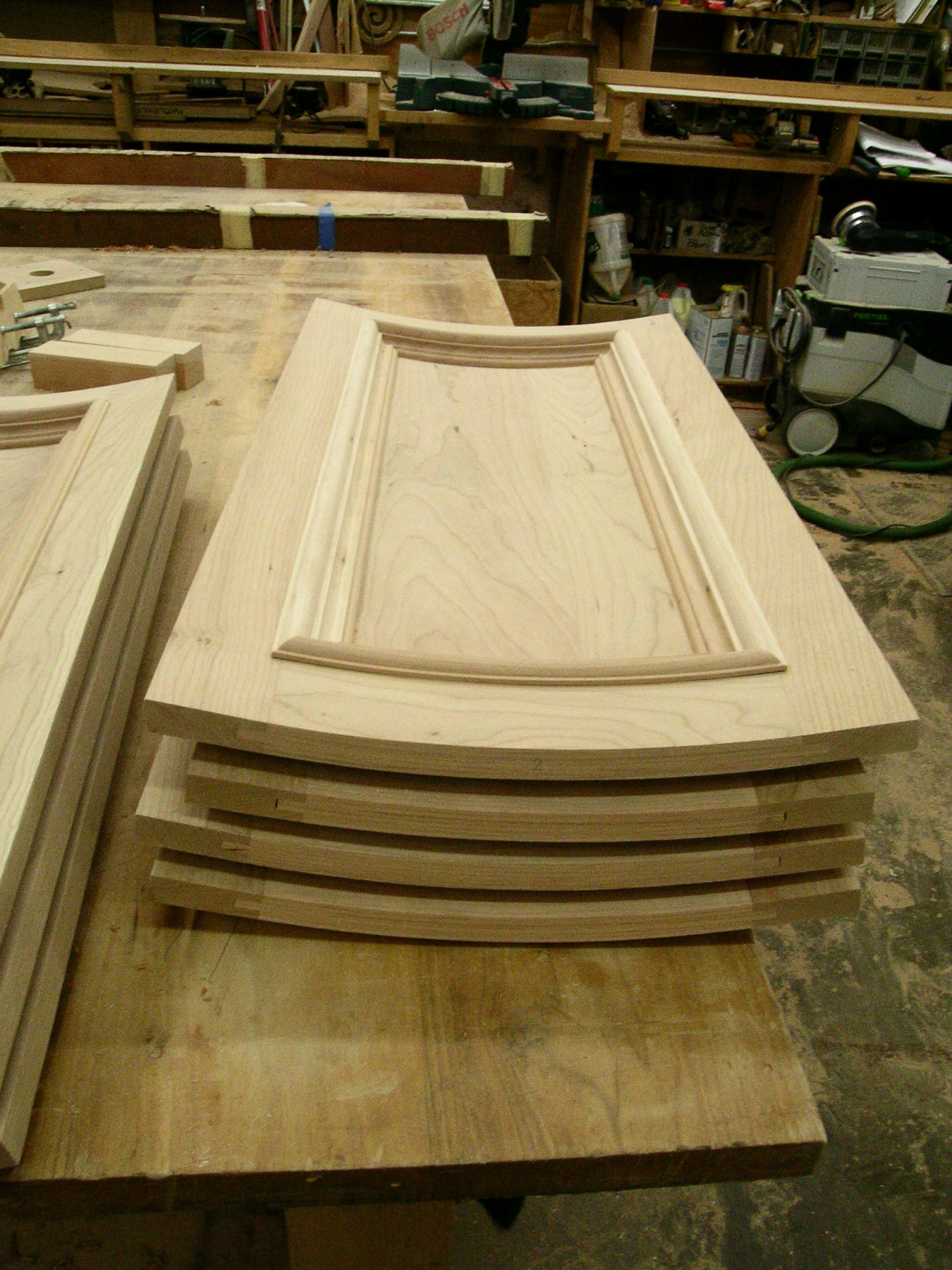

We do this with mortise and tenon stile and rail assemblies that have plows for the raised panels. Assemble everything ,floating the panels if they are solids, and then miter the molding and then ad it to the frame by nailing. Do nail to the panel.
We also have done it by molding a plow into the panel mold, mitering it around the raised panel, reinforcing the miters, and then adding that into the stile and rail assemblies.

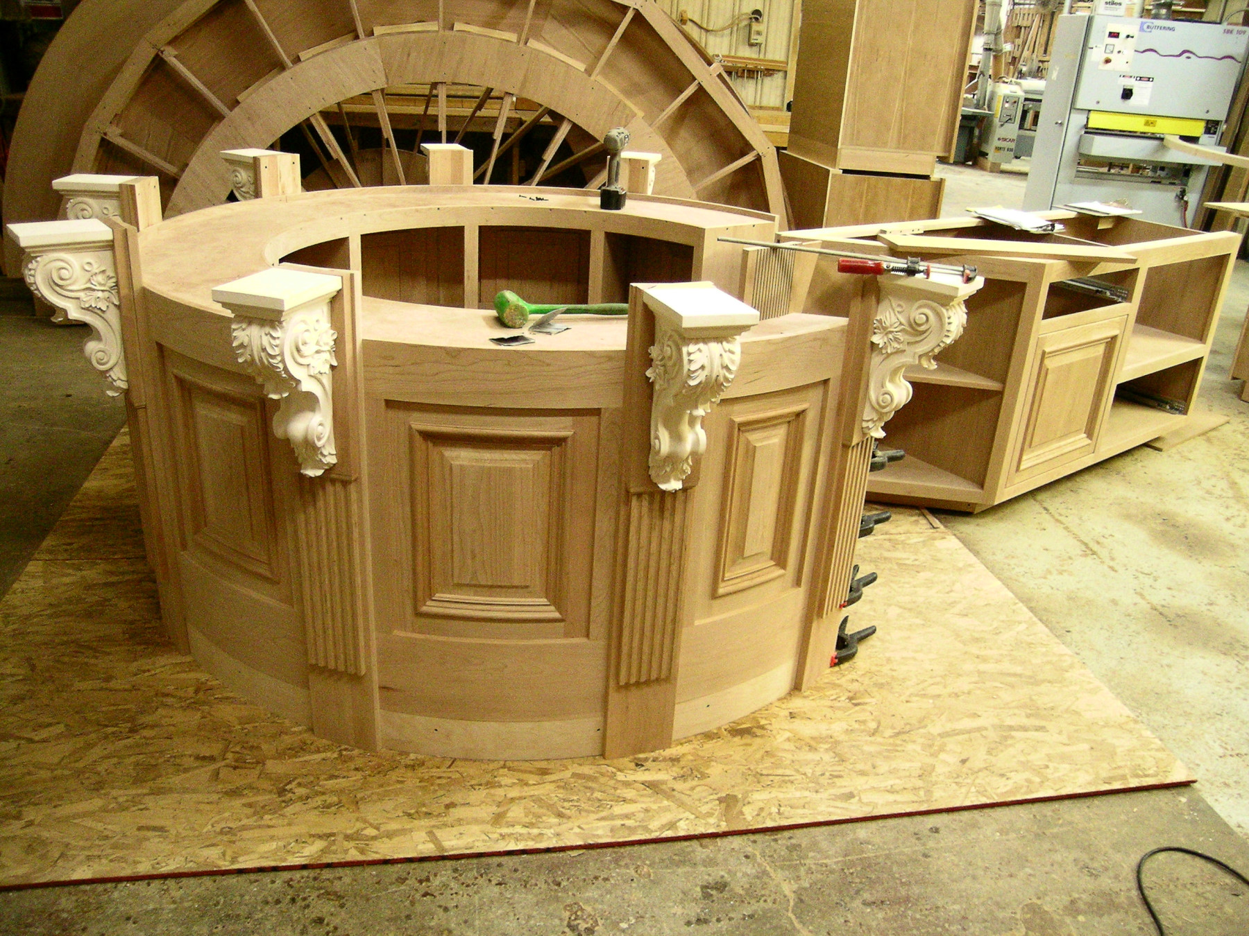

Trevor - Let me correct myself.
It should read "Do not nail...." Never a good idea to nail/glue solid wood panels floating in a frame.
I like to assemble the mitered molding frame with glue and pins, and even screws (after glue has set) to reinforce the miter before it goes into the flat frame. Miters will not stay tight over the years - they are often the first thing that lets go over time. We also reinforce with splines. Some folks use a Hoffman dovetail key - that is a great way to keep miter where you want them.
I am a poor typist, and when I multi-task, it gets worse. Then I forgot to proof read..... Thanks for the compliment. I realized I don't have any decent photos of that work that is flat. Those panels were fun - for a circular bar.
